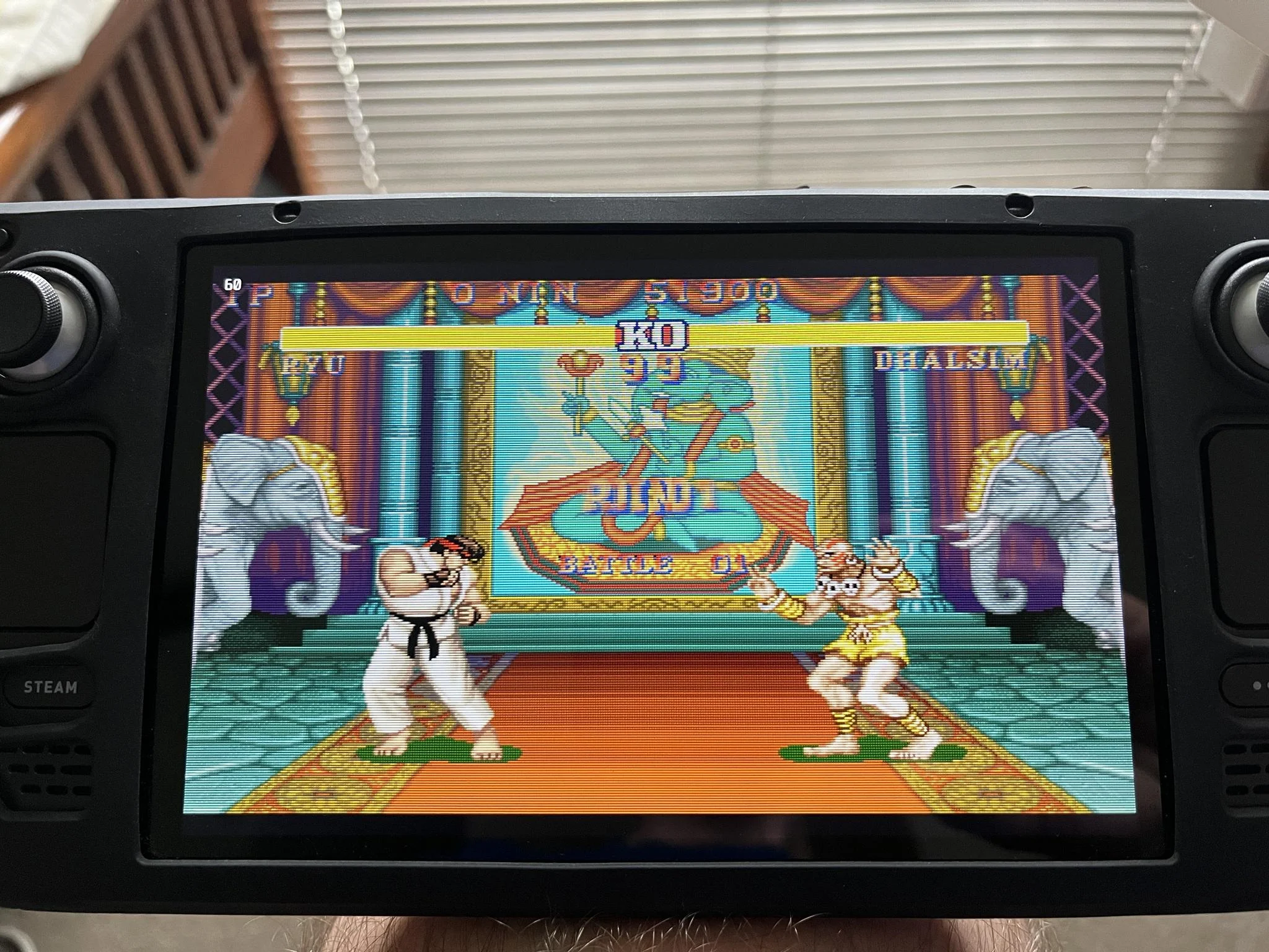

Photos dont do it much justice, but here's one anyway. Subtle without being distracting
Full sized pic
