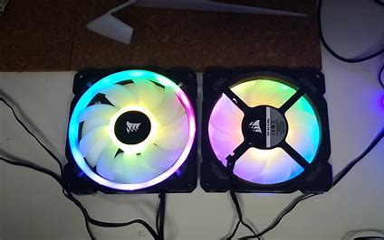

It's time to buy a new case, and I quite fancy one of the new Antec C8s, or the upcoming Phantek Evolv. But when I see them on show they all have those pretty RGB fans and - and here's the point - the lights all point into the case, even though of necessity some fans must suck in and some must blow out. Initially I thought the lights must be on both sides of the fan but then discovered this isn't so. So they're either on the intake side or on the outflow side. So how can they get their fans so that all the lights point inwards?

You can get reverse options
So you always see the "pretty" side of the fan
That would be the one on the left in dave28 photo
Reversed option fans mean you don't see
The hub/motor support legs/struts
They just reversed the pitch of the blades
Though does mean you have to decide what
Will be an intake
And which exhaust/reverse before buying
Look at phanteks d30 as an example
If you've looked at Phanteks then it's the D30 that have a normal and reverse version, out of all the RGB fans I've had over the years they were the best as no software required and you can daisy chain the rgb connectors, so 6+ fans off one case or motherboard header.
