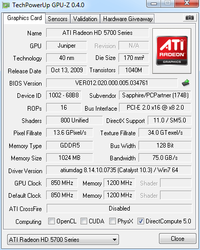

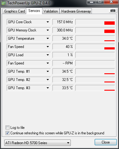

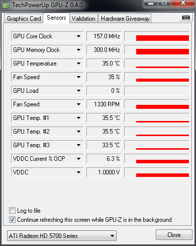

look @ picture 1 and 4 why is there a big difference in readings and no fan reading @ all on picture 4 :S
These readings are with crossfire and without crossfire

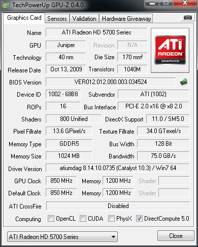

here,s a better example is this right for both cards ? picture 1 is the new card saphire picture 2 His old card
cheers skotish
You've got different cards from the looks of things.
One carries more sensors than another, one of the cards is probably a Non Reference board with no voltage adjustment.
Can you post up links to said cards? (Where you bought them from..)
Right i understand now cheers m8
they are different but same bios /memory/speed ?
