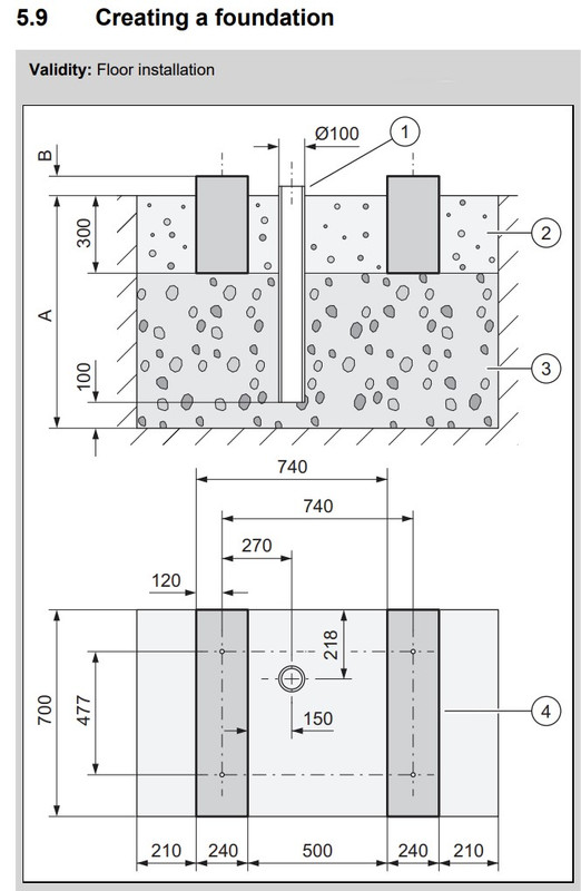

Making progress on the heat pump install, weather was rather wet yesterday so I made up the shuttering frame for casting the strip foundations.
Today I got the condensate drain in, and the sub base in and tamped down.
Frame fits, and sub base at the correct level, all ready for concreting next weekend, weather permitting.
The frames been removed for the week so the rain doesn't damage it (its only cheap furniture board), but next weekend I'll fit it in position, and make sure it's absolutely dead level prior to filling the two outer sections with concrete - glad I have a mixer!
Good work, quite possibly a bit overkill to hold a 100kg heat pump.
That said mine is not much different, they just used pre-formed concrete blocks on some compacted type 2 to hold the heat pump. The type 2 is covered with some shingle to allow the water to drain away.
I've pretty much followed the instructions from Vaillants installer manual, I just didn't dig the complete hole to 700mm deep (that just seemed crazy), just the area where the condensate drain is.
Octopus are doing mine aswell so have just said to prepare the area - though haven't really elaborated on what they want. Its just grass right now so I guess I'll just dig that out or something. :p
My installer just sent a drawing of a plain slab 1200 x 900, it didn't even show where the drainage went for the condensate, just said it was required. It was also not clear what thickness they wanted, as it gave two measurement's, 150mm and 200mm, presumably one was concrete, the other the sub base.
So I decided that the strip foundations that Vaillant specify would look better, so that's what I'm doing.
If the soak away doesn’t work, you could just whack it on a drip tray and go into that downpipe.
That said, it’s next to a lawn, it’s not like there is any danger of you creating a huge ice rink on a patio.
Digging down to 700mm is ridiculous!
Its worst than that, if you are in an area with a ground frost, you're supposed to dig the entire hole down to a minimum of a 1 meter, so that would be 1400 x 700 to a depth of at least 1000mm, then in fill it with sub base material to 300mm below the surface :cry:
Somebody at Valliant needs to revise the drawings/instructions, as they seem way OTT, but I suppose they are for worst case scenario's.
The bit I dug down to 700mm was really easy, a few spades, I actually didn't intend to go to 700mm, I put some gravel in, then bedded the down pipe in, and surround with more gravel, like a vertical french drain.
The soakaway will be fine. Without it, on a cold winters day, not that it gets that cold here anymore (I remember when the sea froze locally many years ago), but in some areas you would get a build up of of ice, not really a problem where mines located, but given a long enough cold spell it could build up substantially.
