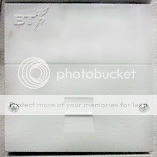

To verify that you are getting the best from your line plug your router, and only your router, directly into the BT test socket and post the stats again. To access the test socket you must remove the bottom half of the BT wall socket.
I tried removing the bottom half of the wall socket, no success. I unscrewed it but it would not go off... I'm reluctant to try harder as it's a rent property...
Is there another way ?
The main idea behind removing the front panel was to remove all telephone devices and extensions from the line to test on an as clean a line as possible to determine if anything you have attached is causing lower speed. I have seen, on here, some people see quite large differences and speed just by working out what was dragging the system down.
So if you can remove all hard wired extensions, all couplers, adaptors and stuff from the socket and just test the router direct. Do the best you can.
If your BT socket looks this this...
..then you can remove the bottom just by removing the two screws. It may need half a tug to separate the two parts from each other. It is designed to separate.
If it looks like this...
..then you can't and you just have to plug straight in. The problem is that extensions can be wired into the socket directly and could be causing attenuation to your line but there's not much you can do about that without fiddling with stuff you might not understand.
