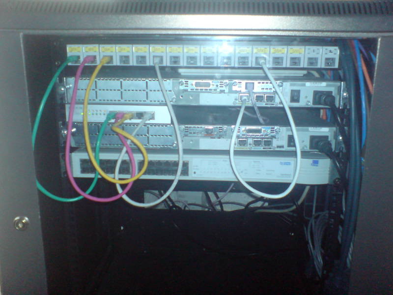

If you look at my setup I have one adsl wic in mine.
