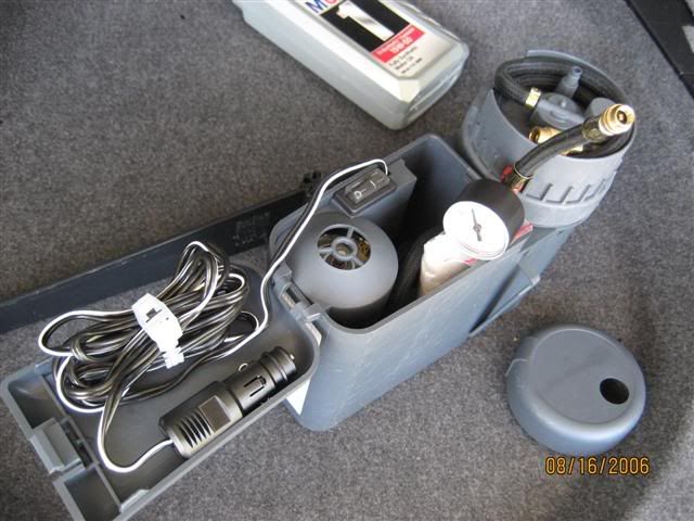

Without wanting to be too pedantic, I'm not sure that's the ///M Mobility kit, I think it's the "normal" BMW mobility kit.
They may have changed it for the latest M3 but the ///M Mobility kit from the E46 M3 looked like this:
Having used mine a couple of times they do work well as a "get home" option, unless you buckle your wheel then you're stuffed!
