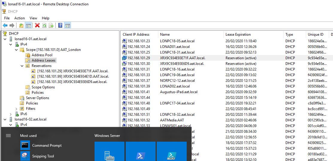

Also you should be able to see if a machine is on DHCP or fixed according to the lease in DHCP, take a look at the image below, the highlighted line is a reservation on a fixed address, if you don't reserve the fixed addresses in the same range you will end up with a lot of bad addresses in DHCP (perhaps this is the problem).
Edit this is bad advice:
If you just set a reservation on the bad address and delete the lease you should get whatever device is on that fixed address claim the reservation. Actually scrap that I think you need the unique ID (mac address) to make a reservation in the first place.
But you can remove the fixed address from the scope of dhcp and then query dns with nslookup to see what is on that address, but really rather than scripting it on every machine this should be dealt with in group policy because stuff like this is exactly what group policy is there for.
