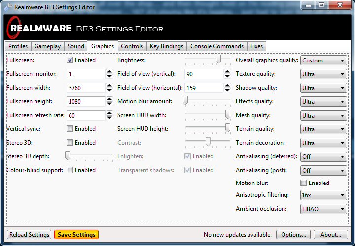

Hi,
Sorry on a bit of a side note, i run eyefinity on BF3, however i always think the sides zoom in to much, does the FOV (Horizontal) help with that? (i.e push the image back a bit so its more correct)
Some games just seem better at that part than BF3
Also where do you get that prgram,
Many Thnaks

@pugheaven
Have MSI afterbuner running OSD with
GPU clocks,temps for all GPUs and Vram showing, don't bother with mem clocks.
If you see 8GB of Vram being used then you have overdone it.
If you see any GPU clocks drop ingame then its most likely overheating and throttling and it becomes a stuttery mess.
