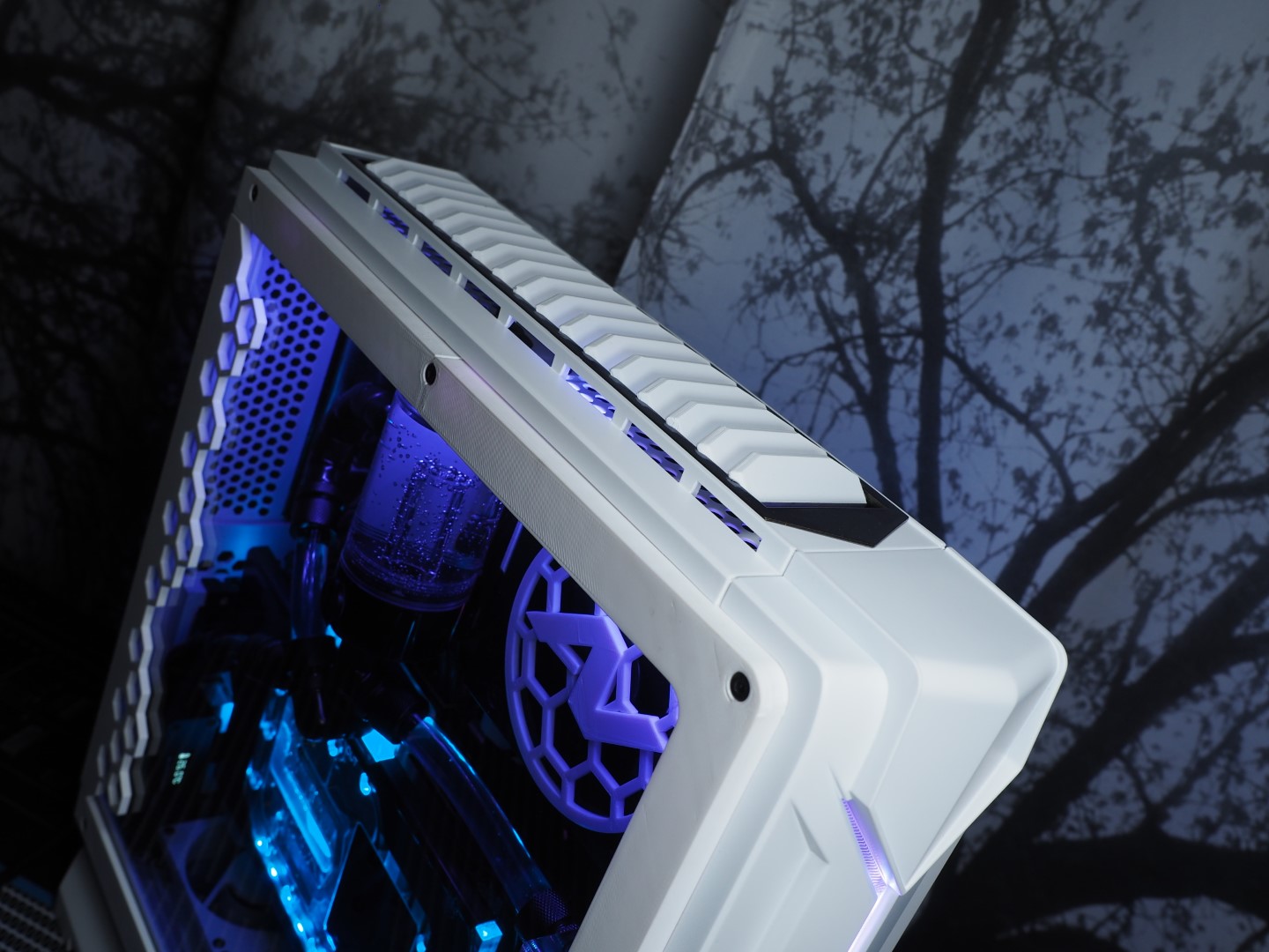

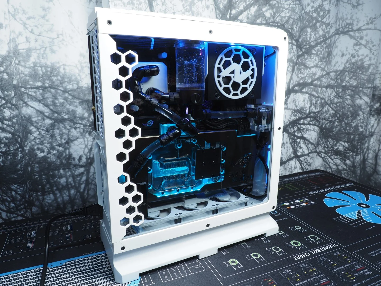

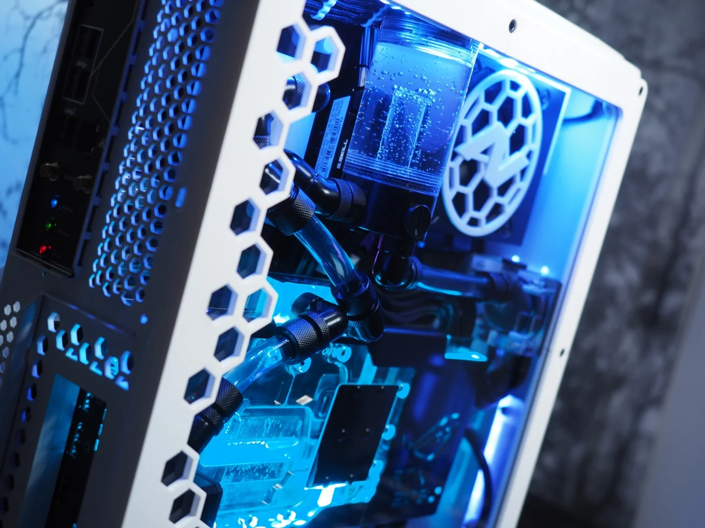

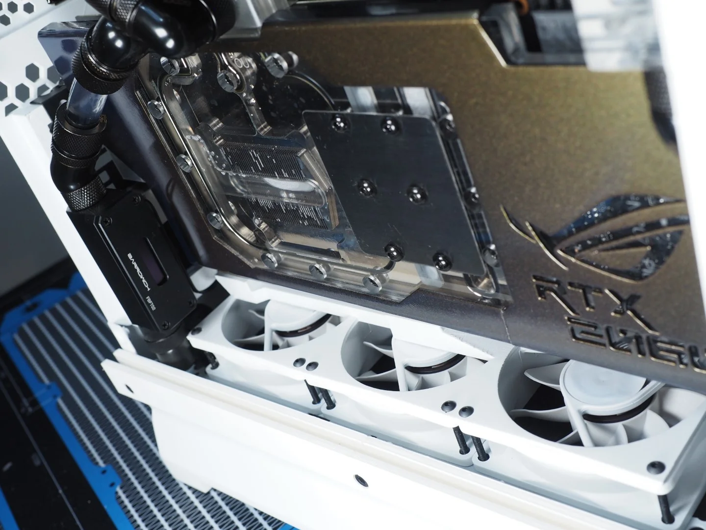

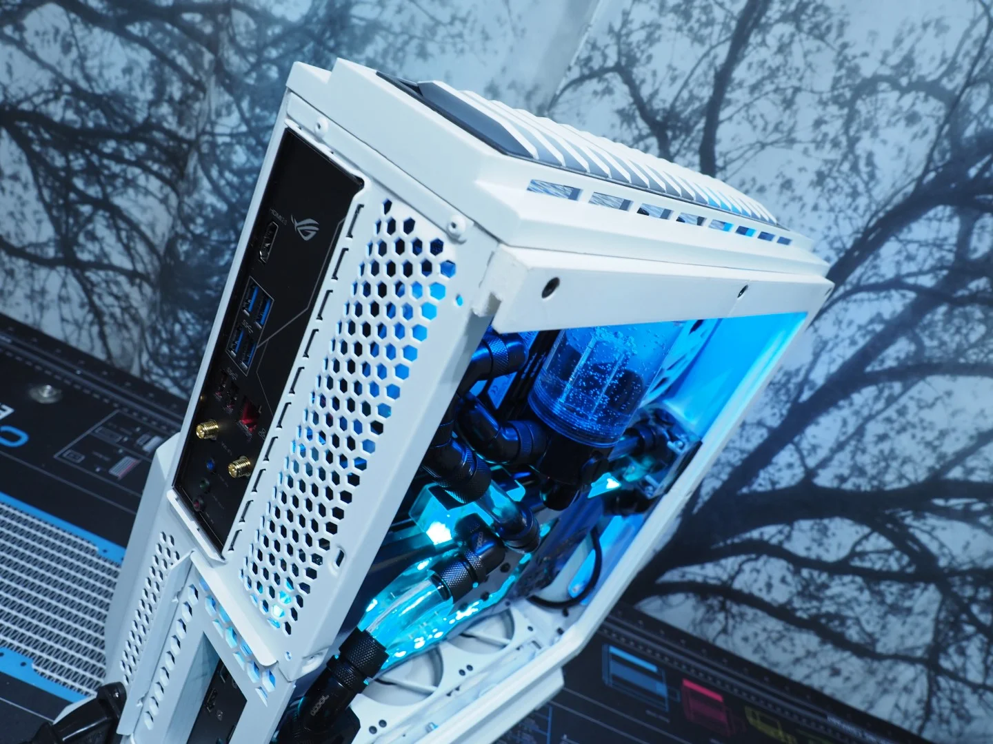

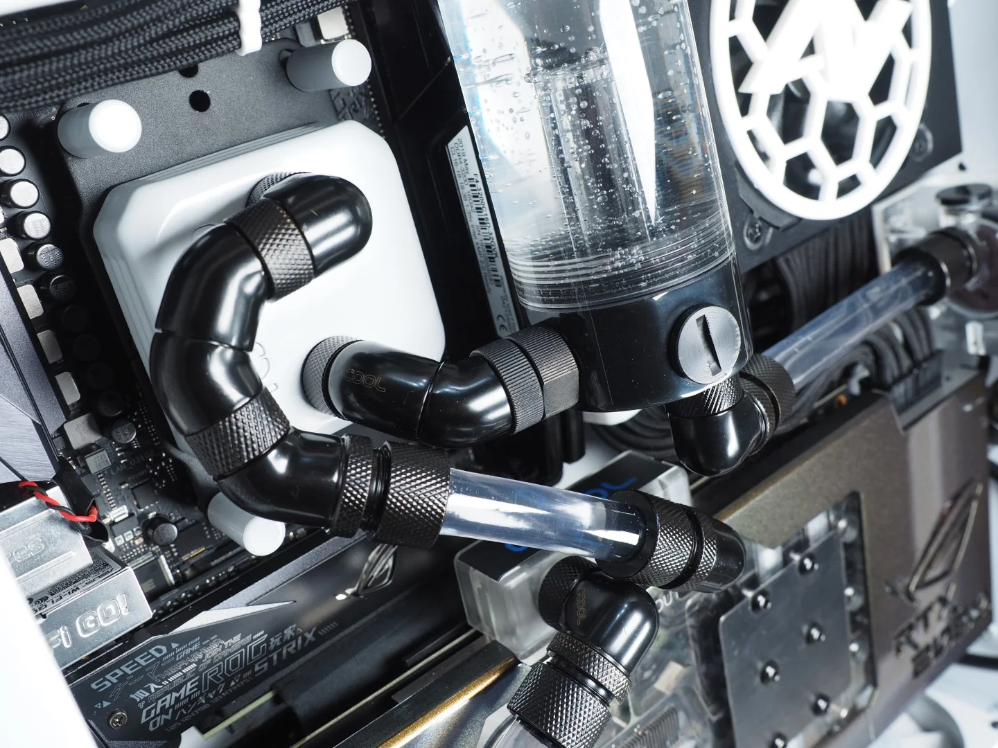

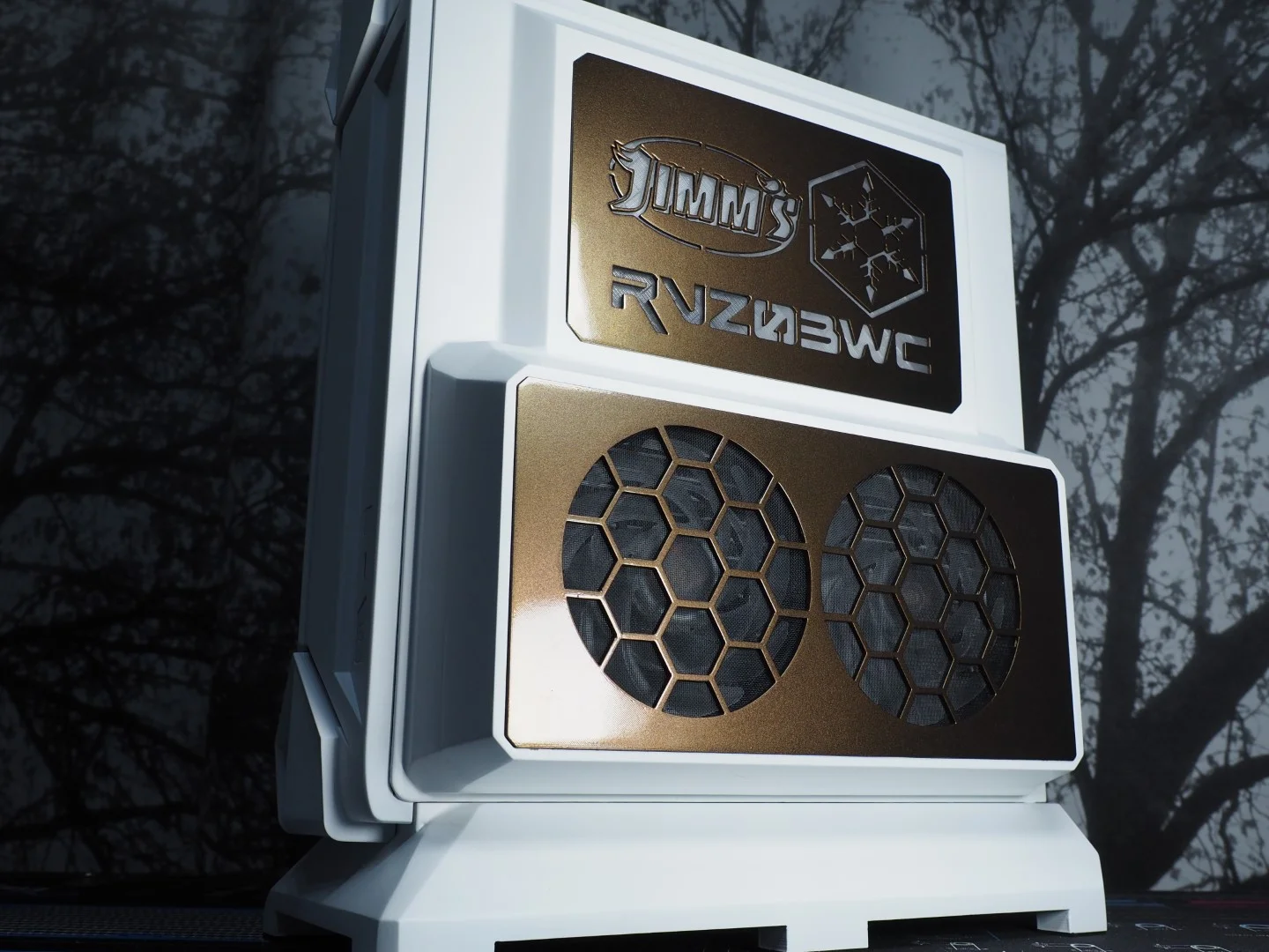

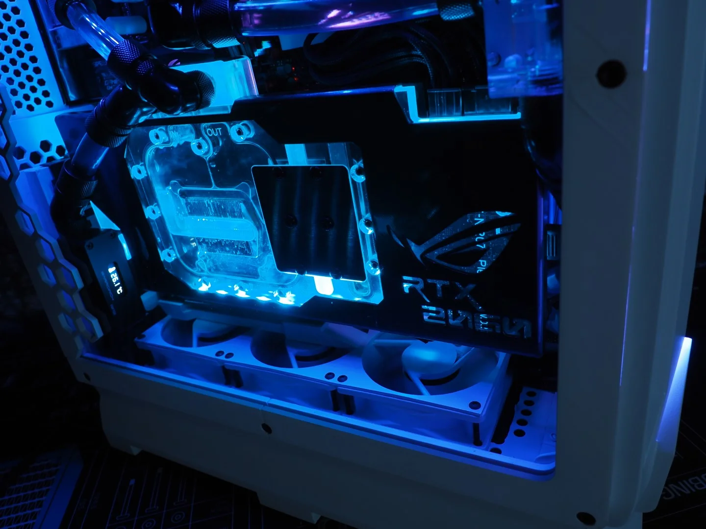

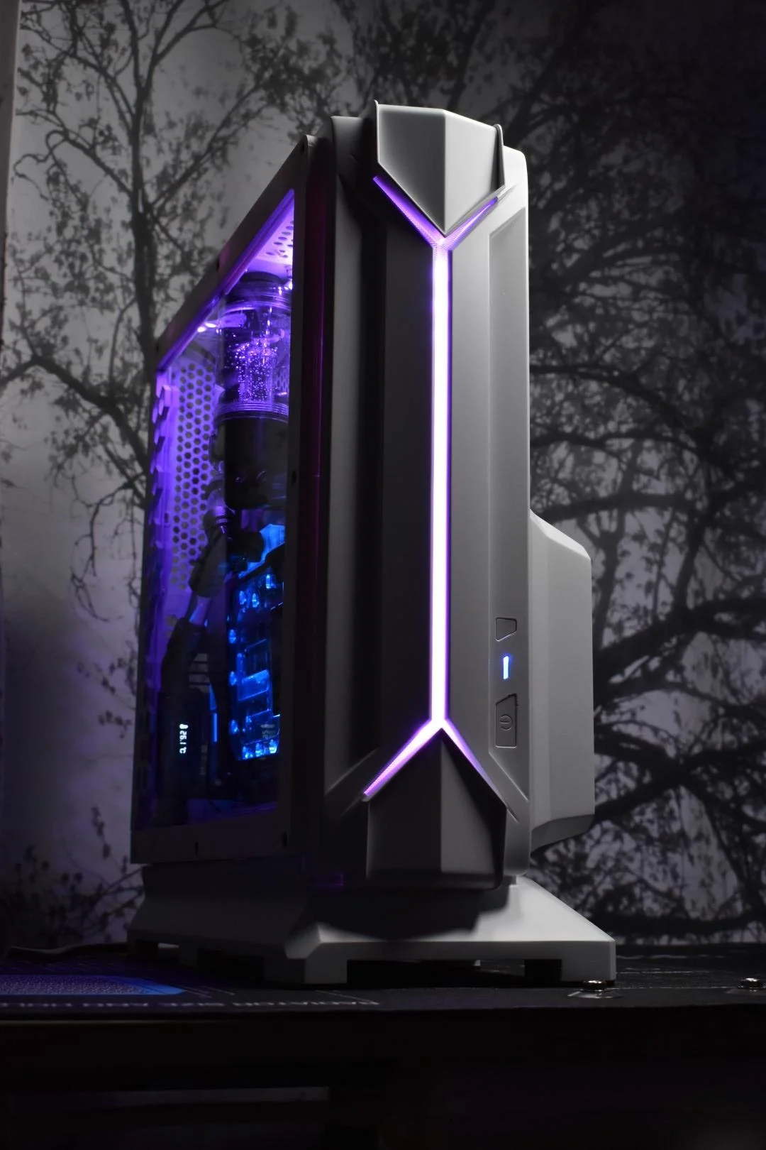

Hello,
I dont have project log for this build so i post my final pics and final assembly video.
This is based on Silverstone RVZ03 Case with lots of 3D printed parts.
Here is specs:
Cpu: AMD Ryzen 5 2600
MB: Asus ROG Strix X470-I Gaming
Memory: G.Skill 32GB Ripjaws V 3200MHz
GPU: Asus RTX 2060 ROG Strix
PSU: Silverstone SX650-G
Case: Silverstone RVZ03
Cooling:
2 x 120mm FW124-ARGB and 3 x 80mm FW81 From Silverstone
240mm Barrow rad ja 3x80mm Alphacool rad
Cpu Block: Alphacool XPX
Gpu Block: Alphacool Eisblock GPX-N
Res: Alphacool Cape Corp HF 10
Pump: Alphacool DC-LT 2600
Alphacool fittings
Just Googled the Silverstone RVZ03, you really did a lot of good effort to customise yours to make it original. I think it looks different and more unusual than a classic case style, but I also like it at the same time, looks really nice, clean and super slim, definitely looks like a cyberpunk style case. Nice and small too for how much you've fit in.
@AVCaseMods
looking slick there ! execution is damn good!
How you finding the Slim 120mm? wasn't any ARGB at the time when I requested so using the Two Stock black ones on XSPC TX slimm 20mm 240rad .
I made the mistake of asking for 92mm fans instead of 80mm for the bottom intake ;(
Super jealous of the Vertical mount linked to triple 80mm set up :D
recommend switching the 2600 rpm pump to 3600rpm version. Louder but head pressure is a lot greater along with flow rate
Thanks guys:) Those fans are FW124-ARGB. For now i use that pump but if i overclock the system i think i chance that to the high rpm model.
I am going to put that vertical mount design to thingiverse if anybody wants to 3d print it.

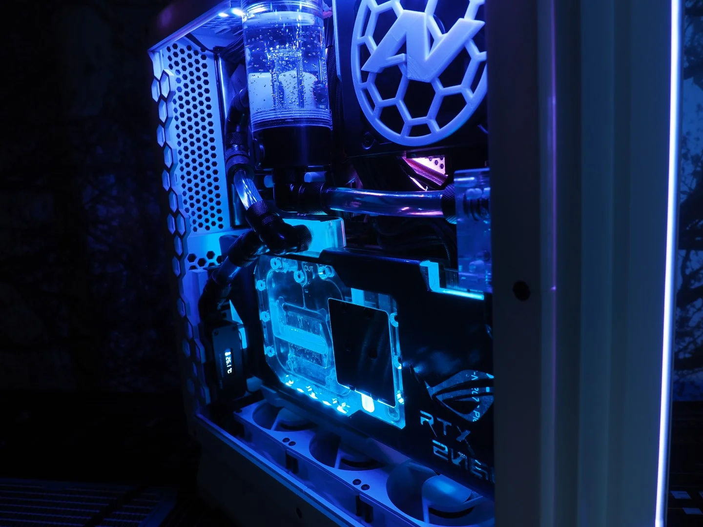

I really like the sensor that you have in the water path. Tempted by one of those - if I have some spare budget at the end of my build (which seems unlikely)

also, how think is the Alphacool block for the Strix (terminal part and main body part) ?
wanting to see if i can house another 240/20.5 rad under the CPU one and watercool the GPU . Seems Phateks is 19mm thick but not sure at which point along with EK being 22.5m max
