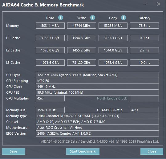

X470 Taichi Ultimate with AGESA ComboPI 1.0.0.1
4x8GB 3200 (B-die)
Timings - 14-13-13-13-26-1T
DRAM voltage - 1.35
Mobo - Crosshair Hero VII
Bios - 2406 AMD AGESA Combo-AM4 1.0.0.2
Ran Prime95 over night no issues apart from when I power off the machine and then I believe the DRAM voltage resets to 1.2 volts and I have to setup the voltage again and reload my profile via the bios.

4x8GB 3200 (B-die)
DRAM voltage - 1.35
Did you use the Dram Calculator or just set DOCP?
Did you adjust the FLCK?
DOCP doesn't work for me unfortunately so I had to setup things manually, I had the same timings setup on my 1800x so just ported across all the timing values (not using DRAM calc just trial and error) and in the words of Jurgen Kloop "Boom" they worked without a hitch. I've not had time to play with the FLCK on these timings but I did mess around overclocking the ram to 3600 and setting the flck to 1800mhz I've manually tweaked these timings only slightly so they are a bit loose at the moment. When I get back from work I'll probably tighten them up a bit more:
