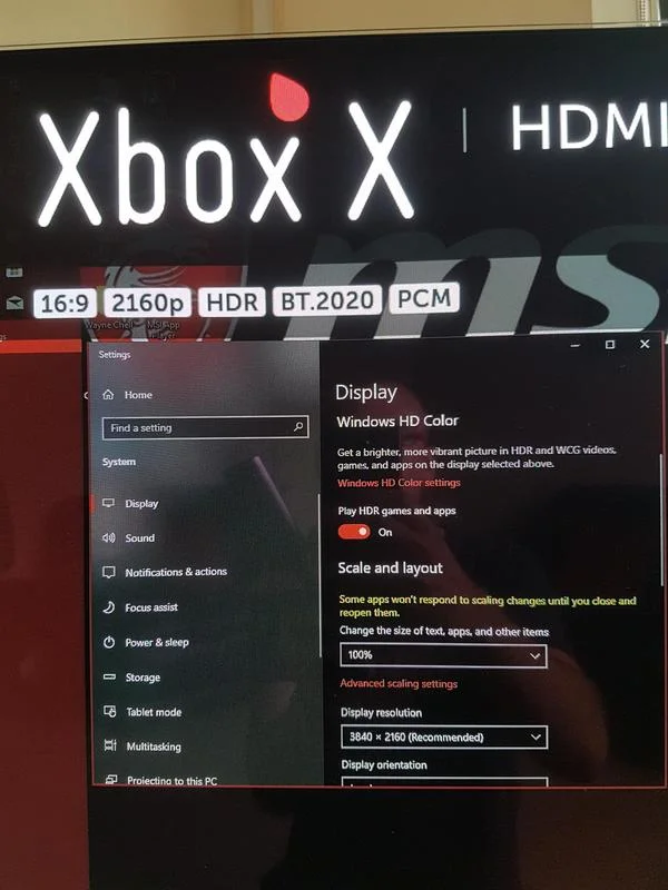

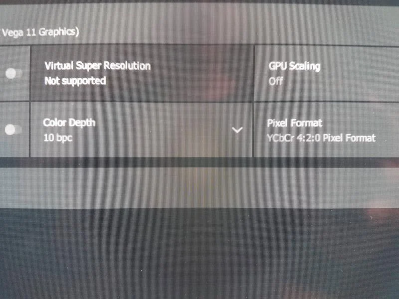

Photos to answer my question that the Ryzen can do 4k/60 HDR :D

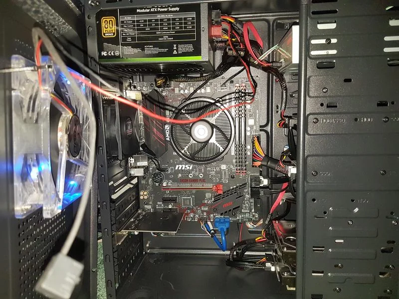

Here's the new £380 rig as already had a few drives. I's not a top end £2k games rig, but with a £200 GPU next month hopefully it will be better than a Xbox X (which I can then sell), plus each photo will no longer take 10 seconds to load in Lightroom -the main reason to upgrade. Trying to figure out what GPU will do the job, don't fancy Nvidia as their drivers have a fundamental fault on Windows & Linux where they can't remember the brightness setting after a reboot.
Its a Ryzen5 2400G APU (thanks humbug), 16GB 3200Mhz Corsair RAM on a MSI B450 Gaming Plus (thanks humbug) micro ATX mobo.
The midi tower is quite petit & its running 30c at stock -YAY. No M.2 yet so gone RAID0 on 2x SSD & 2x 1TB.
The keen eyed amongst you will notice a PCI x4 card which is an existing RE200 USB3 card I had. Also the DVDRom is not connected, 4 SATA ports ain't enough D'oh! :/
Getting some fast speeds even on the old mechanical drives like over 200MB/sec write but a good advantage of RAID0 is not total speed but access.
The extended front USB3 on the tower is running at USB3 speed but all the rear ports are only running at USB2 speed :/
