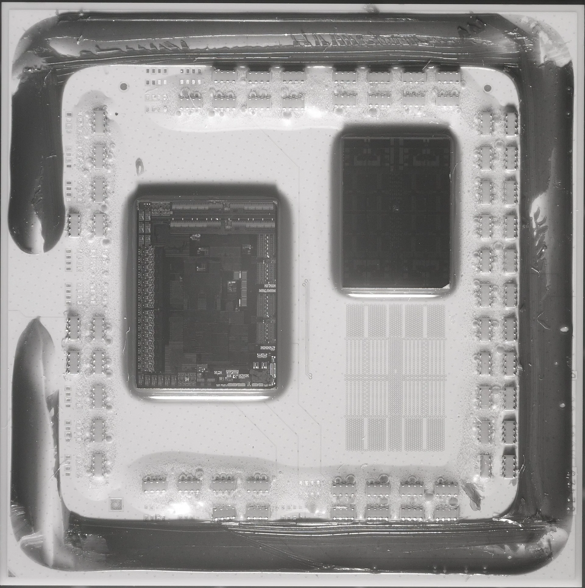

As for the paste, you need to make sure you have spread it across the 3600 surface, as the chips is not at the centers but to the sides. (the cores are the smaller die to the right top side).

The default cooler paste wasn't enough to fill my 3600's wonky concave base. I needed to put proper paste on it to get rid of the whine.
