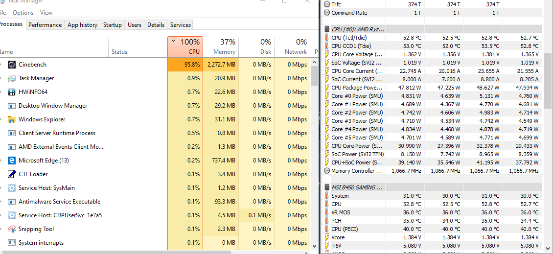

Temps are all fine when running Cinebench and stress tests on both Mobo and CPU - But the CPU is pulling low wattage right?:
It could be the CPU not getting enough volts and not boosting, I would reset the BIOS to default settings and run CineBench again. Also check the CPU 8 pin is plugged in. I would expect that CPU to be @ 75C+ running Cinebench.
you rams on the warm side to be fair i read here that ddr4 temps shouldnt hit more than 75 degrees plase correct me if wrong, i have 3600mhz quad kit which are all sat next to each other on my x570 and max teps i see are in the low 40's under load, my idle temps are in the low 30's, from all the screen shots from hwinfo everything looks to be in check, but as you say the cpu package power is a little low at 48w but we are on 7nm so power draw is going to be signifigantly lower than 2nd gen ryzen or anything from intel, does your board have a 8pin cpu power connector or a 4 pin?

edit: somethings up with your cpu it should pull around 150w under sustained load and hit around 4ghz average on all cores, looking above in the post your cpu does it around 4ghz but at 48w somethings not right, also having edge open, 13 tabs will impact performance quite a bit look at taskmanager above, edge is taking 737mb of avalible ram, that kind of use will shave a few hundread points off a cinebench run
