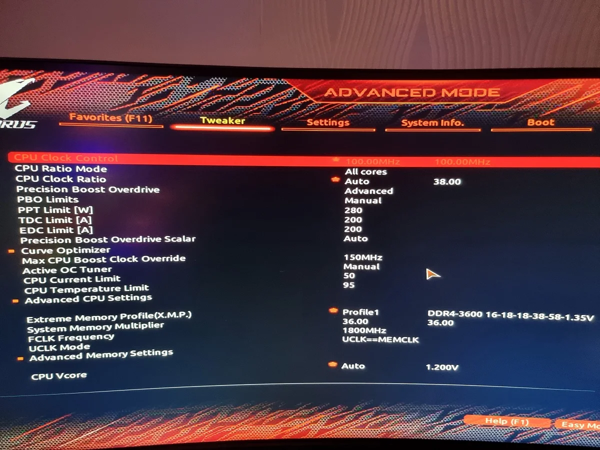

I have my PBO settings set to 280, 200, 200. That's just to start, better more than not enough, I will fine tune them a bit further down the line as hwinfo shows you what it's using out of that lot, I'll run an extreme benchmark like IBT and then just add a tiny bit more to what hwinfo is reporting being used on the PPT, EDC, etc

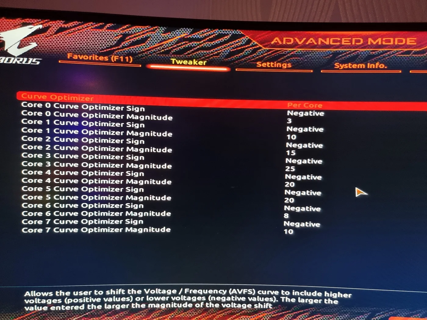

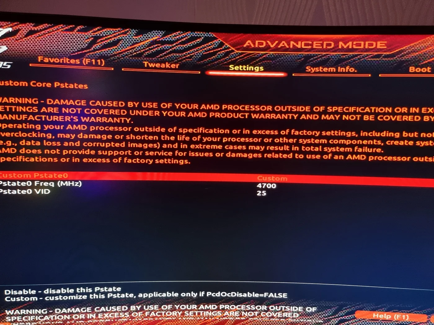

I finally cracked it in the end, 2 full days of testing, curve optimizer is a nightmare to do per core, but got there in the end, obviously core 0 is my best core, so it wont optimizer much more than it is already, RAM is on XMP with tweaked timings, and then I have an all core overclock of 4.7ghz above 50amps and +150mhz on the PBO side of things, so 5ghz max CPU on light loads.
