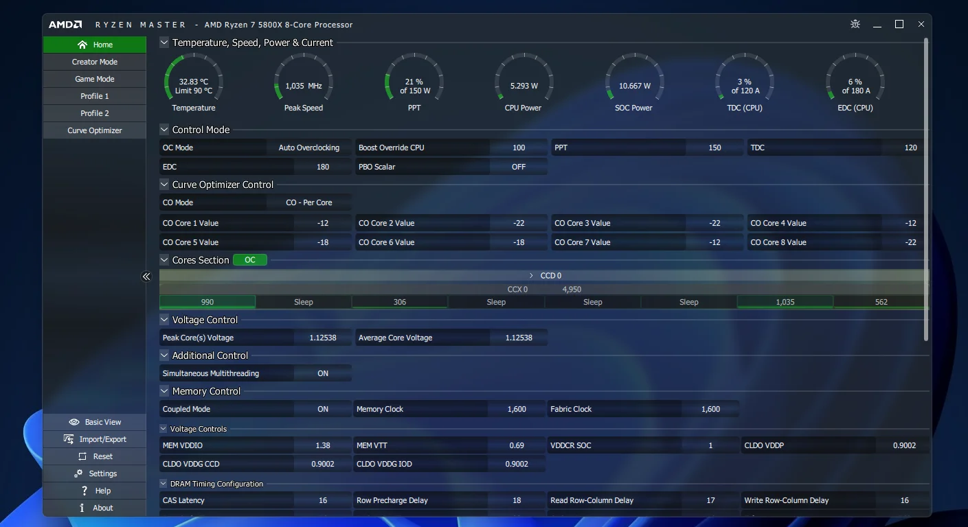

I do see this posted every so often, i don't know but its not normal.
When my cores are not sleeping they clock as low as 239Mhz, i have a screen cap here with one at 306Mhz.
I see you are using Ryzen Master to tune your CPU.
Is this the same as using the BIOS ?
