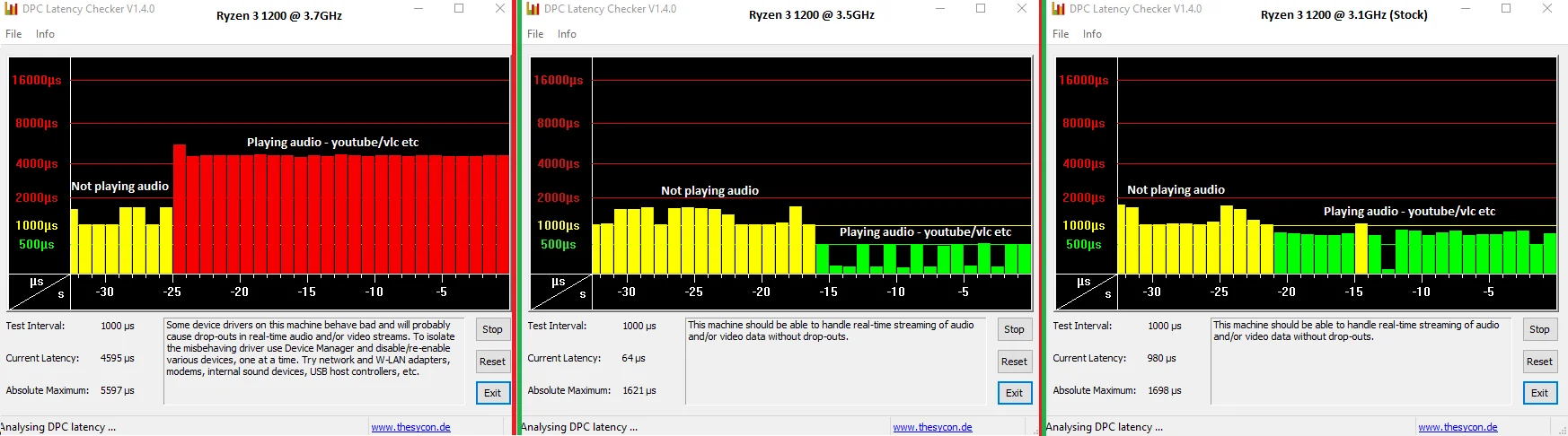

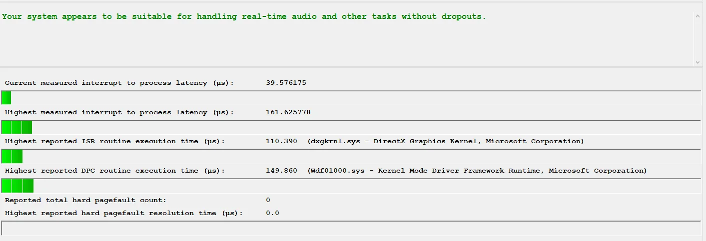

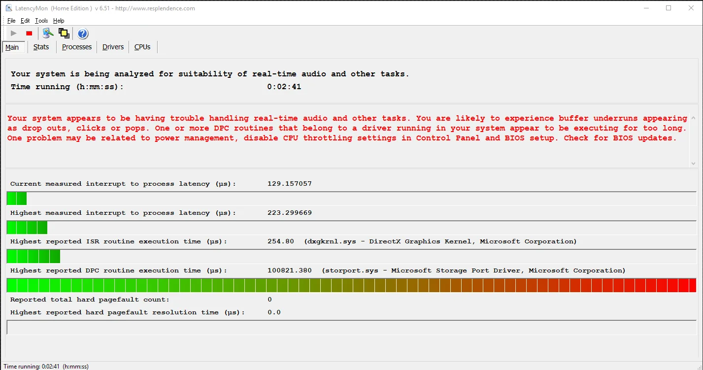

However, I think I found out the root of the issue, but not how to fix it - it turns out that it's only audio/video stuttering when my Ryzen is overclocked, checked with DPC Latency Checker & LatencyMon.
Can you have a look at these and let me know what you think:
P.S: The latency went into the red on 3.5GHz as well, just forgot to capture it.

Yeah, it's stable and temps are in their normal ranges, nothing worth worrying. I just did a run through the device manager, because LatencyMon noted that the "storport.sys" is the faulty driver, so here's what I did in case anyone else has that issue:
1. Open device manager.
2. Open IDE ATA/ATAPI controllers
3. There was an AMD SATA Controller, right click and "Scan for hardware changes", that triggered the micro-stutter.
4. Uninstalled the AMD SATA Controller driver, now sticking with the "Standard SATA AHCI Controller" by Windows I suppose, no issues so far, latency looks fine.
