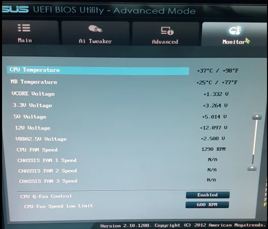

when I get home from work I will look at the voltages in bios and let you know what they come up as. Is there anything else in the bios that I could write down and post to provide more information/solutions?
hi, quick update.
I went into my bios to take a picture of my temps and voltage, which ill upload here.
I also noticed that, my ram had gone back to 1333mhz on its own, after I changed it to 1600mhz. Not sure if this means anything.
Anyway heres the picture.
