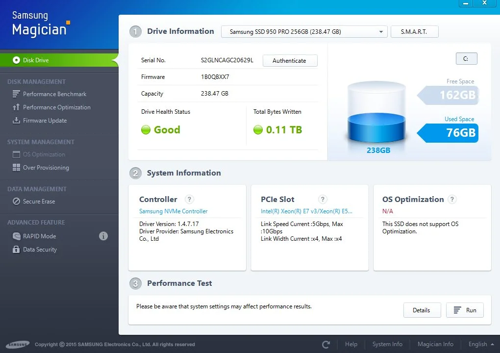

Anyone any idea why this drive is running 5Gbps? :confused:
I managed to get it running at 10Gbps by setting BIOS defaults. I had run autotune previously for a quick OC but obviously some setting there has messed the M.2 speed up.
Is 10Gbps the max this drive does? I thought it was 32Gbps?
Also, the read and write speeds look low?

Ive got the AHCI version of the 256GB. Which now gives me 2249/1245 in crystal disk mark.
But. I had a similar problem when I first installed the drive with it running slow.
It turned out, although it was running at PCI-e 4x but only gen 2. As soon as I enabled gen 3 it ran at full speed.
