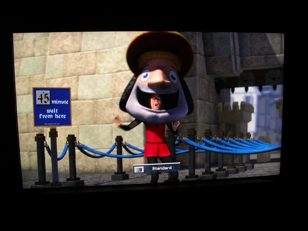

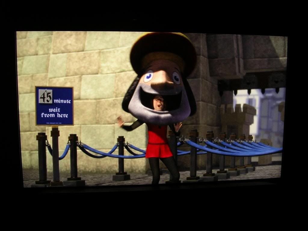

Tried those settings, whites seem a mucky yellow though, prefer on warm 1. On Fargo the snow isn't white, it's a light beige. Here's a couple of snapshots with colour temp normal and warm 2. First one are my own settings, in standard.
