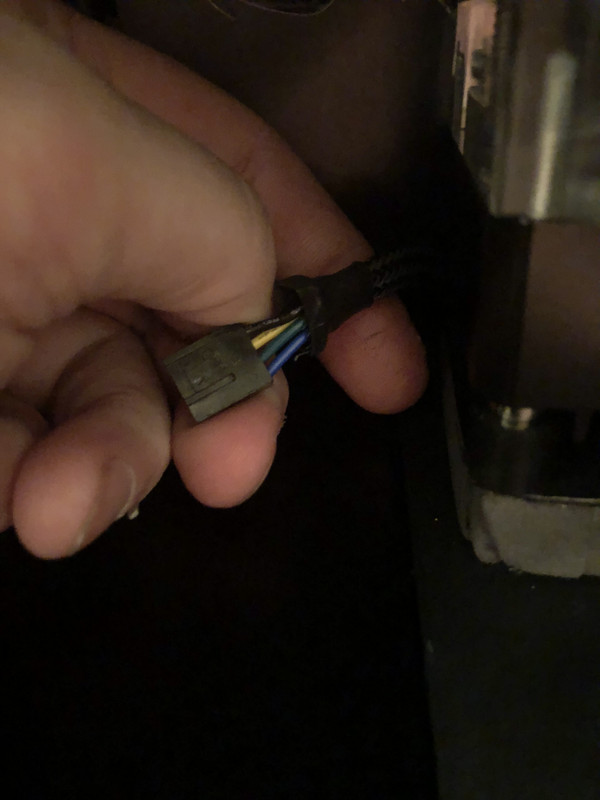

I wired my DDC pump into a fan header, but research has led me to believe that the tach and PWM colours are reversed on DDC pumps.
This is my current configuration, which I believe is wrong; I think I need to swap the blue and green wires.
The pump is a standard generic Laing DDC.
Can someone confirm?

I took a gamble and swapped the wires. The pump is working.

No the original way was the correct way around, just think of how a 3 pin fan plug is wired with the missing pwm cable, that missing cable takes up the 4th spot, the PWM cable.

Cheers for posting mate. Is the image you’ve linked from a resource on DDC wiring, or have you wired them that way yourself?
The reason I ask is because I solder fan banks a lot, and I know how they’re usually wired. But everything I can find online suggests that the PWM and tach wire colours are switched on the Laing DDC.
I’ve looked at images of the third party plugs and where they’ve used the OEM wiring scheme you can see that on the 4pin connector the colours of PWM and tach are reversed.
I’m quite confused now.
Well I tried putting them back, and now I get no RPM value. So I’ll be leaving them switched over until I can find a definitive answer.
I usually ignore colour codes and presume that everything comes wired correctly to its plug. The 3 pin and 4 pin headers have pretty much standardised pinout, but the colours are not standardised. Ran into this issue when working with GPU fans too.
I can tell you 100% on a Laing D5 PWM that the blue is inboard on the 4 pin. That being the rpm signal, pin 3.
And completely opposite to the standard colours. Don't ask...

Thanks, this is what I thought, and what my testing has confirmed. It’s good to know I’ve not gone mental.
