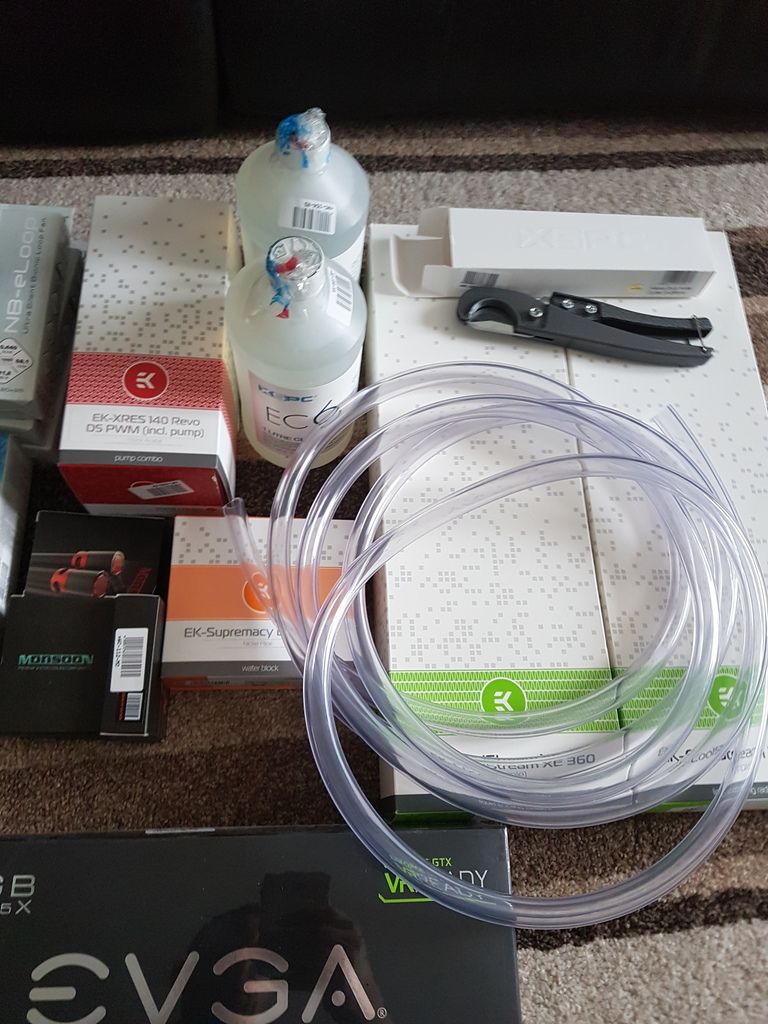

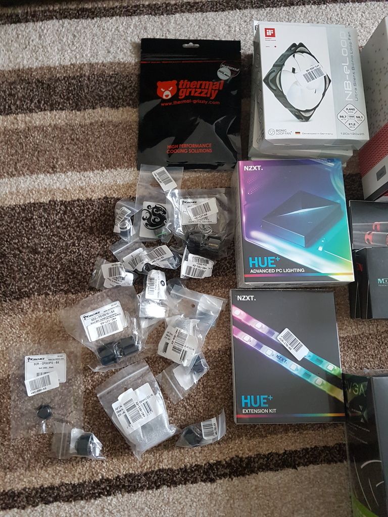

Ok yesterday i received all the parts i ordered and i checked them off the list which i ordered online and the list in the box.
To my surprise i had some 16 gb ddr3 ram which i never ordered any ram at all. I also had 2 pump res combos in the box as well. Now me being me it didnt sit well that i had additional parts i didnt pay for so i called Ocuk and asked if i had qualified for some free stuff other than the Haribos lol.

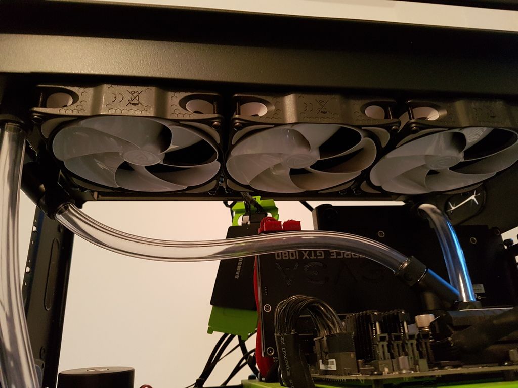

Had to re think the rads at the top as the thickness with fan attached made one of the rads touch the gpu and i couldnt sit in place properly. Now one rad is attached to the floor at the front of the case blowing air through the rad and out the bottom.
The other rad remains at the top, will need to think where to put rgb lighting as the thickness of the rad and fan will obstruct where i was originally going to put the led strips.

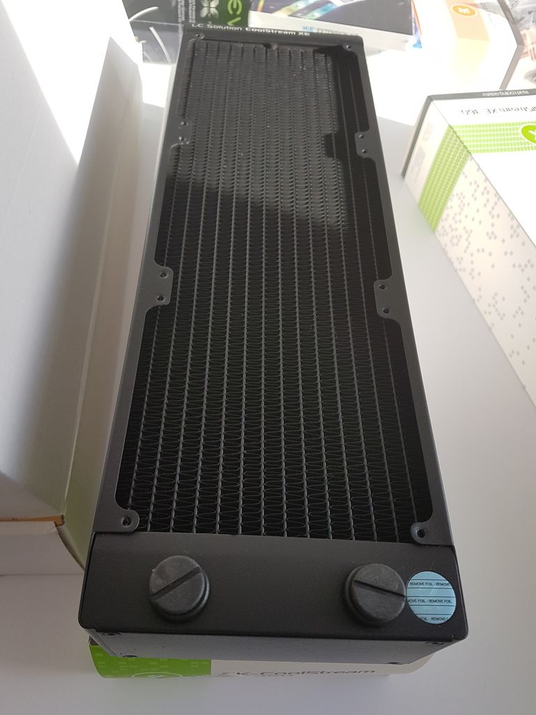

here is one of the rads all flushed out and ready for the fans to be fitted

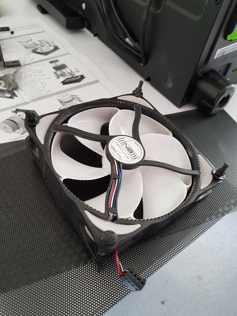

These are the fans i will be using for the rads, i already had some from previous build
Noiseblocker NB-eLoop Fan B12-PS - 120mm PWM (1500rpm)
Now rads were going in the top of the case but because of the depth of them with the fans connected, they hit the top of the gpu and i wouldnt have been able to put them in place so i had to move to plan B and placed one in the top and one in the bottom.
I didnt take a pic of this so here is the bottom rad in place with a fitting and one pipe showing as fitted from further in the build.

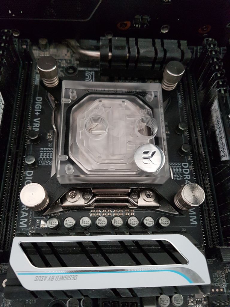

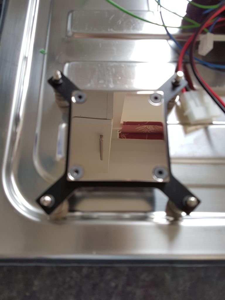

Now the water block, very shiny :)

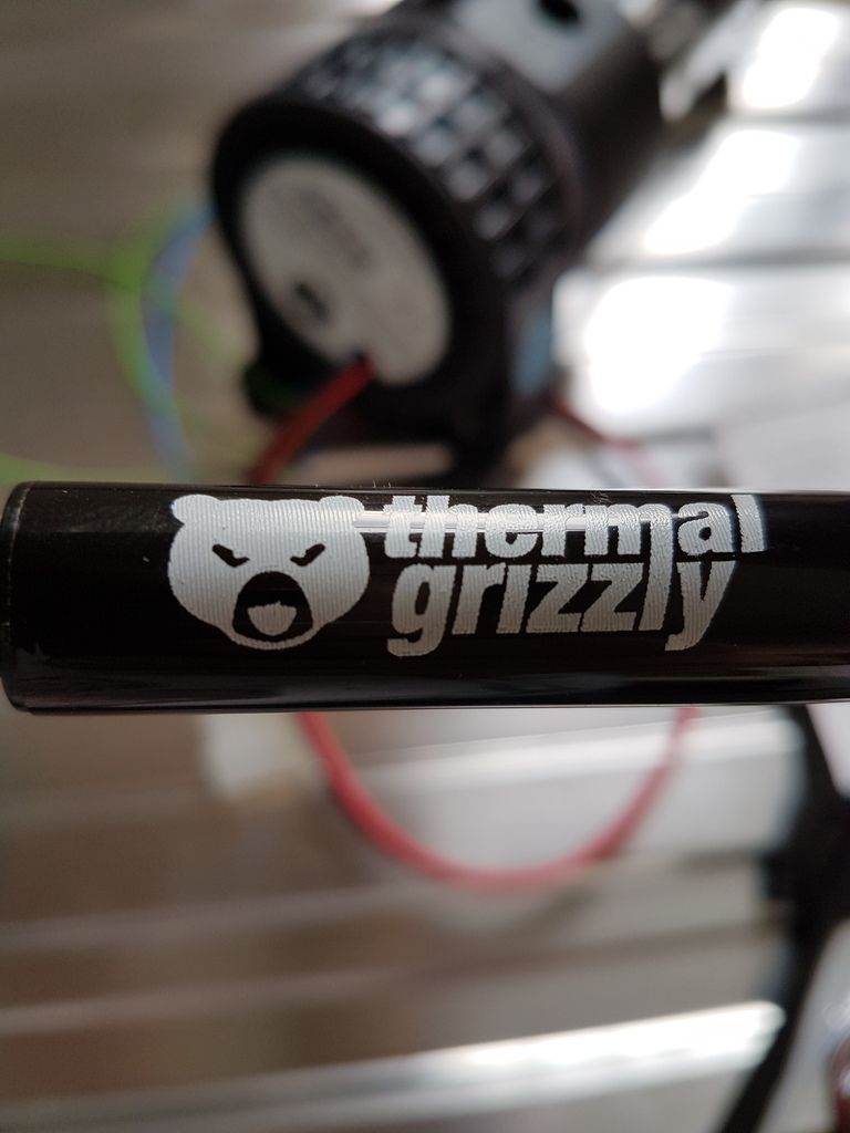

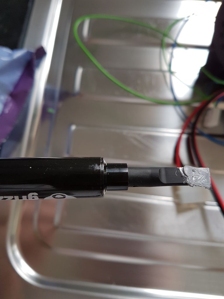

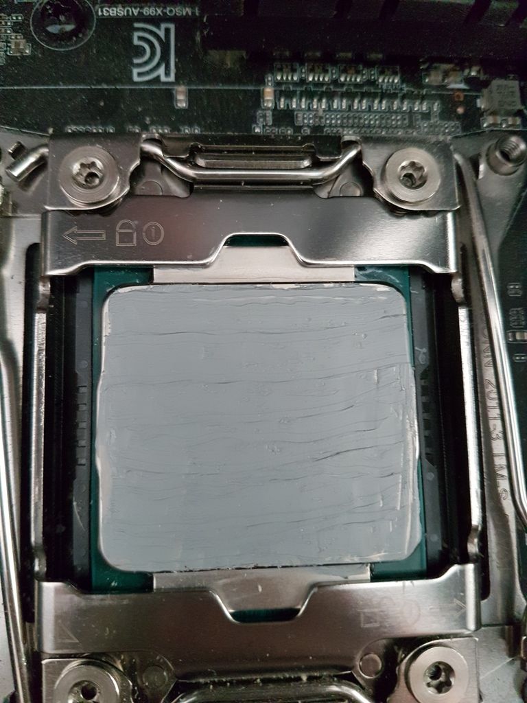

I have never used this thermal paste before but have to say im impressed with the thickness for spreading and the applicator it comes with
The paste applied to the cpu, looks thicker on the pic than it is

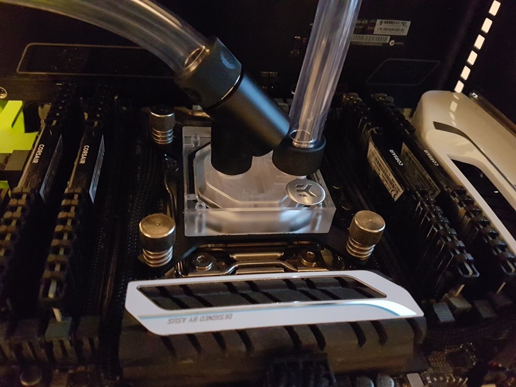

Block fitted
The gpu looks nice and lots of options for tubing inlet/outlet

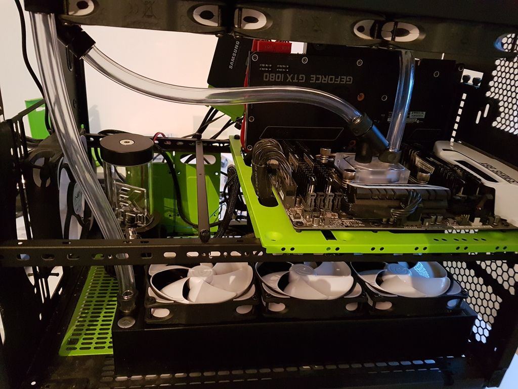

fitted the pump holder to the stand on top of a 120mm fan
i changed out the broken rubber for a new one.

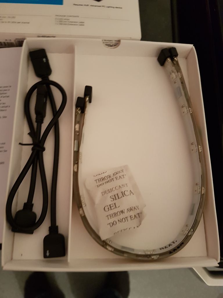

Now i have gone for clear/uv liquid and decided to go the route of RGB HUE led lighting with the extension kit so i have plenty of scope cable wise etc and it gives 2 extra led strips
extension kit

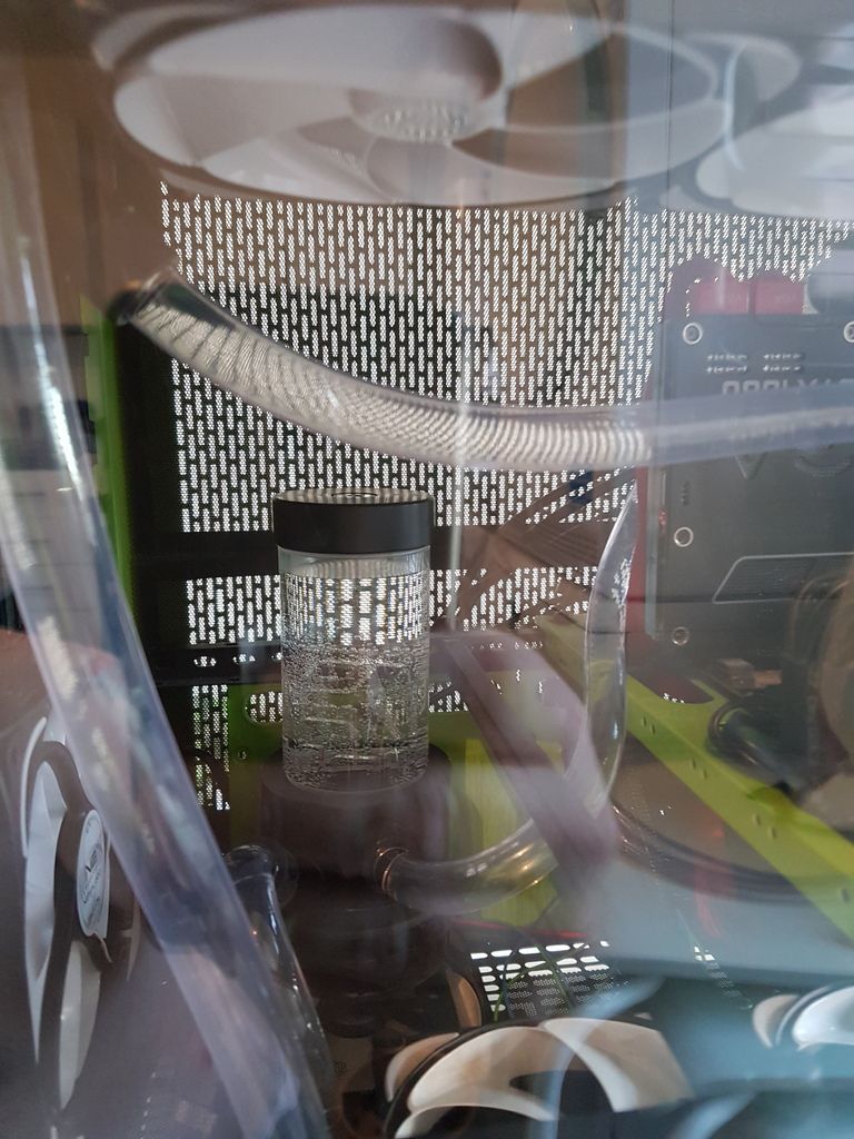

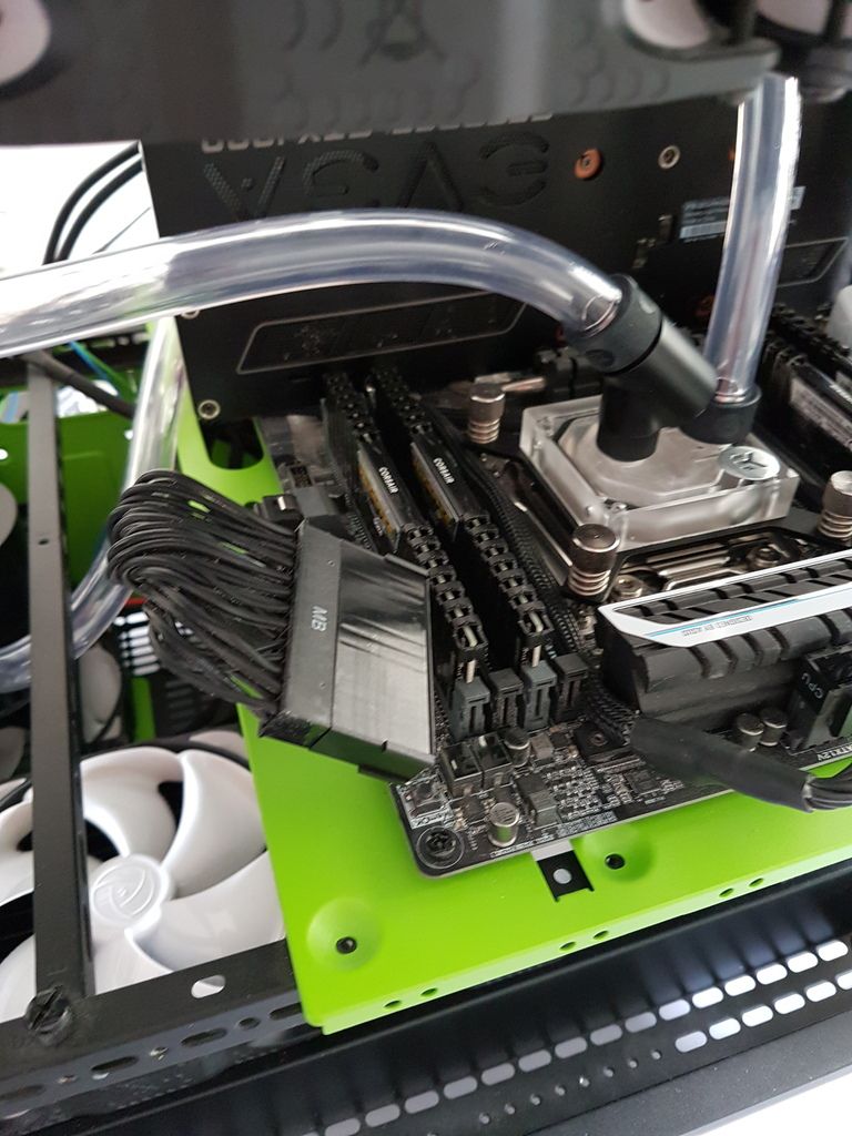

So now i started fitting it all together with the tubing and making sure the ins and outs were where i needed them and the loop would work once complete.
Pushing the tubes onto the fittings wasnt too difficult but at the same time i could tell they were secure/tight.
Now to fill the loop up with the fluid i created this
Works like a charm and ive kept it for future use.
At this point i started to fill the loop and was careful not to let the pump run out of fluid from the res. Now this is where i learned a lesson i wasnt aware of.
I had connected the pump pwm to the fan header on the motherboard and the loop wasnt flowing well at all. I couldnt get the loop to fill with water only half tubing full etc.
A quick search on the net and i found that you needed the pwm connection not connected while filling the loop as it only runs at 10% of its pumping capacity.

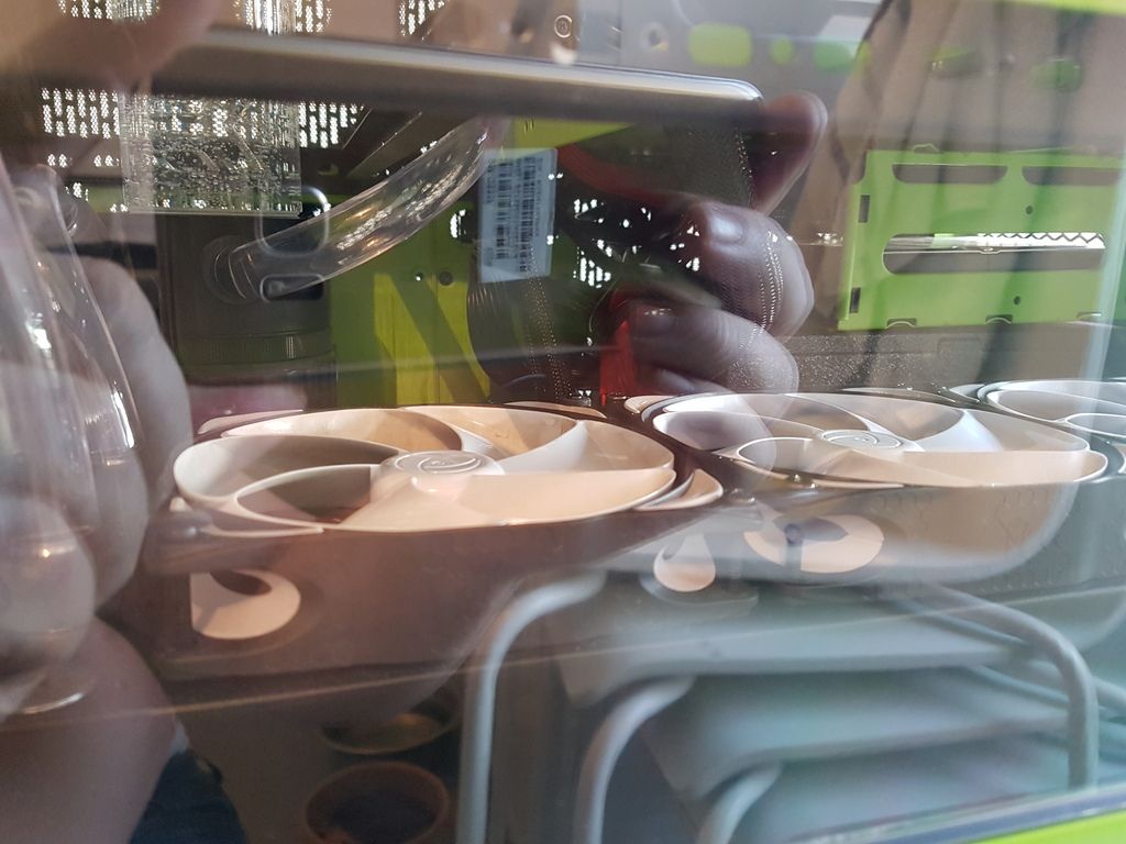

Disconnected the pwm and wham the fluid was soon racing around the tubes and rads etc. After a fair bit of case shaking etc to remove the bubbles everything was full :)
apologies for the reflections.
I have fitted a drain port to the out on the pump via a y piece but no pics of that silly me.

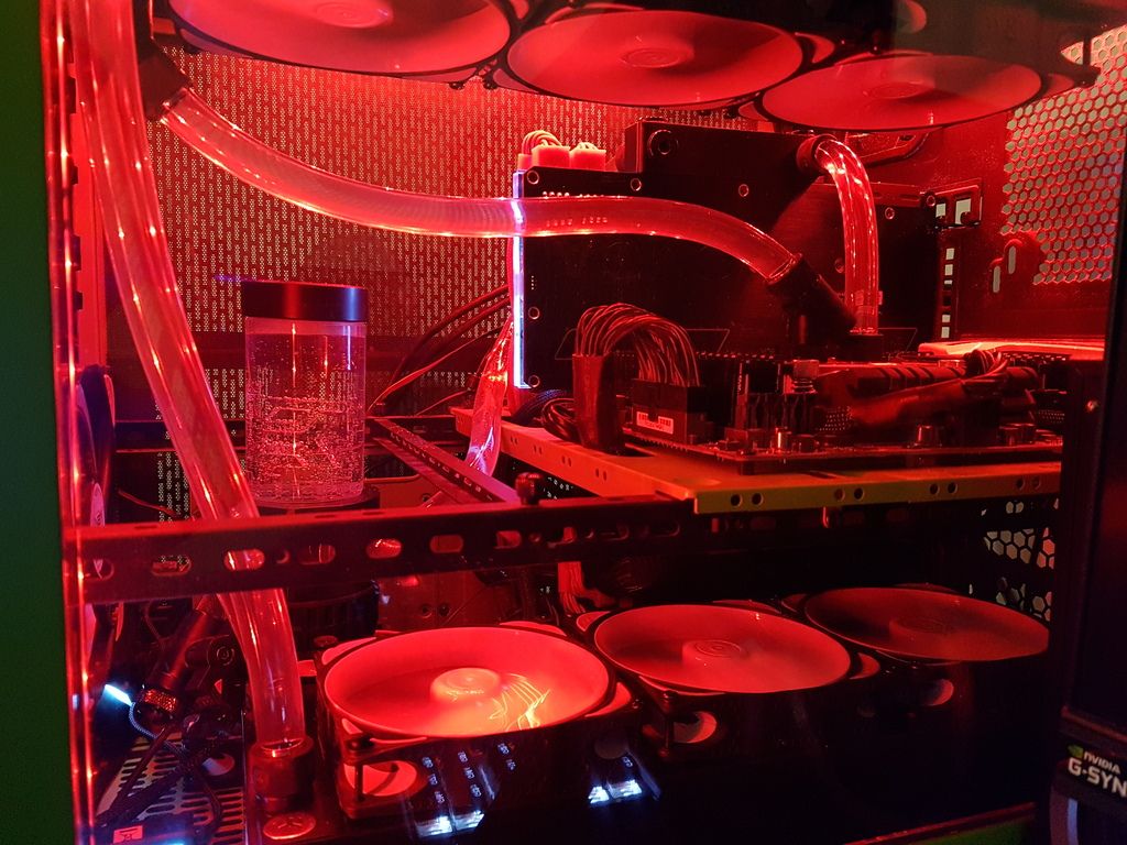

All in all would i do it again if monies permitted, dam right i would, after having to rejig hdd positions, rad placements, wires wires and did i mention more wires. It was a challenge for my first venture into a true custom water loop and its been a very rewarding experience.

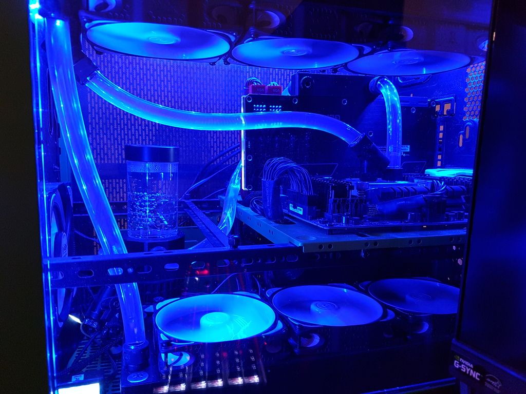

now i have the rgb lighting setup to a flame flicker and the colour, well you will see that in the pic :)
its a deep red
and a subtle blue
Thoughts and questions welcomed im very happy with it hope others like it too.
