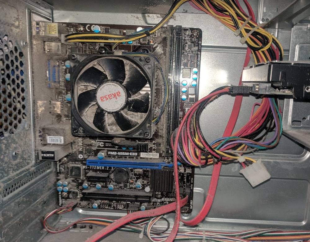

No, sadly not. Pardon the dust, but the only available slot is that blue one:
Just the one slot. Motherboard is an MSI fm2-a55m-e33. Graphics card is a 4gb Sapphire RX 560.
Please do clean it. If nothing else it'll stop the CPU overheating and may make it run more quietly.
I can't see how the video card can be blocking the two lower SATA ports that are in use at the moment.

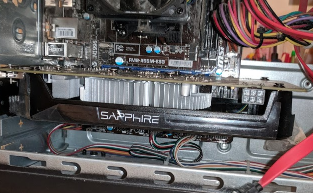

For the other two would cables with 90 degree ends on them fit?
Right-angle cable give you enough room? Though you could probably only use one.
I was just thinking that, and think I could get away with two. There are four SATA ports on the motherboard, I could use the two on the right hand side of the four, rather than the two at the bottom. I'd have to check the clearance.
Just put it back in and there might be enough clearance for right angled cables, difficult to know though. I've also just realised that I haven't even got the right power cable to attach to the bloody thing. A disaster from beginning to end!
This is it in situ:
There's a brand called "Postta" that sell rare angled SATA cables, if you ever need to use the other two. The ones you'd want would be:
Postta SATA III Cable (3 Pack)18 Inches 6.0 Gbps Straight to Left Angle Data Cable with Locking Latch-Red
Postta SATA III Cable (3 Pack)18 Inches 6.0 Gbps Straight to Right Angle Data Cable with Locking Latch-Red

Yes those will be good if you just use the two ports all the way to the right.
Any idea about the power cable for the card?
Not really. That card doesn't appear to bring a molex connector on it. New PSU, or some molex-to-PCIe 6-pin adapter, I'd imagine. Or SATA-to-PCIe like so:
