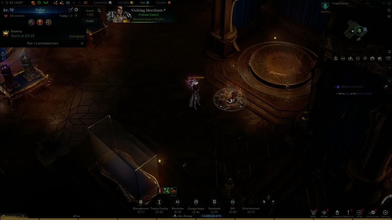

Here's a quick capture:
Even on my SDR monitor the image of the video looks the same, very dim. Compared to captures made when HDR is off:
That's because HDR is not SDR + extra colours.
HDR replaces the whole scene so to speak, so recording with something that does not support HDR will only display the colours that fell within SDR spec.
It will always look dim and washed out unless you record with something that fully supports HDR recording & playback.
Even then, playing back will look horrible on an SDR monitor unless you use MadVR codec or one similar which will tonemap HDR to SDR

Thankful for the very useful information. So I guess the non painless way would just be to stick with SDR mode with a calibrated profile for when I want to record gaming or anything like that.
