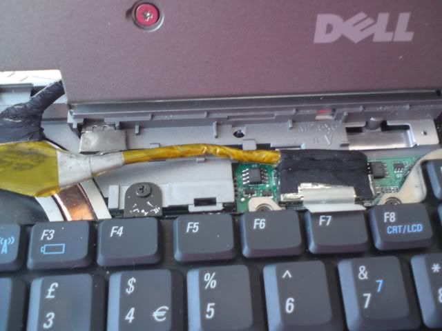

I have re installed xp onto my Dell precision m60. Although the re format went fine and also installing sp2 the screen never went off at all. But when i finaly
did the re start at the end, the screen doesnt stay on. Its fine for about 20 seconds and then its gone.

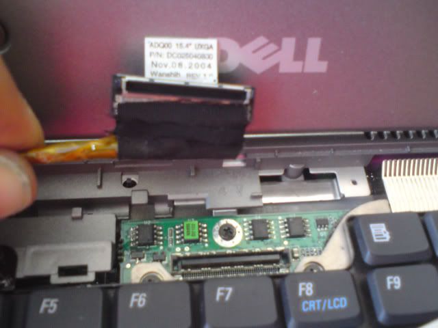

What i have discovered is that if i pull the plug to the screen under the button strip and replace it, it comes back on emmediatly, graphics look fine but then its gone again after the 20 seconds.
This laptop was given to me with this fault but im hoping its not too expensive to fix.
This is the plug i am refering to.
I would really appreciate your help on this please.
Thanks Rob.
