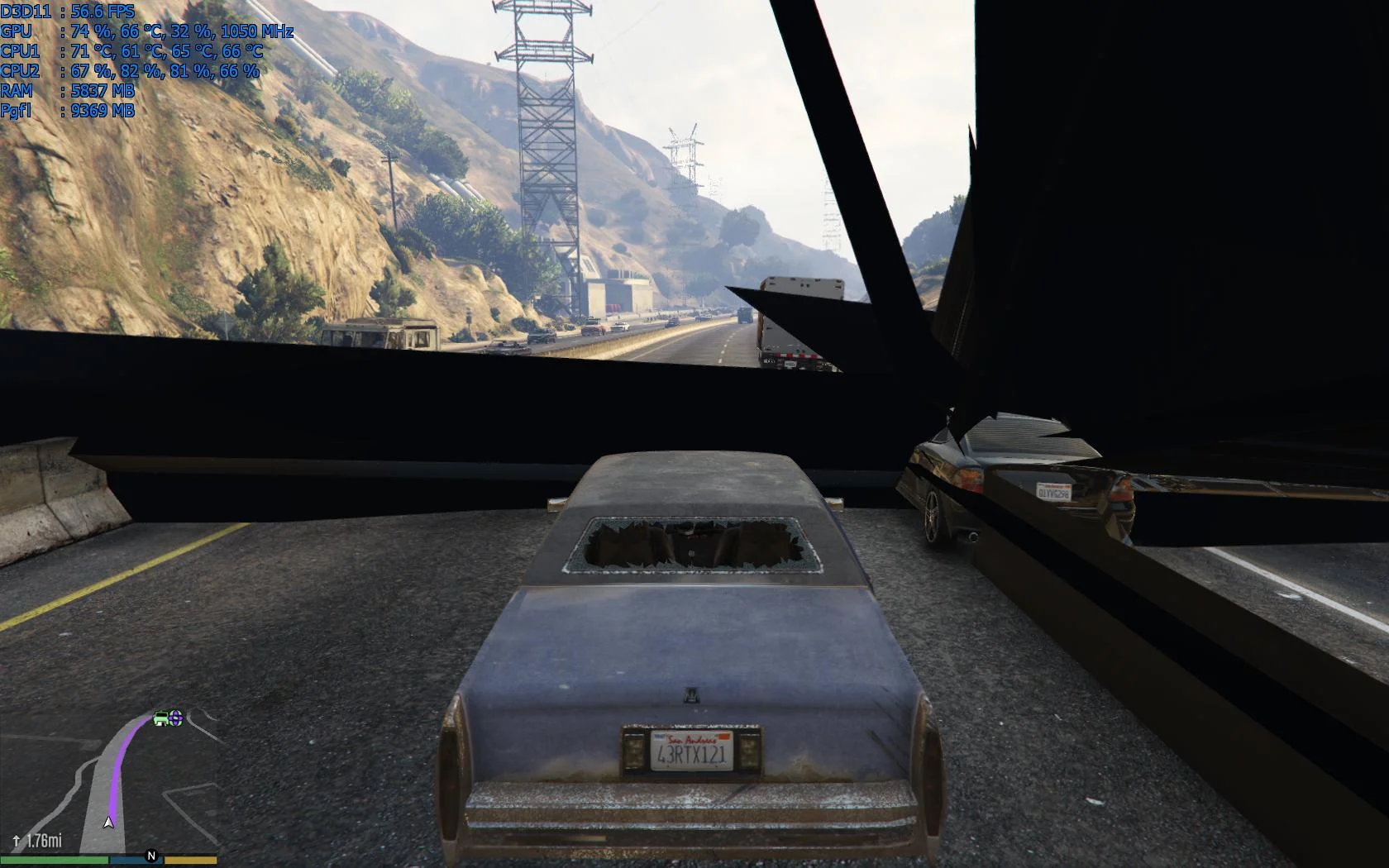

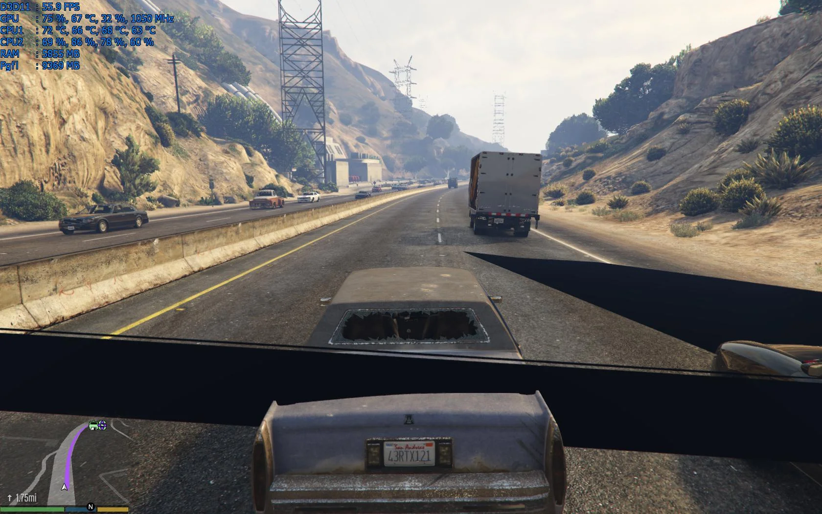

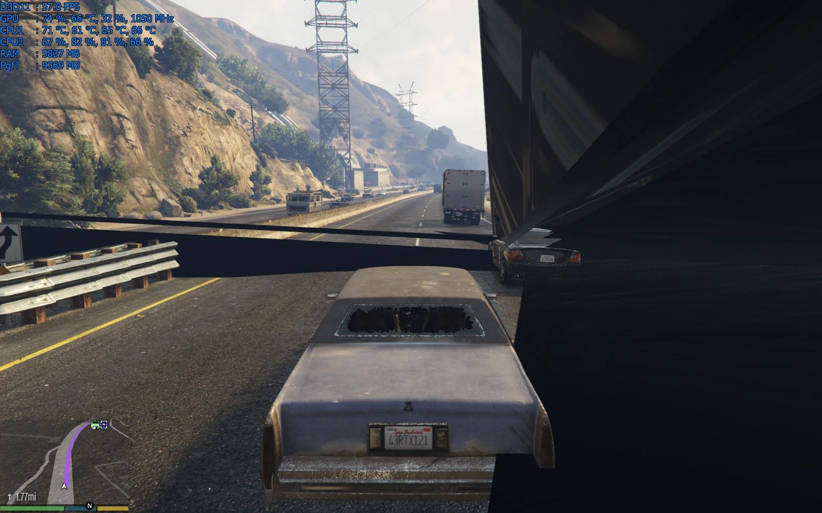

Hi guys,
I'm getting strange things all over my screen - Link to a video is HERE
Do you think I should RMA the card?
My rig is:
I5 2500k @ Stock
Asrock Z68 Extreme GEN4
8GB Gskill DDR3 1600mhz
128gb SSD
1TB Mechanical Drive (Gaming drive)
750w XFX modular PSU
I play CS:GO as well and I don't get these graphical glitches. I've also run haven / furmark and again they don't appear. Seems to only really happen in BFH.
Tried all the drivers etc.
Just wanted an opinion if you thought it would be worth sending it back to gigabyte.
It's a Gigabyte R9 280X Windforce 3X. I've updated the VBIOS as well to Gigabytes latest.
Temps all stay below 65c.
If you google "Gigabyte r9 280x artifacts" there are so many articles relating to the same problem but I just wanted a second opinion really.

I'm having the exact same issue in GTA V. I've tested both of my cards individually and it's happening on both. The chance of both cards have gubbed VRAM at the same time is unlikely. I reckon it might be a driver issue.

I have been having the exact same issue in GTA V as you, Goose but I'm not at all convinced that it's a hardware problem. I've been looking online and others are having the exact same problem but most of the time it appears to only happen in a couple of games and not all of them. I've not had time to test any other games but I can test more tonight and see what the outcome is.
