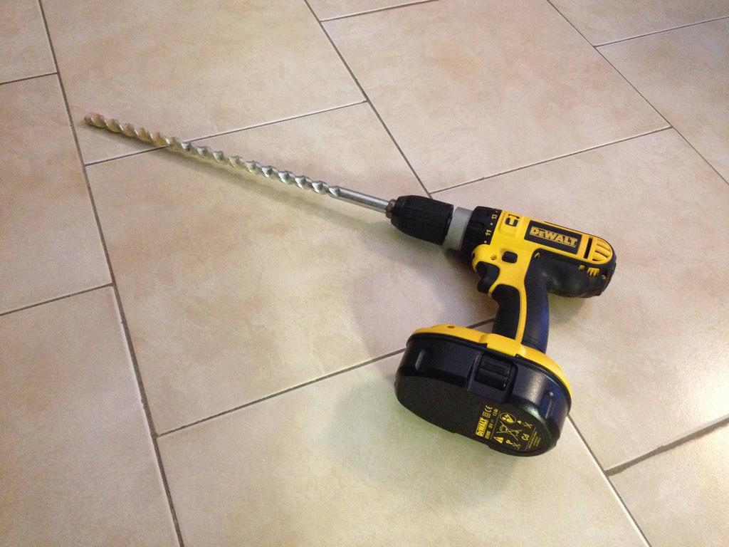

I never regret my £99 gamble with my DeWalt a couple of years back. It sure does take a beating!:
I think you'll be able to find deals on the 18V Li-Ion now!
