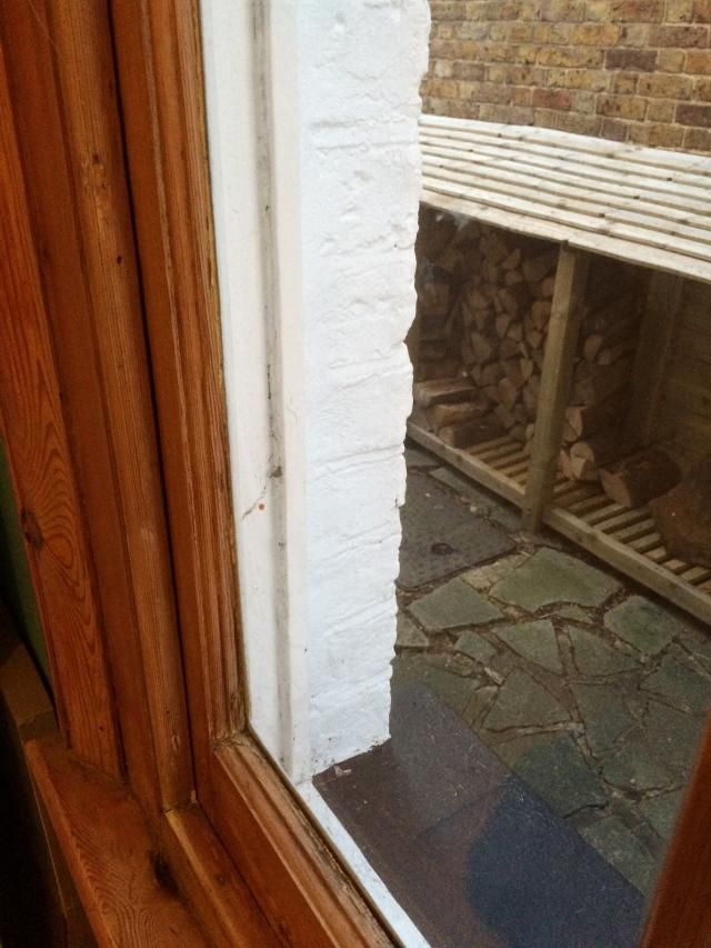

We've got some original victorian leaded windows on out stairs and the kids play room as some lovely original sash windows in there.
I don't want to get rid of either and I can't afford (I assume) to have the sash ones replaced with new double glazed ones (they are 2x 1mx2m) so I'm looking at having secondary glazing either internally or externally.
Both windows are on the side return so I'm not too bothered about external looks and I'd prefer to keep the internal look as much as possible, but I'm having difficulty finding anything external so I'm assuming there is no such thing or it've very rare (and thus expensive).

As you can see there is plenty of room externally for another frame, but nothing internally. Same goes for the lead light on the stair. Tried to get someone round to have a look but all the local glazers / double glazers are on holiday until the 5th.

It is possible to modify the existing sashes to fit a double glazed unit, which can be as thin as 9mm. It all depends on how much deeper you can take the rebate, a quick look at that picture looks like you may have room. If the sashes are moving freely then you may need to add weight after putting in DG, which means opening the pocket which can be a pain if its in the middle of the box.
