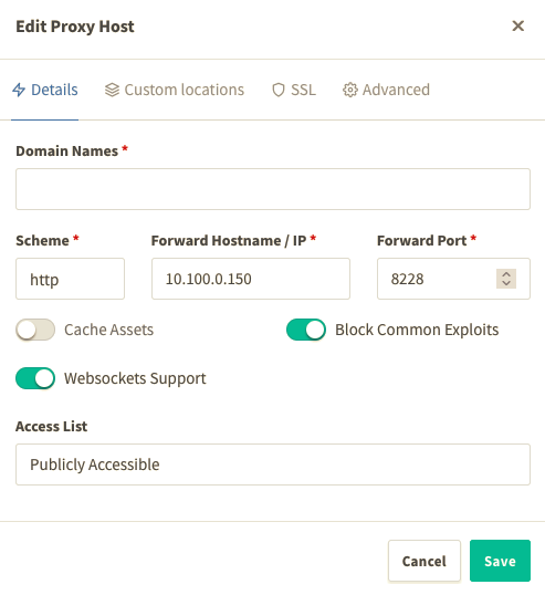

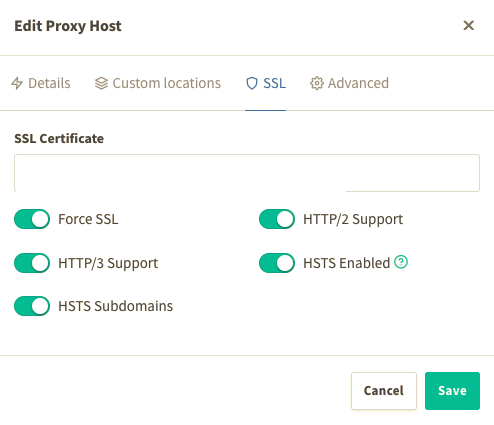

For NPM:
Then in Advanced > Custom nginx config:
