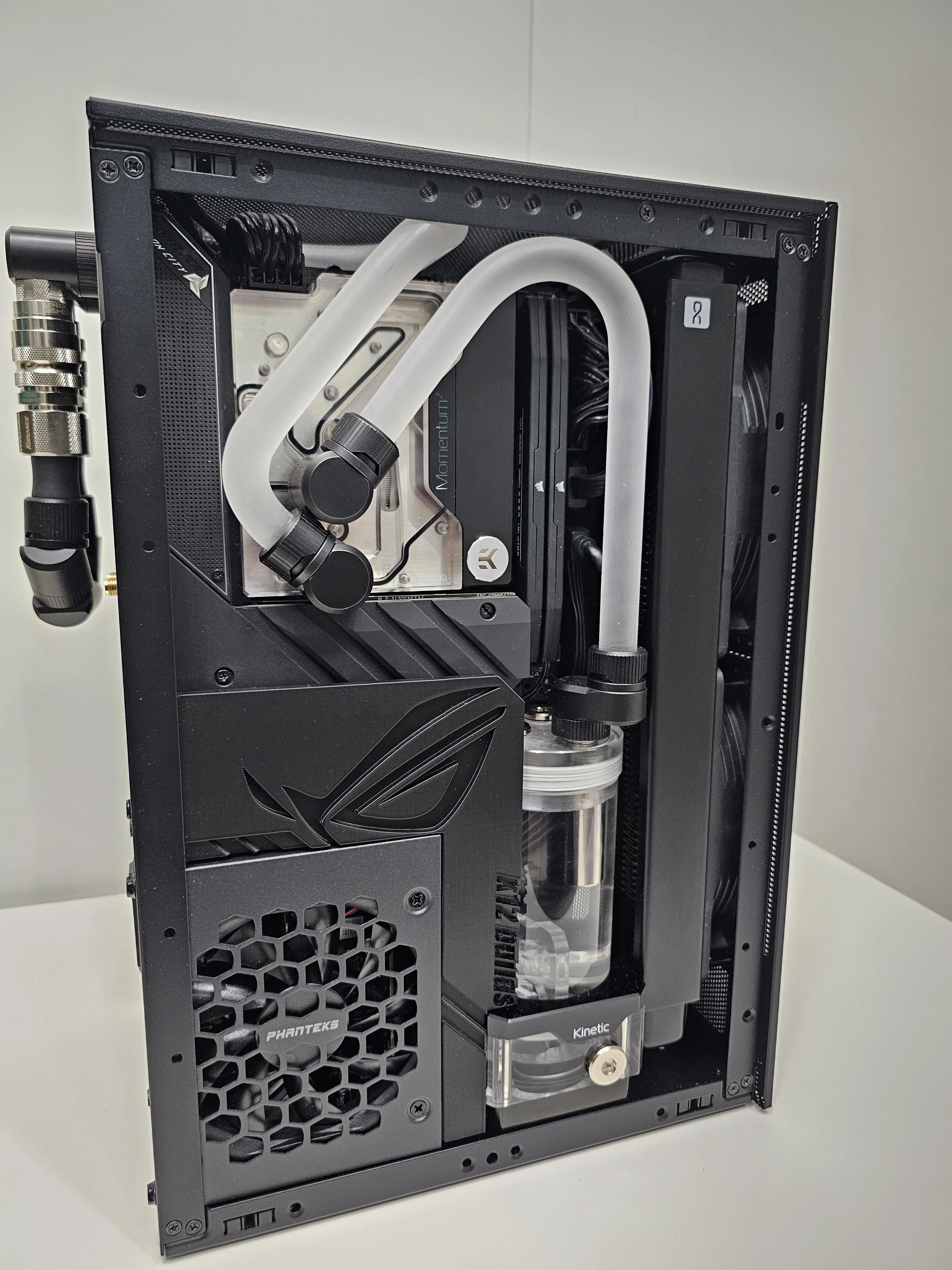

I got quite big cards in the Meshroom S but not sure if you can still get that case. I only done tested the hardware in air state but moved to watercooled build but the EVGA 3090 fit that case. Dont have a pic of it with the aircooled 3090, but it can even take a ATX board
Meshroom S is only 336mm length GPU and with ATX boards can only can 3 slot GPUs.
Also need a 40cm single reverse riser cable with ATX which is harder to find.
