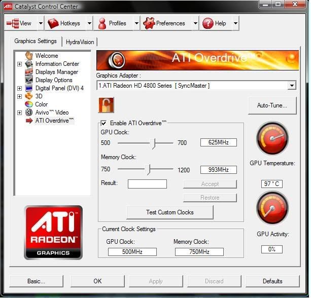

my fan is going @ 50% but after 5 minutes of playing cod4,temps are reaching 95+
I dont think it is too dangerous for the actual gpu, but it cant be doing your other components any good. Especially a sound card etc. If you have good airflow in your case then i wouldnt worry
Those temps are a bit high for the fan @ 50%. My 4870 fan is set to 30% and my load temps never go over 70C, but i guess the 4870 has a bigger cooler. But at those temps there shouldn't be any problems, but i still would have thought the fan set to 50%, the temps would be lower.
Assuming it's the autothrottle that's running the fan at 50% it's absolutely fine.
If it's a manual fan setting of exactly 50% then you've got troubles, as the auto fan would be running much faster by this temp (seem to remember someone else here quoting that 50% is where the auto sets it at around 85 degrees). Fighting high idle temps is no use if you vapourise the core under load.
i followed the quide to manually changing the fan speed,50% didnt work but now ive set it to 51%,temps are now below 45c :)
