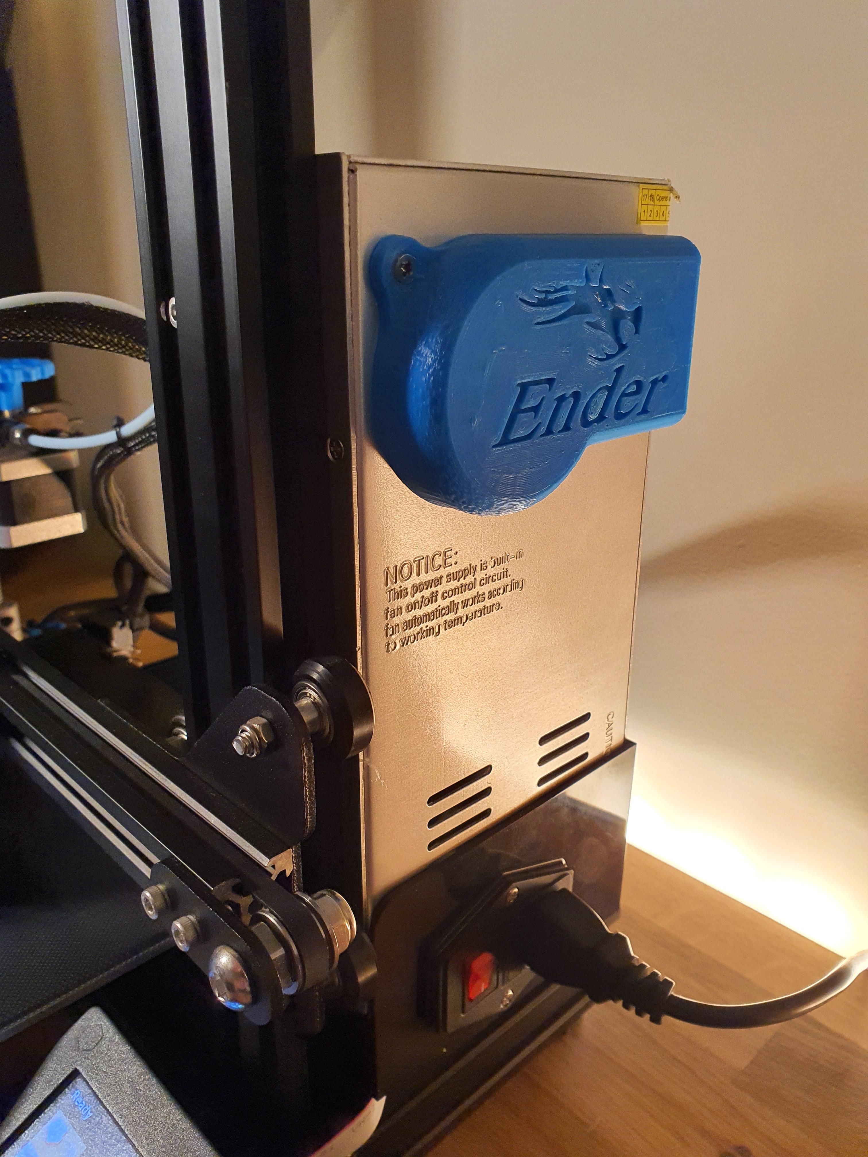

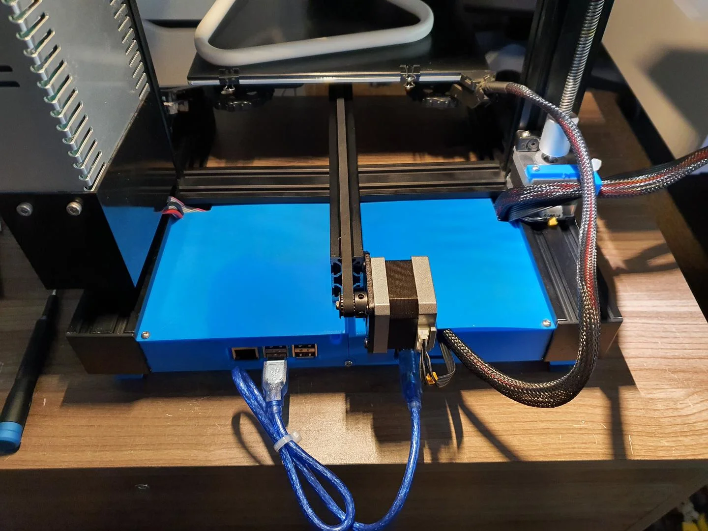

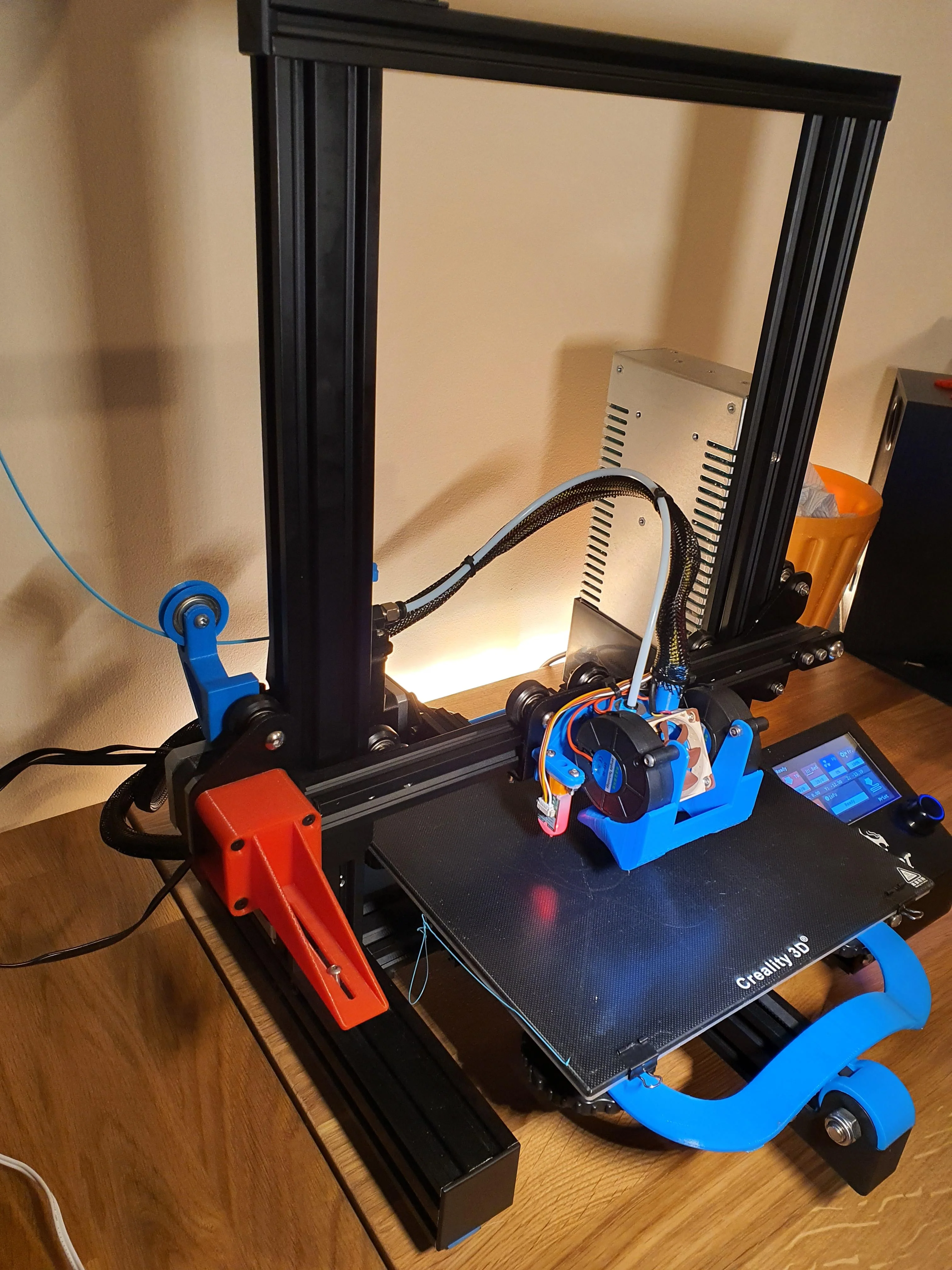

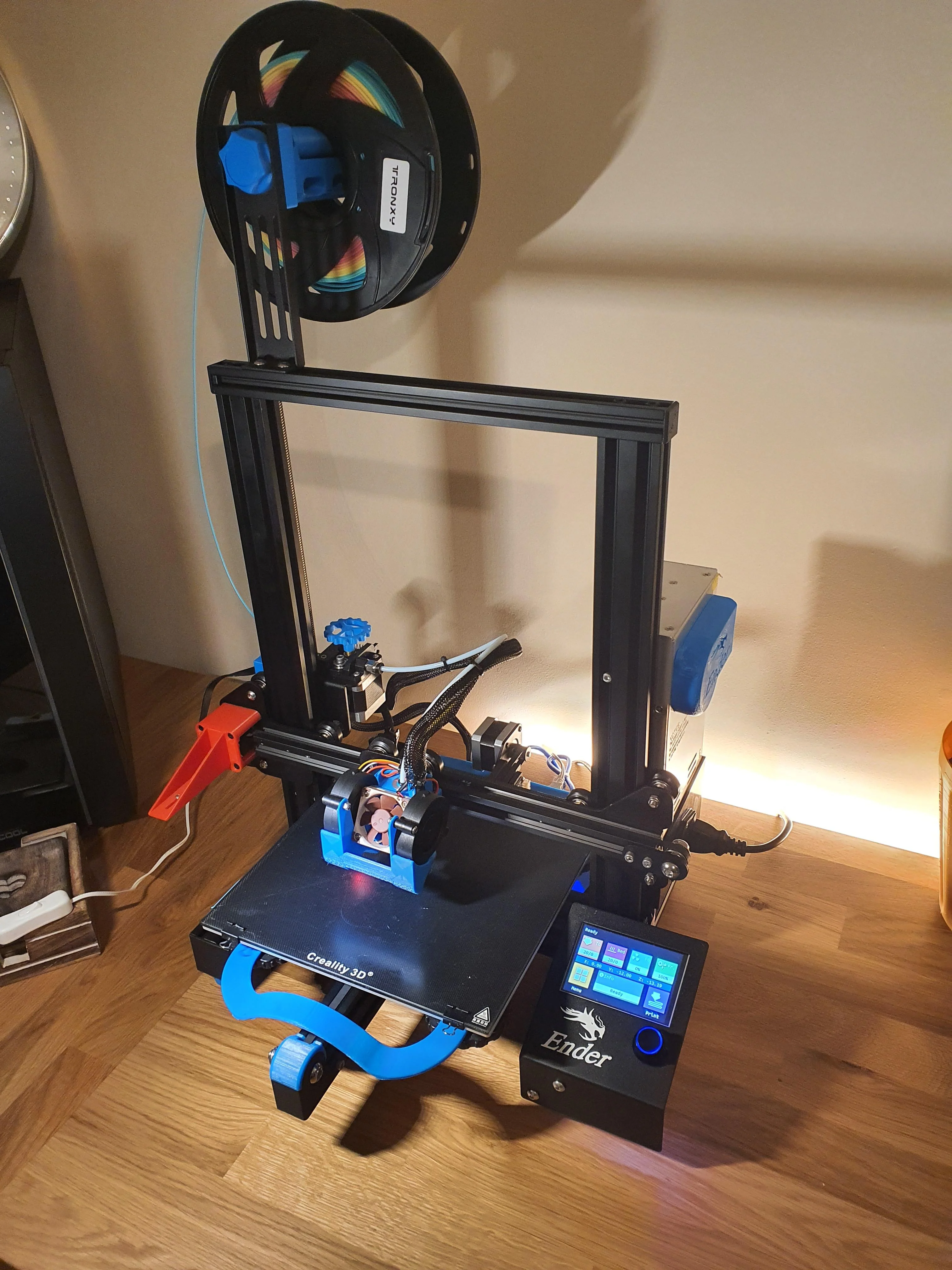

Creality Ender 3
Mods:

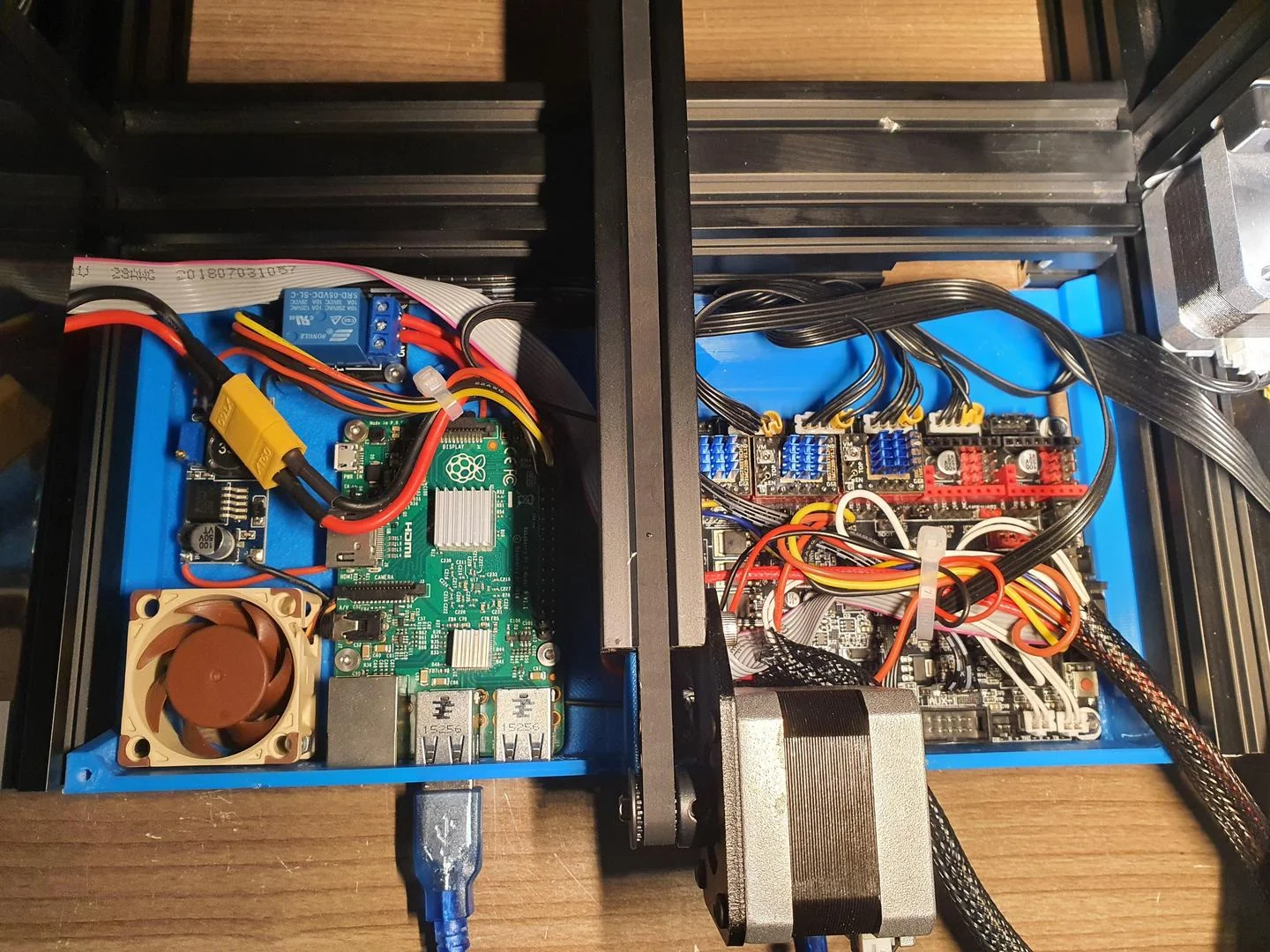

SKR 1.3 Mainboard
TMC2209 Stepper Drivers
Custom rear enclosure with Raspberry Pi running Octoprint
BTT TFT35 - Dual mode touchscreen display
Bltouch V3.1
E3D V6 Hotend
Hero Me hot end hozzle with dual 5015 fans
Noctua hot end and enclosure fans
Various 3D Printed mods such as the bed handle and psu fan cover
Used mostly for printing odds and sods, brackets and various little bits and pieces like that. I really enjoy the setup and the tweaking and improvements that can be done though.

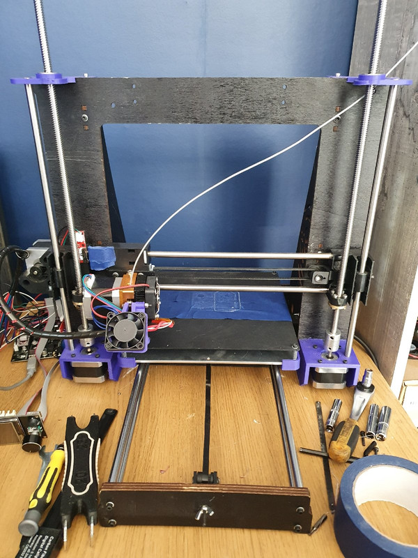

Mine right now is just the printer I started with and has sort of evolved into me building a new one. This is the printer I am currently using:
CTC i3 Clone
Mods:
Mk7 Extruder & Hotend
AnyCubic TriGorilla Mainboard
X & Y DRV8825 Drivers, A4988 Drivers on the Rest.
Upgraded the M8 rods to T8 rods
BTT TFT24 - Dual mode Touch Screen
Alloy bed upgrade.
Various 3d printed parts.
It looks ghetto because it is ghetto

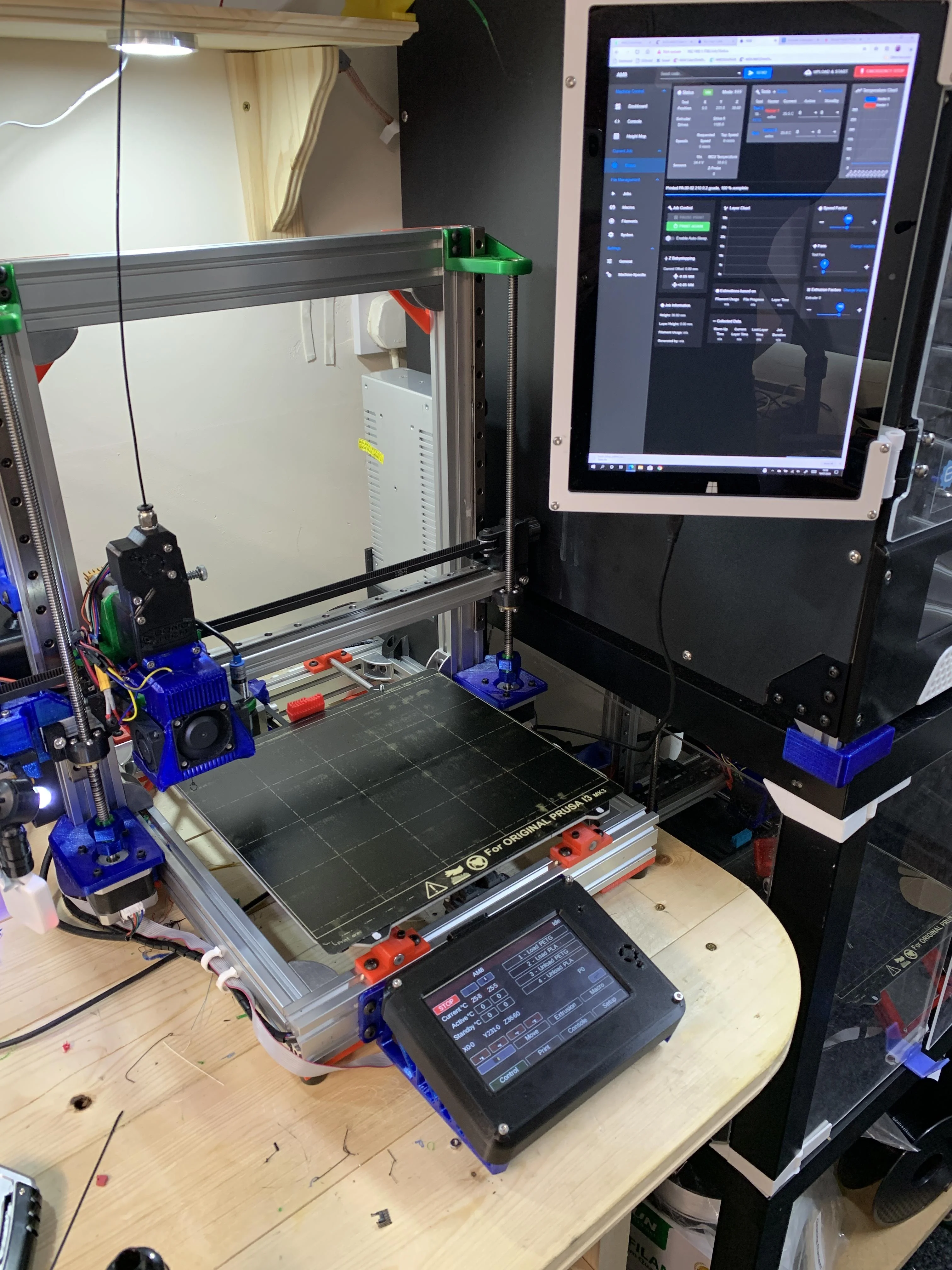

First my D-Bot CoreXY (Planning to be made into a CoreXY iDEX)
300x300
AC Keenovo heat bed
Linear rails on X & Y
SKR 1.4 with TMC 2208 drivers
Zesty Nimble extruder
Quality Volcano clone
3D touch
WhamBam flexible build system
https://i.~ibb.co~/xfQqQvv/IMG-20200524-133958.jpg

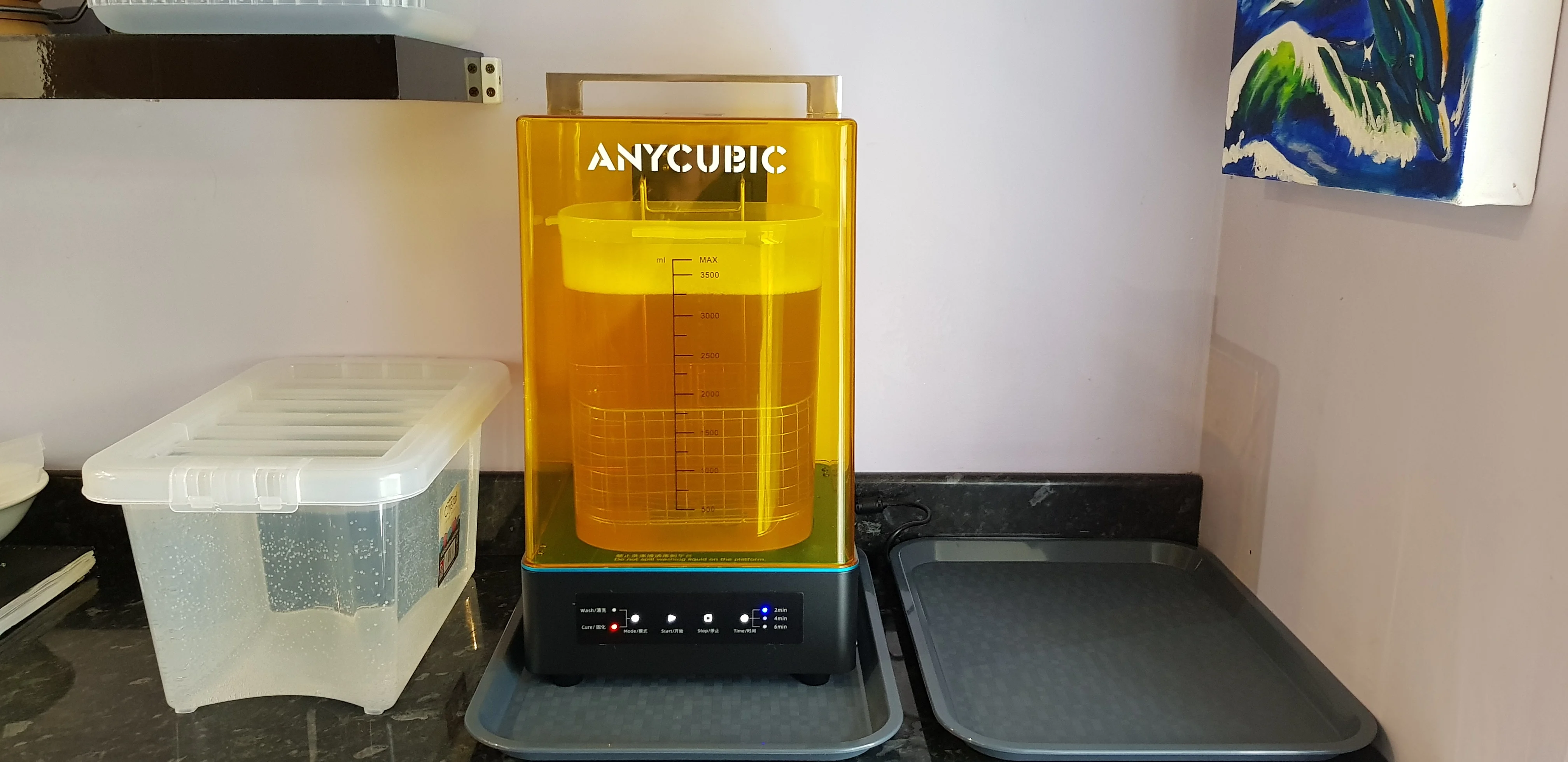

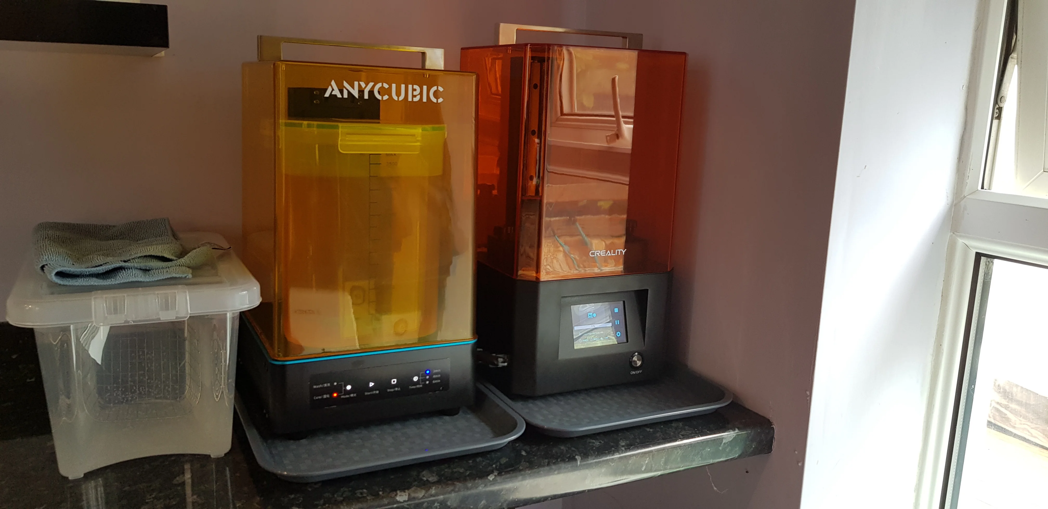

And my new resin setup
Elegoo MARS & Anycubic wash & cure
No mods... Yet ;-)
WhamBam slap mat
https://i.~ibb.co~/ky61K2C/IMG-20200524-134054.jpg

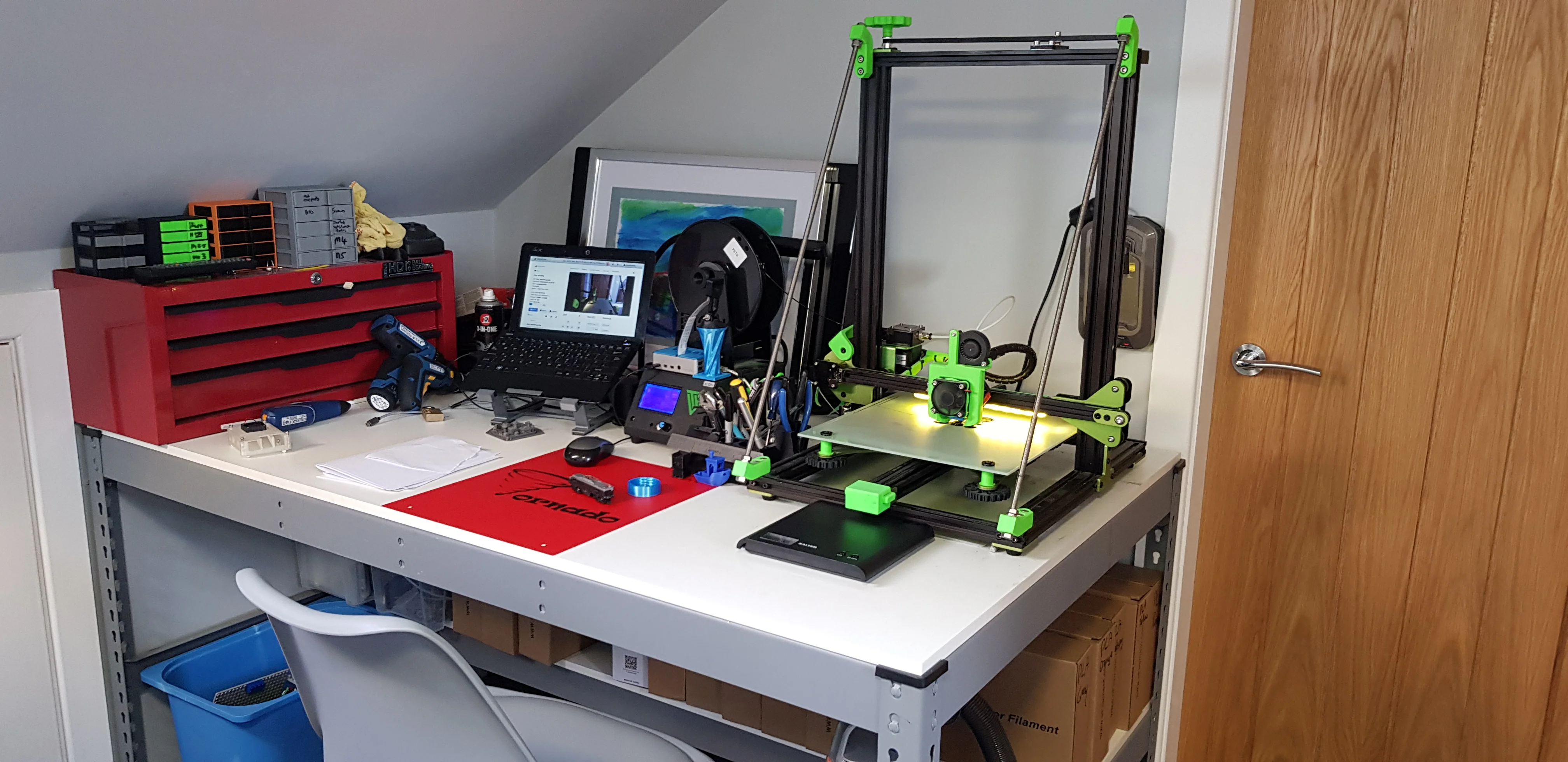

When we had the loft converted last summer I reconfigured the rooms to give a bit of landing space for my printer setup - here it is on a 1500x750 workbench:-
Tevo Tornado
Upgraded MKS Gen L board with 2208 XYZ drivers abd LV8229 on E
Micro Swiss all metal hot end
Glass bed replaced with Mamorubot build plate - direct solid mount
Genuine BLTouch
Dual Z mod
Frame Braces
Petsfang blower assembly
Control box fans replaced with 80mm ones to keep the noise down
OctoPrint control on RPi4 with Raspi webcam

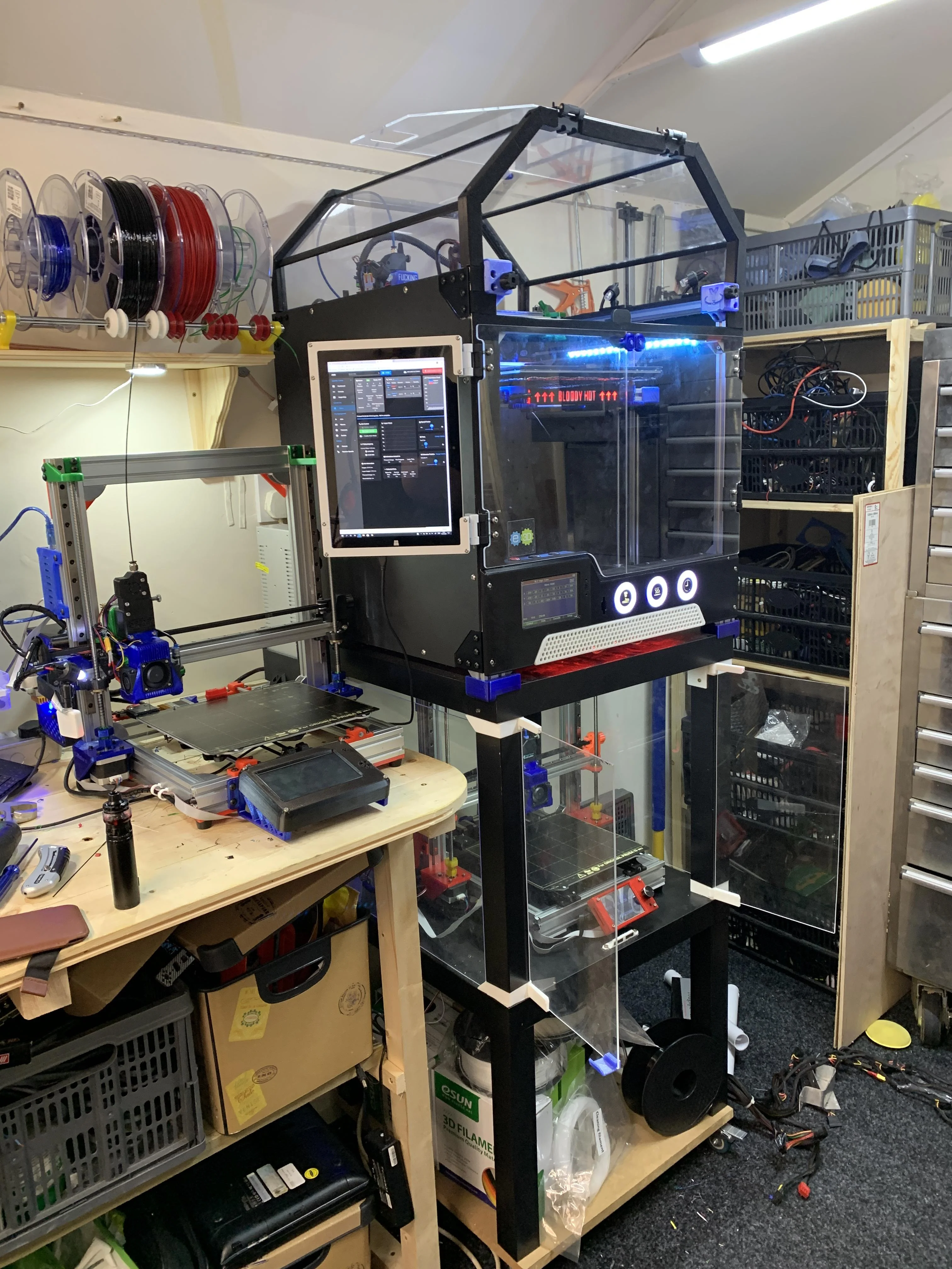

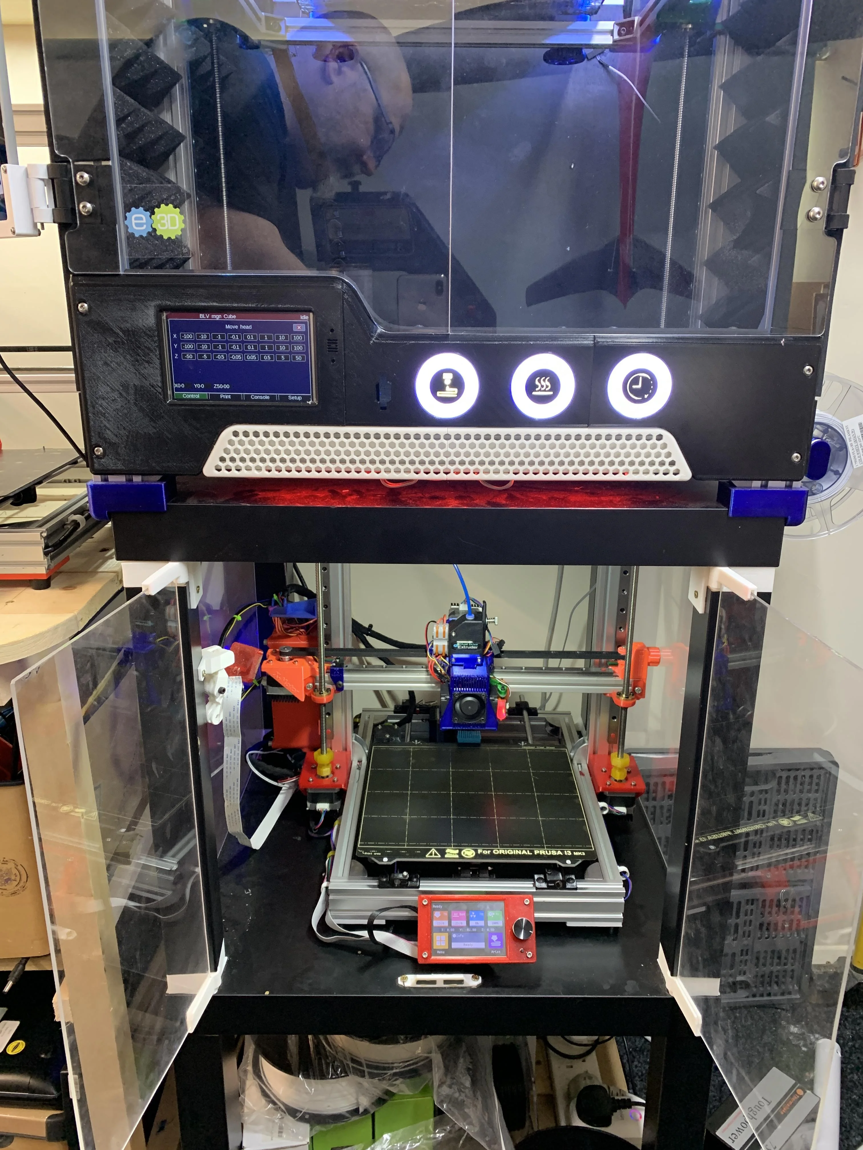

Here's my little print farm:
This one started out as a Geeetech i3 Pro W. All that is left of that is the steppers that drive the Z axis. This was the first printer I got.
The frame is the AM8 which is a 2040 extrusion frame for the Anet A8.
Specs:
Duet2 Wifi (genuine)
Paneldue 5" (clone)
Bondtech BMG extruder (genuine)
E3D V6 hot end (genuine)
Prusa MK3 heatbed (clone)
HiWin MGN12H rails for X and Z
Inductive probe
250x210x250 build volume
Raspberry Pi3 B+ running OctoPi
Custom optical filament sensor
This one started out as a Geeetech i3 Pro B. All that remains is the power switch and an endstop microswitch.
The frame is again the AM8 which is a 2040 extrusion frame for the Anet A8.
BTT SKR V1.4 Turbo
TMC2209 drivers
TFT35 V3
Bondtech BMG extruder (clone)
Clone MGN12H rails for X and Z
BLTouch (genuine)
250x210x200 build volume
Raspberry Pi3 A+ running OctoPi
Custom microswitched filament sensor

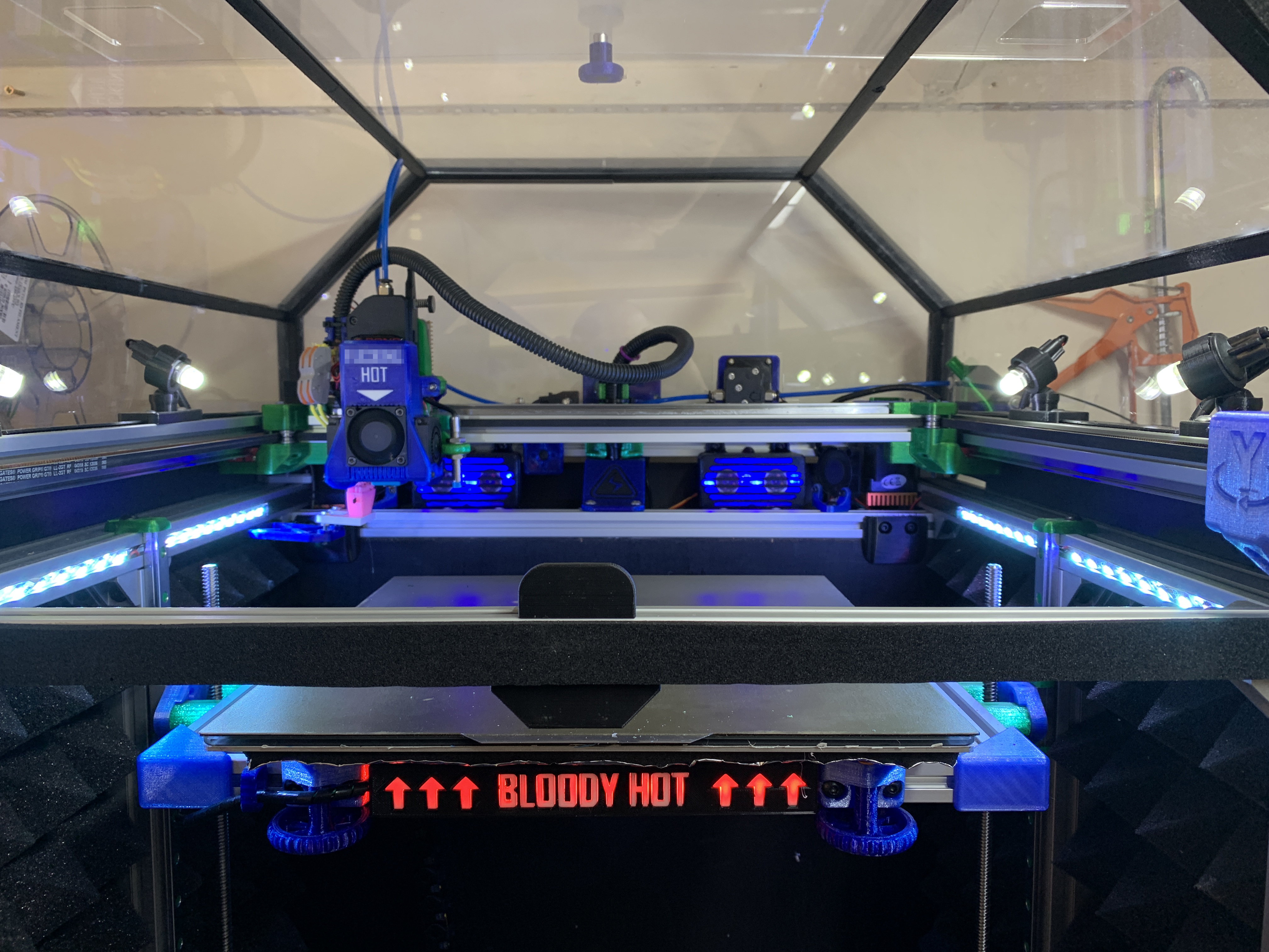

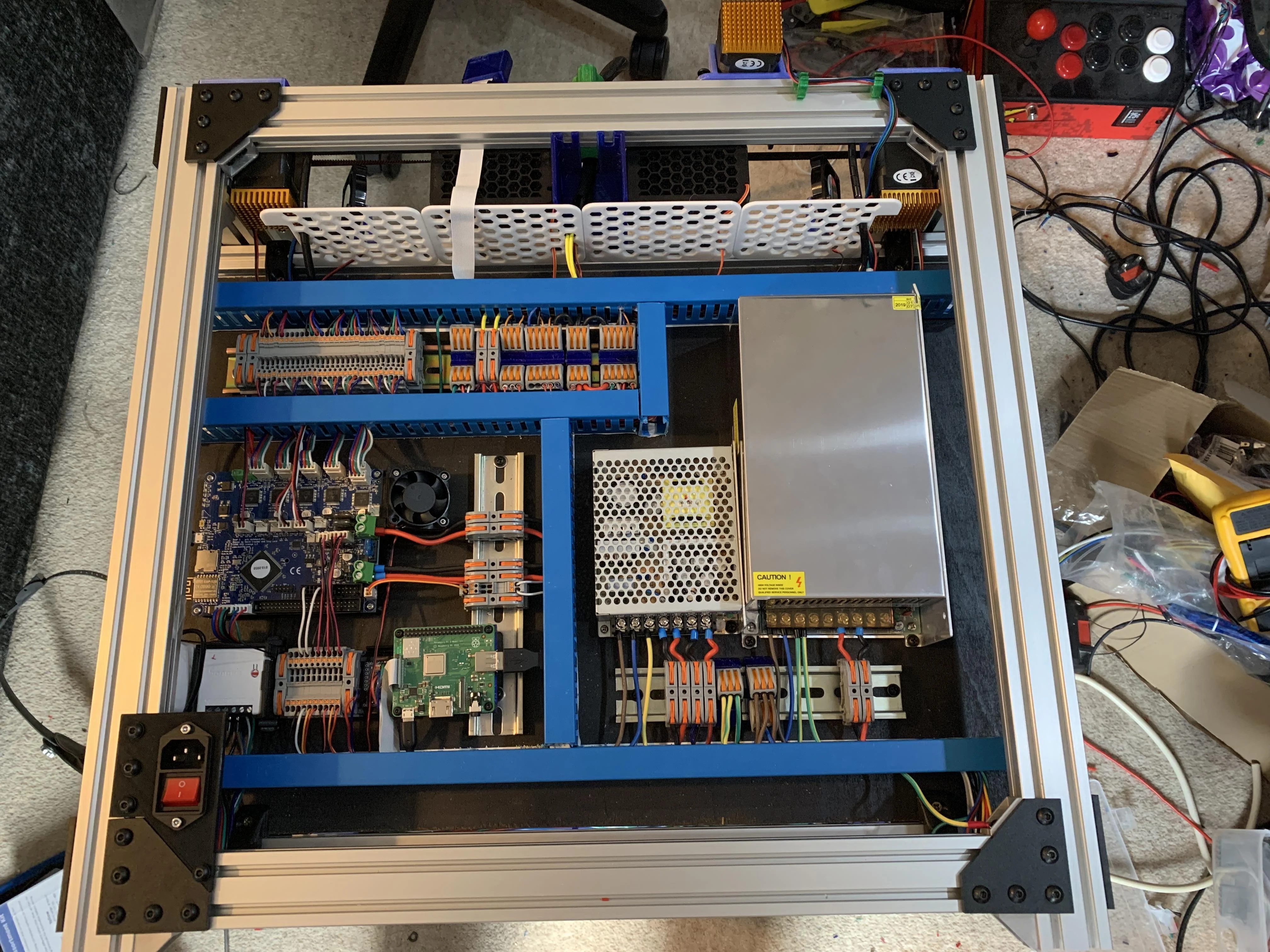

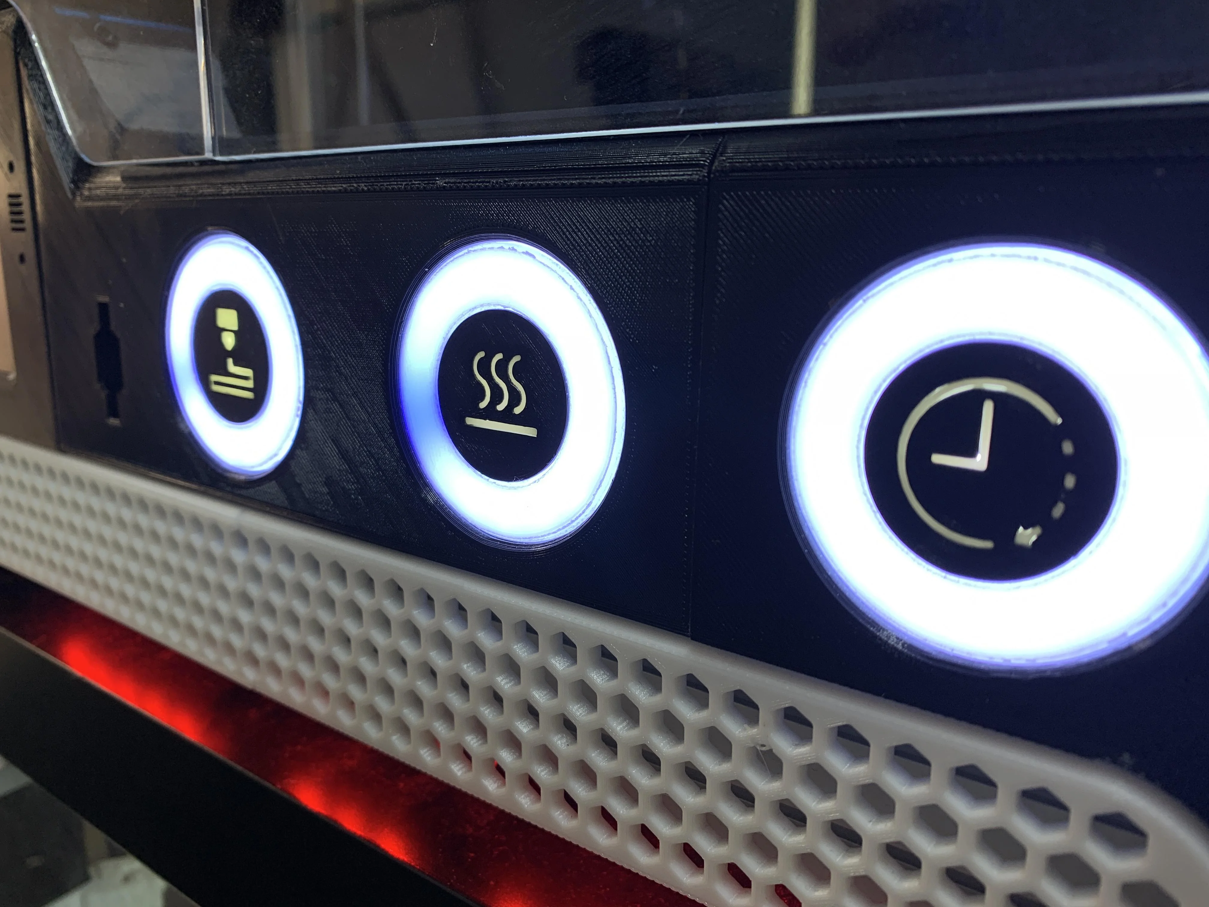

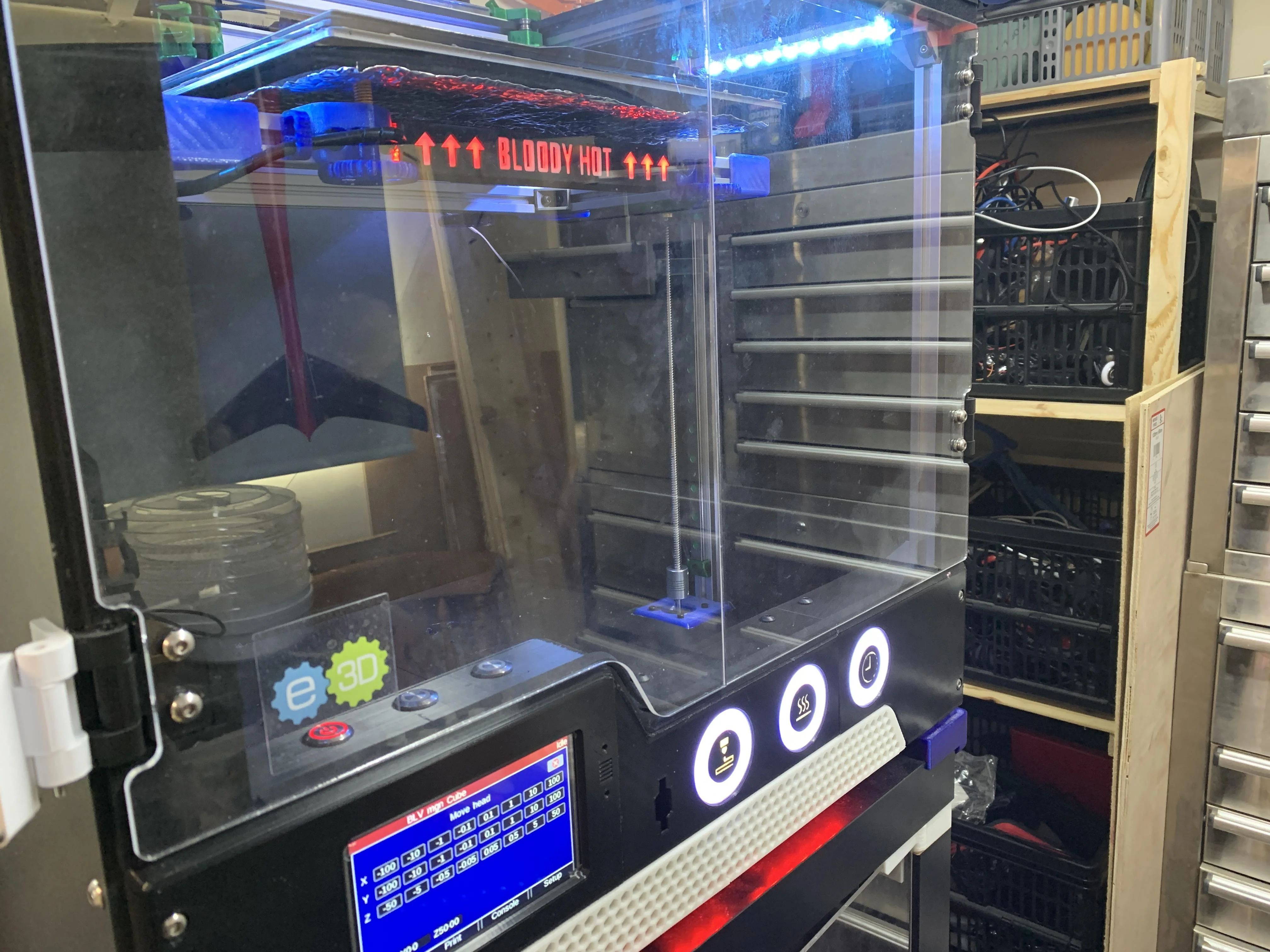

And my ground-up build of a BLV MGN Cube with many modifications of my own design.
Custom enclosure designed by me.
Paneldue 5" (genuine)
Creality CR10 heatbed
HiWin MGN12H rails for all axis
0.9 degree steppers for X/Y
Inductive probe
Optical endstops
Dual PSUs (24V and 12V+5V)
Neopixel rings that indicate bed temperature, hotend temperature, and printer status.
320x310x365 build volume
I've censored what the hot end says. You can guess though.
All machines are on their own Tasmota smart switches so I can control power from OctoPi or kill power in the event of a fault.
@Rilot that is epic! Love the attention to detail in all the wiring and setup! And here is me having nightmares levelling a bed :D
@Rilot Very neat....and yet it still looks maintainable! I recognise the 3-lever (and 5-lever) Wago blocks and I can find that there is a DIN rail holder for those that looks nothing like yours. Presumably you've 3D printed yours so they're at an angle rather than pointing straight up in the air?
There are a multitude of Wago products that fit onto DIN rails (like 216 pages of them!). So I'd be curious to know what model those are if you wouldn't mind sharing?
Also, what are the smaller terminals that you're using for your stepper lines?
Presumably that's a 24V PSU for the printer and a smaller 5V PSU for the Pi or 12V for fans?
Not that I'm trying to do much the same* thing you understand! :D
*same but shoehorning into a much smaller box and with significantly lower standards as a result!
