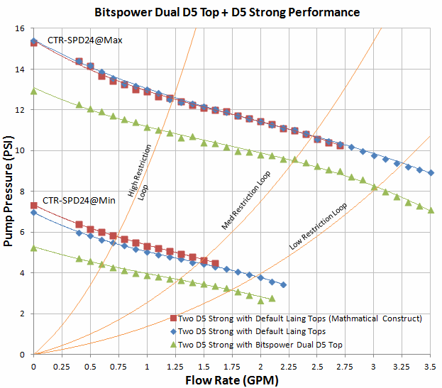

This is true nearly all (Bitspower's D5 top actually lowers performance) aftermarket tops. You need to make that distinction between tops and pumps for clarity.
Really? I haven't heard of that before, what tops is that compared to?
Stock.
If you have ever looked at the volute of a BP D5 top then its clear to see why.
Very quiet and nice to look at tho.
This is a test of the old dual top which has the same volute structure,it gets handily nobbled by a couple of stock Laing tops.
