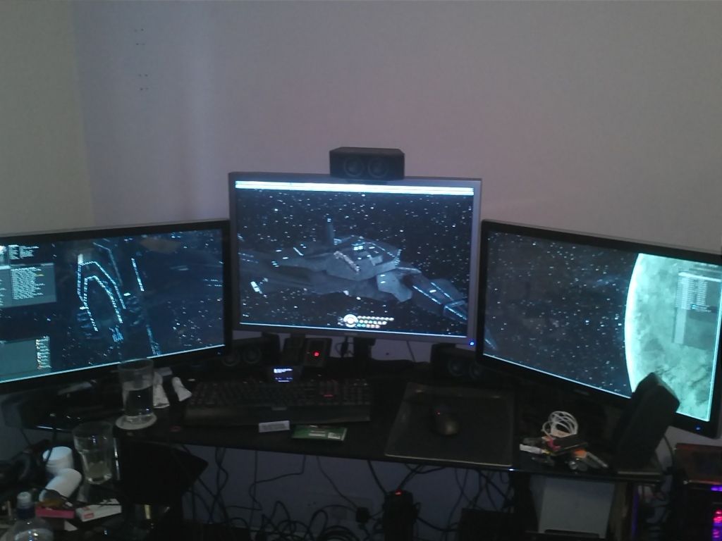

Its not weird having a 27"///30"///27" - Its actually really nice, although I am debating selling the 30 and getting a 3rd 27 in order to enable proper surround and not having to use windows.
You are correct in that I am not limited by GPU power, If I run eve across all three screens I am happily getting loads of FPS at all times, sitting at 14xxMB VRAM used at max. If I put 2xAA on I sit at 1536MB VRAM used and get 2-5 fps. This is because on the 480s there is only 1.5gb VRAM.
If I am going to shell out £1500 (including blocks and stuff) for new cards, I dont want to only upgrade by 500mb so that the next game that comes along hits a VRAM limit, I would much rather get the 4gb versions and be set for a couple of years :)
Pic below is my setup as it is right now, except for me raising the side monitors via boxes
