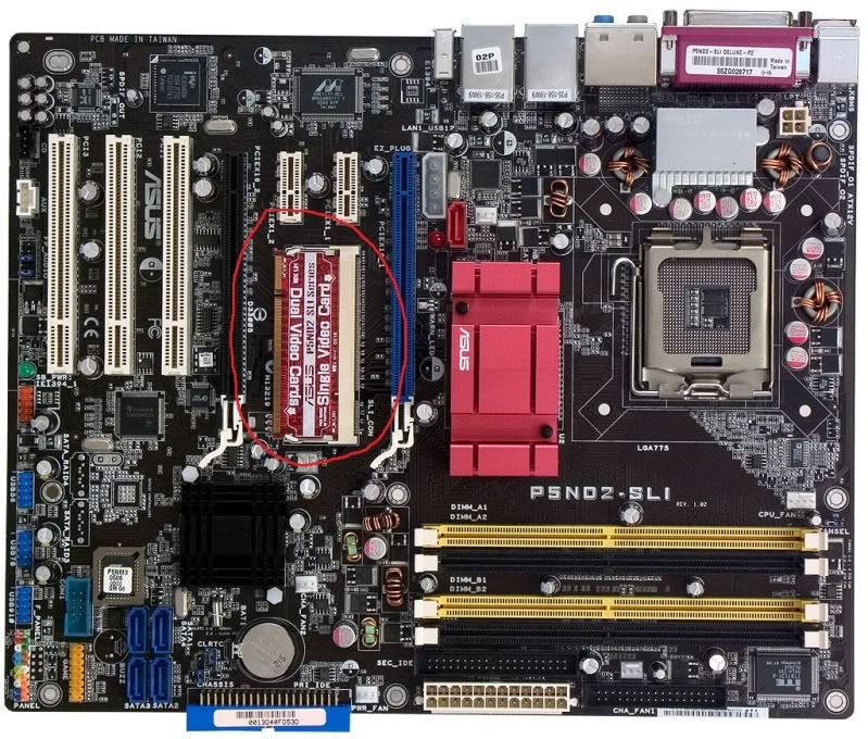

On that board theres a small card that has to be inserted a particular way to ensure sli is enabled.
Circled in red below.
But as mentioned, that system will struggle to run any modern game.
The card is plugged in correctly (Dual video cards) but still is only running one graphics card and not using the other one at all, I mean i understand its asking a bit much to play Skyrim, but the computer struggles to run Runescape. My friend has an 8 year old computer with worse specs than this (Just a better gcard) and he can run wow in 60fps. It just has me baffled.
