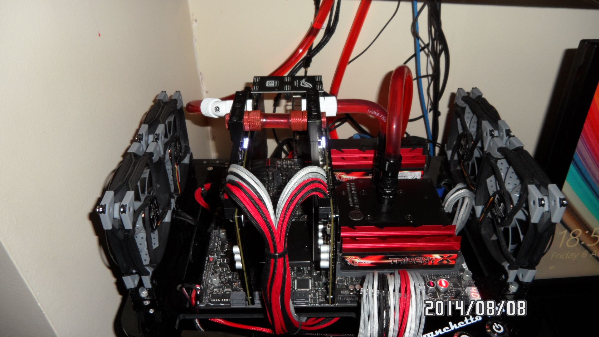

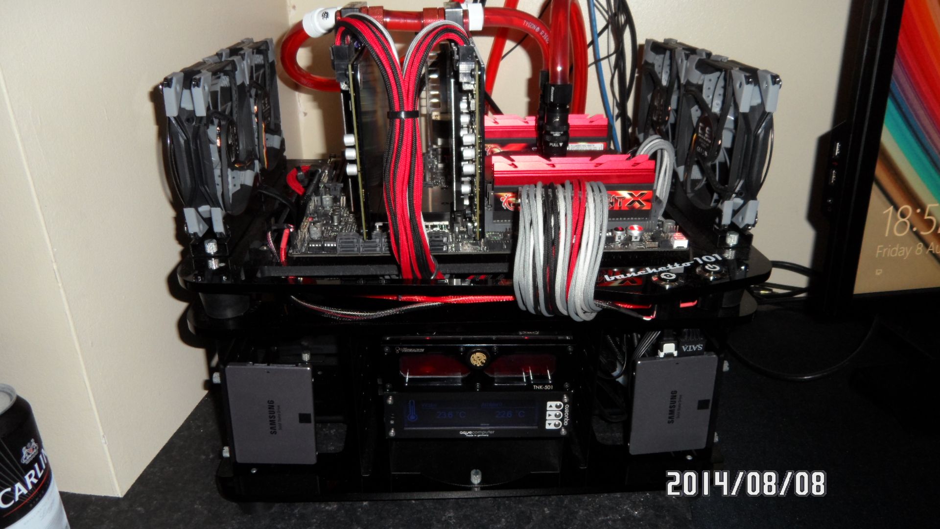

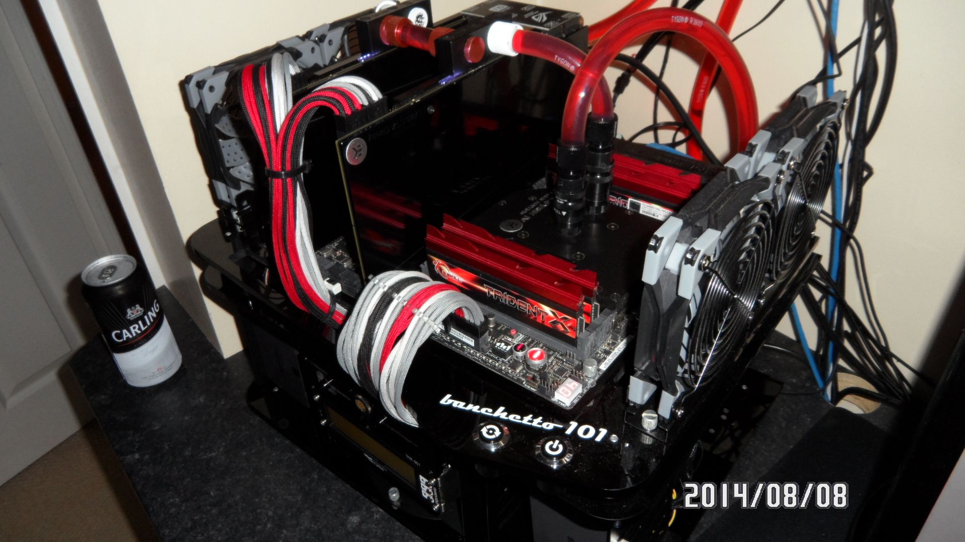

Nah got 2x DDC pwm's and they go like a rocket!!! :D THESE
Only got 2 white BP fittings and its got to look right!! Got plenty of red ones may try different combo's and see what looks best.

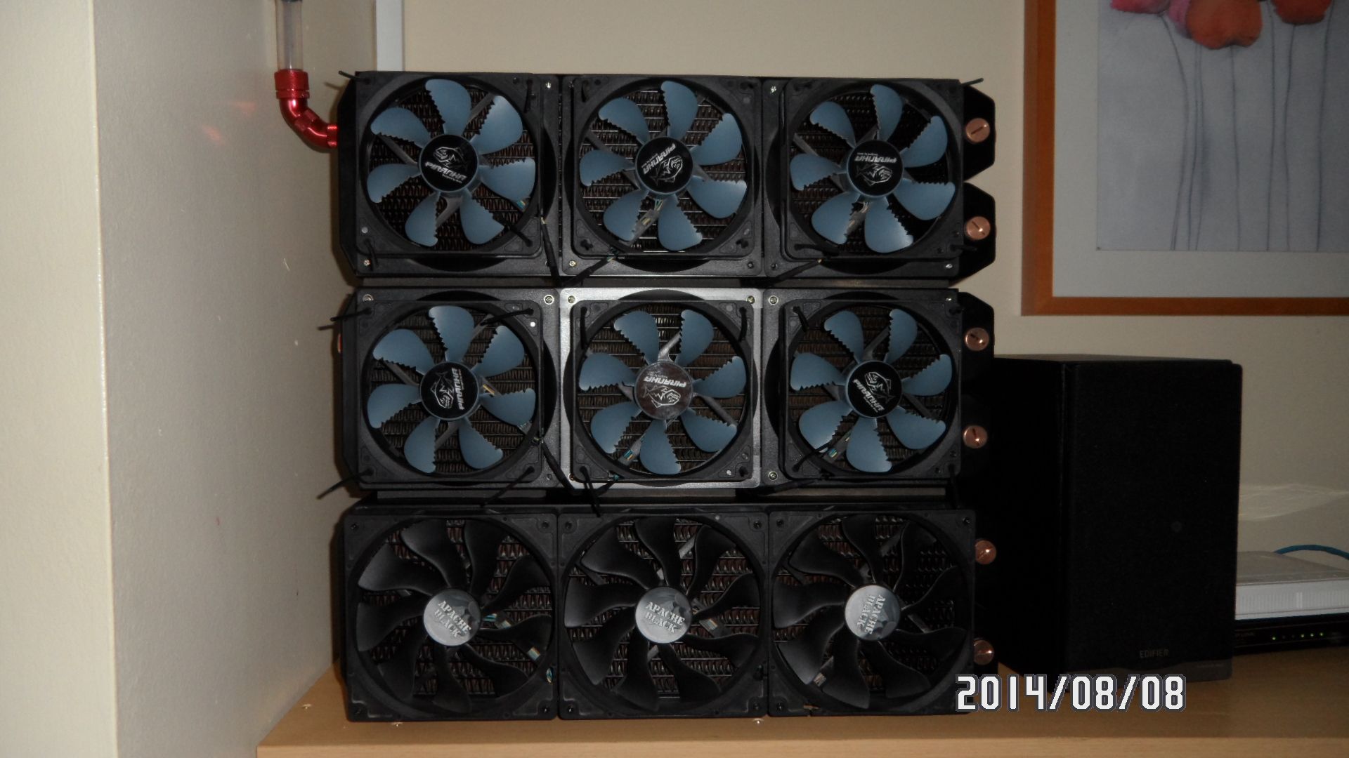

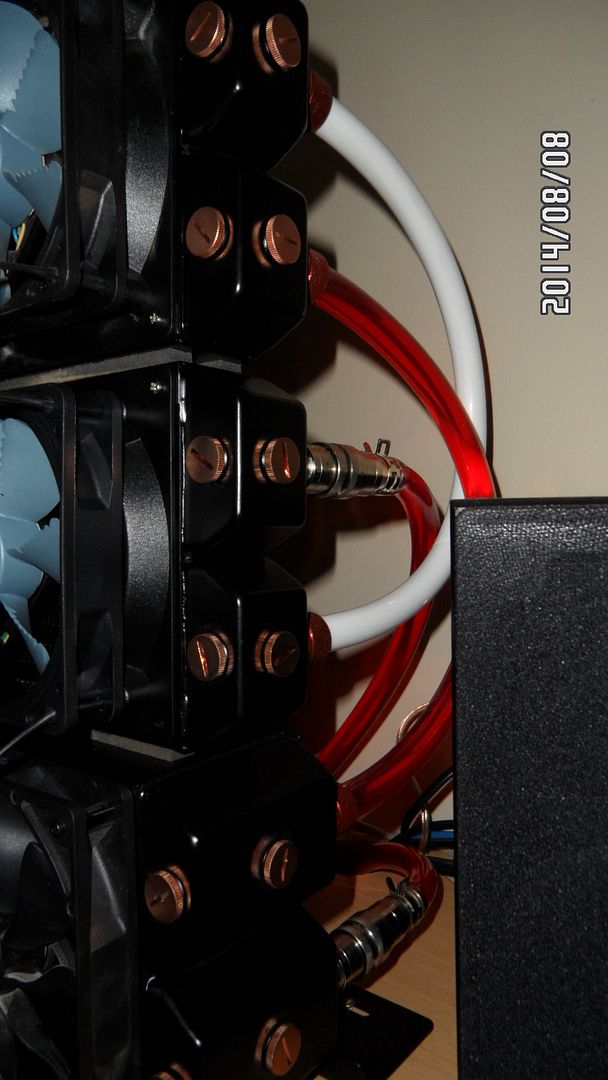

I have 3x 420 rads on there side stacked on top of each other going in this order,
1. (Bottom) In
2. (Middle) out
3. (Top) looped
Done it this way as I'm running out of long lengths of tube and also linking like this produces shallower arc's, so no kinks between rad ports. Have also fitted a bleed/fill port which extends above the top rad.

Not 100% sure on what you mean with the rads, if you could take a picture or sketch what you are trying to do that would help.

As for rads normally you expect them to go in order, I.e
1(in)>2>3(out)
But mine go 1(in)>3>2(out) for the reasons explained above.
On phone(work) at mo so can't do pic or sketch but if this rain keeps up I can go home and finish my build! :D
