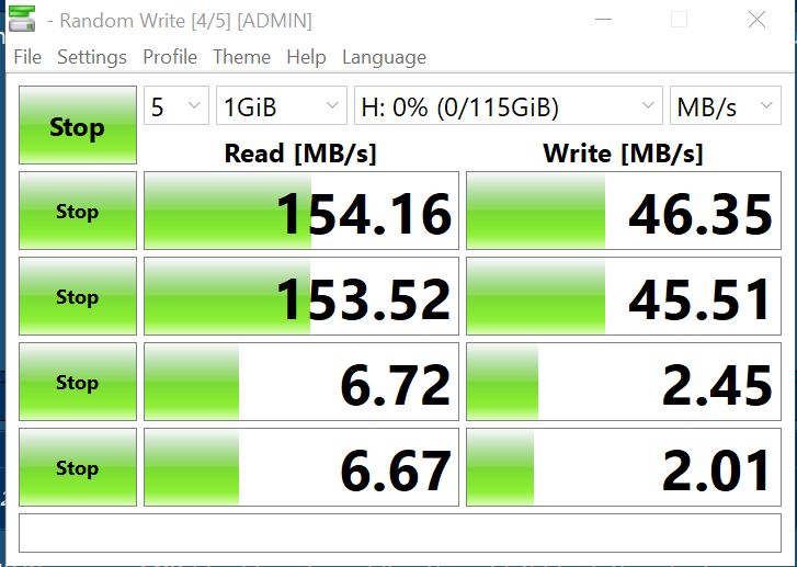

Yeah, I've just tested to a USB 3.0 pen drive and that's around 38-45MB/S using a 6GB film file... I would've thought I'd be hitting higher speeds myself, but that's USB for you
infact run Crystal DiskMark 7 on it mate and see what it says... so my USB pen drive is hitting the following but when in the real world I was trasnfering that 6GB file now, I maxed at 45MB/s
