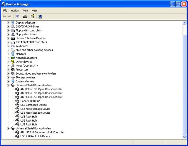

What does it say in device manager?
Hi, this is what my device manager looks like now.
When I look into the properties of the ALi USB 2.0 enhanced host controller it says that the device is working properly.
I think you just helped me solve my problem. I just updated the drivers of the host controller and now my USB speeds are much faster. Thanks
