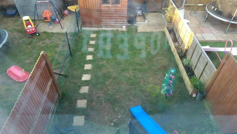

The house is only 5 years old, so the ground is full of hardcore and general building site mess, the mud is very clay like, and the lawn is infested with leather jackets - the larva of the crane fly. We've battled with the lawn and treated it the last two years now, we can't keep up with it. It doesn't help that the house end of the garden doesn't get much sun.
This is what it looked like before I started. You can see how patchy and muddy the grass is.
Note the neighbour's fresh garden, they had it professionally done last year.

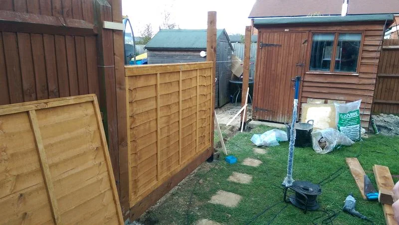

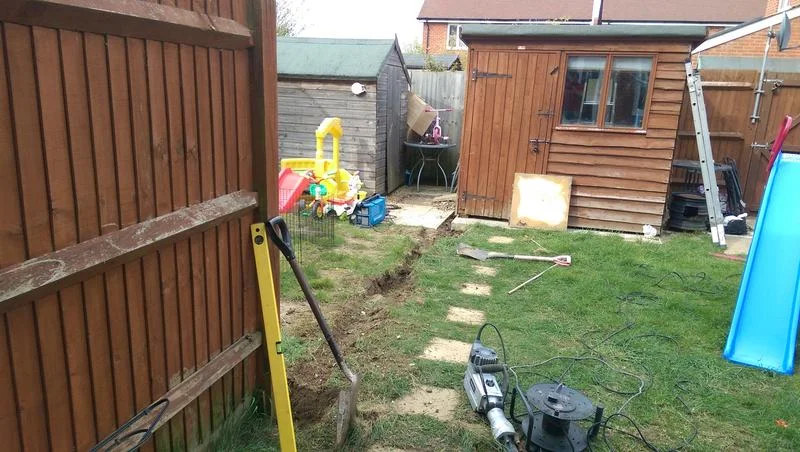

Wire fence down & steel posts removed

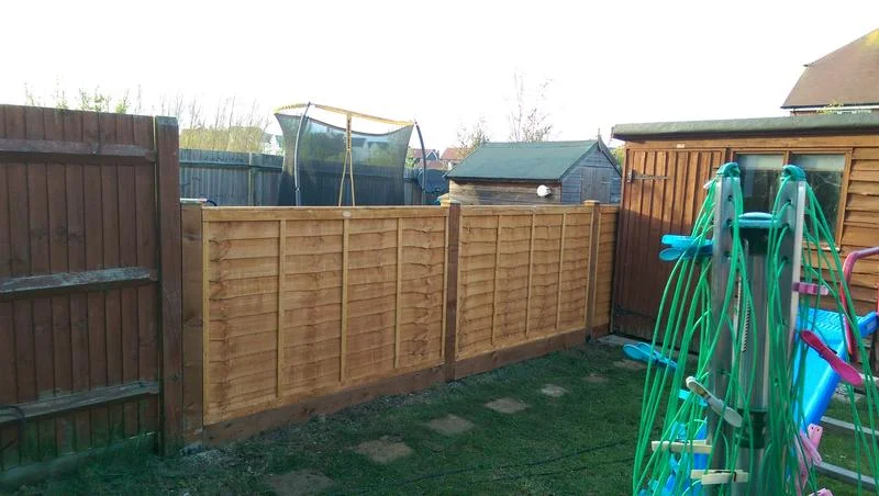

All posts in, first panel in
Fence done - not bad for first attempt

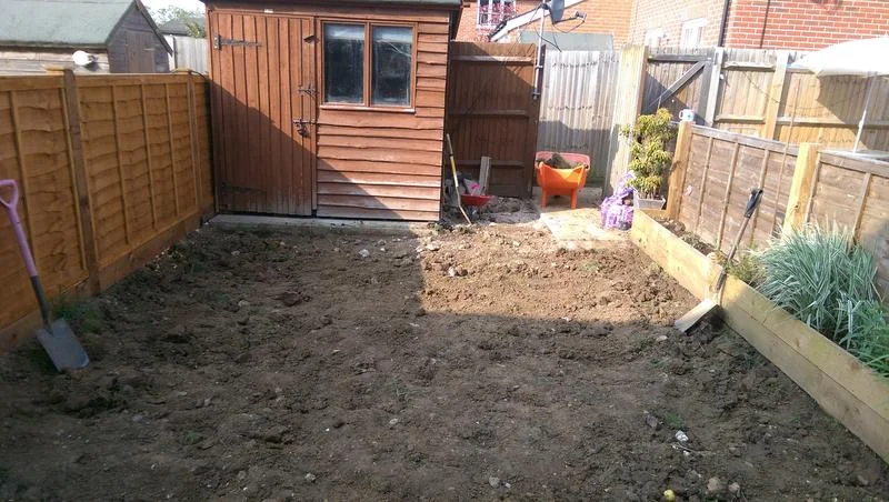

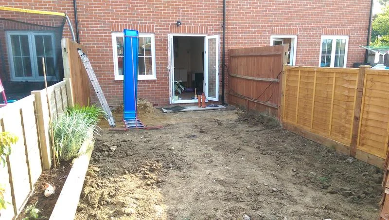

General garden mess and kids toys moved, all slabs lifted & turf removed. Everything had to be wheel barrowed 30m to the trailer for disposal.

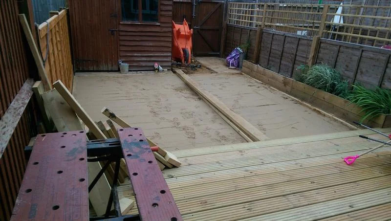

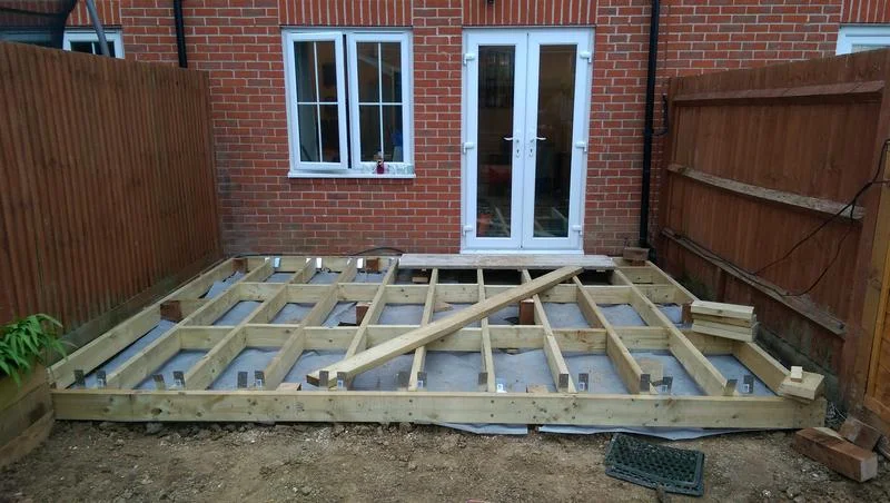

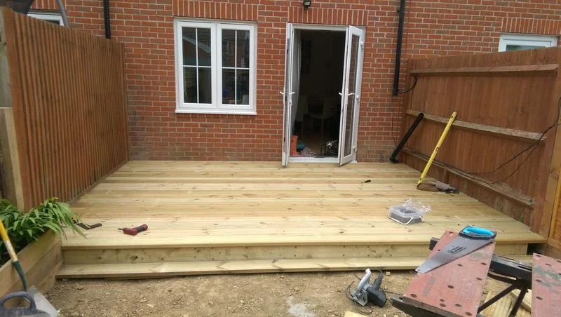

I built a deck on the house end so we'd have a decent area to use when wet.
The frame was built 3.1m x 4m using 150mm x 47mm treated joists
Its suspended above ground on 12 posts

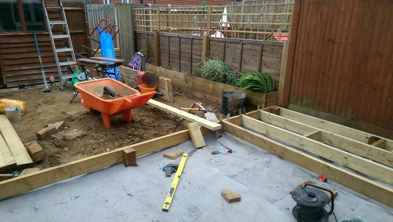

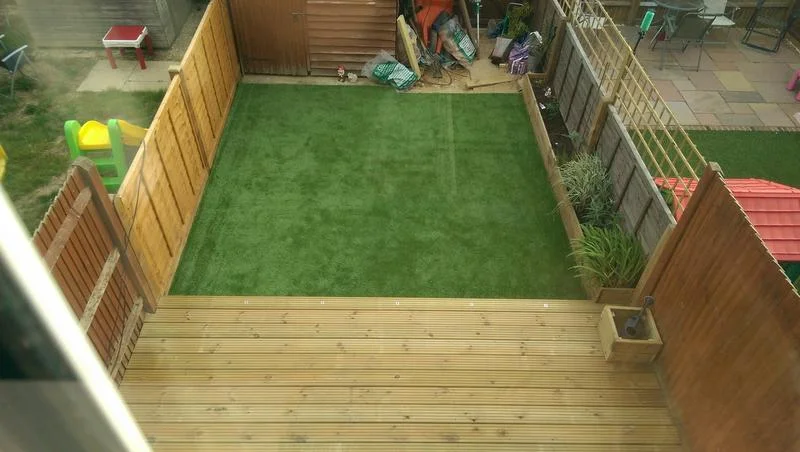

I laid artificial grass to the end of the garden, so prepped the ground. We levelled it and built a perimeter frame. The frame was staked into the ground and levelled. We filled the inside of the frame with a bulk bag of type 1 and compacted it. Followed by a bulk bag of sharp/grit sand. I had to buy an additional 200kg of sand as ran out. Complete base is 50mm deep.

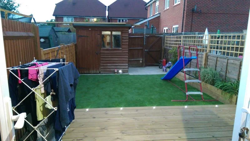

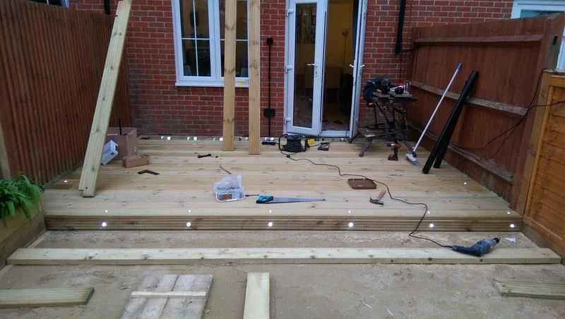

Deck lights fitted and tested
Grass laid out, and roughly cut to size. The grass included a weed membrane, so no need to lay one separately.

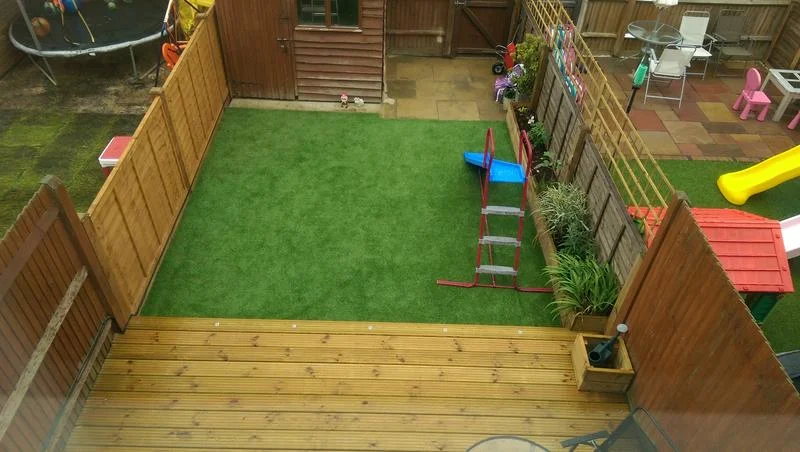

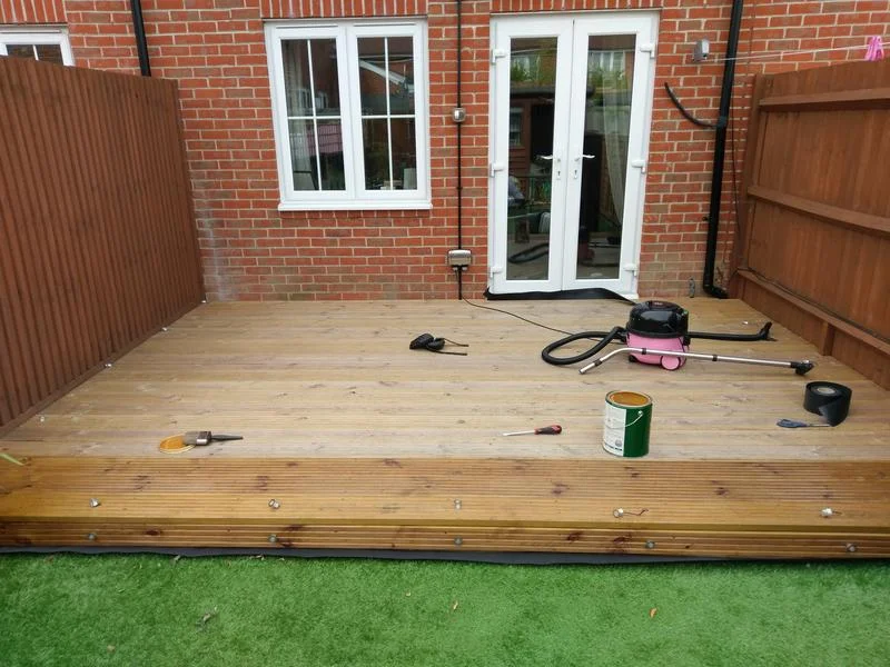

This is where I'm up to now. The sky cables clipped to the fence, and the water butt plumbed back in (out of shot). The grass has been cut to size and screwed into the frame work.
Just need to oil the deck and paint the fences & shed again. I now need to save up and get some furniture so we can enjoy it before the summer has gone again.
I'm well impressed with how it turned out. My first attempt at it all with basic tools. Had a good friend help me out, would have been almost impossible on my own, especially trying to hold and cut 4.8m lengths of wood
Wow nice work! If I had one small criticism its thats the fence panels that you installed dont match with the existing fence that was already there on that side.

I did worry about the fence, but it also doesn't match on the right hand side either.

This was £15 sqm, so midway price wise. (I was looking between £5 and £30). I originally wanted one that had some brown in it as it looked more real, but the the Mrs wanted this one. It does look nice in person though.

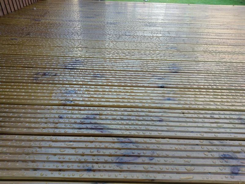

Small update, finally had a week of dry weather, and enough time to oil the deck.
Was a tad tricky, had to do it in stages. The second coat needed to be done within about half hour of the first. And couldn't walk on it. Made it interesting by the door.
The oil really brings out the grain of the wood, and beads up very well.
Once I can walk on it tomorrow, I'll grab some more pics
