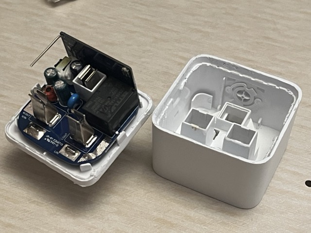

Following. They pop up on HUKD frequently and there are all manner of opinions, apparently they all fail all the time every day for your whole life because the relays get stuck.
Or something.

Lol:
Something tells me the HUKD's word of the month is relay :D
