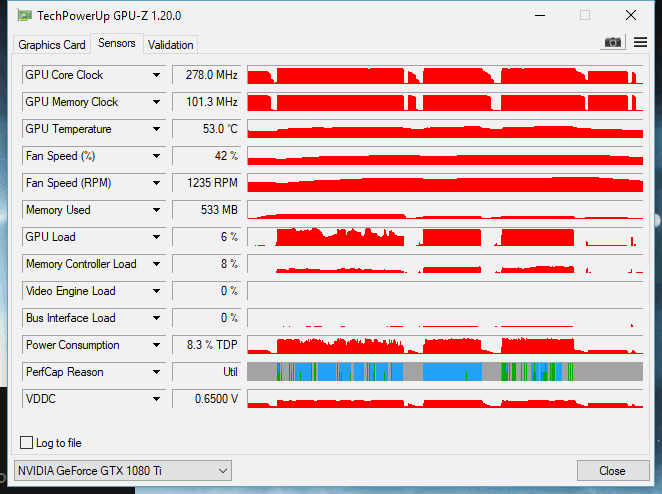

Here are some graphs of my system which may or may not be useful. The only thing that sticks out to be is the GPU usage isn't maxed out. I saw the same stats through the Aorus monitoring utility.
This is during Overwatch:
This is Witcher 3:
Here are some more graphs that shows GPU load being quite low and erratic while playing various games.
Witcher 3 (suffering constantly bad FPS, with some severe drops to 20FPS):
BF1:
Overwatch:
3D Mark Time Spy is the only exception:

Finally found the issue, which is a little embarrassing! Turns out my memory was not in dual channel configuration. :o I must have misinterpreted the manual and put them in the wrong slots. As soon as I corrected this, the benchmark tests I've run have improved significantly.
Somehow this didn't have a noticeable affect since building this machine in November, until I upgraded to a 1080 Ti recently, where I suppose the bottleneck shifts away from my graphics card in some situations.

Unfortunately, despite what I had posted previously, the problem was not resolved :(
The RAM not being in dual-channel configuration did cause an issue with the CPU benchmarks (e.g. Cinebench), but didn't improve my gaming performance. GPU usage was not anywhere near maximum, CPU usage was generally high, but FPS was generally than expected and would keep dropping significantly or stuttering
For example in Overwatch, my FPS was around 80-100, and constantly dropping to 20-40 or stuttering, which made for an unplayable experience. Dropping from Ultra settings to High had absolutely no impact.
I couldn't figure it out, so decided to just reinstall Windows 10. Somehow this has resolved whatever issue I had. To be sure, I fired up Overwatch on Ultra, and my FPS did not dip below 144 for the whole game!
