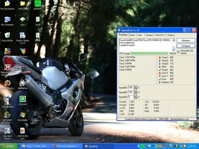

Ive just built my self a system and ive downloaded speedfan and the rest but, what i want to know is are the figures correct on it? and is my comp running the right temps?

Speed fan idle....
Speed fan little bit of work...
Speed fan a lot of work...
and last speedfan while gaming...
what i want to know is why are the the two cores at different temps? is that normal?
also the core is the prossesor on the graphics card it says, does the grapics card have a temp sensor on it? and should it be that hot?
and also if some thing is wrong, what temps should i be running and how to i amend things?

I would say the "core" temp is the graphics cards temperature, and the core 1 and core 0 are the CPU and they look fine, mine don't always have the same temperature and are sometimes a few degress apart.
I would use a different program to monitor temps, such as this free everest ultimate trial:
http://www.softpedia.com/get/System/System-Info/EVEREST-Ultimate-Edition.shtml
It tells you exactly what each sensor is, such as CPU, Core 1 / 2, GPU (graphics card) and hard drive temps. Download everest and take a screenshot of the results in that instead.
