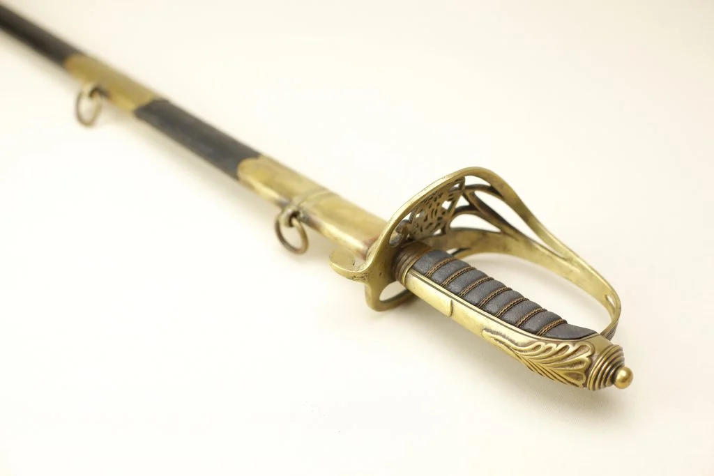

I've started doing some 'proper' photos of my wares (antique weaponry) and, while I'm finding photographing the hilts easy with nice results, I am struggling to get shots of the full item to come as out crisply. I'm using a Canon 5d Mark II with a 50mm 1:1.4 Canon prime lens and the cheapest lights imaginable.
I find that having an F-stop high to ensure the whole sword is in focus (they average at a metre long) means I have to raise the ISO a lot and this leaves the image grainy:
Should I be switching to a different sort of lens for the wide shots? Or is the issue my lighting? I'm very new to photography and I don't know much so thanks for any help.

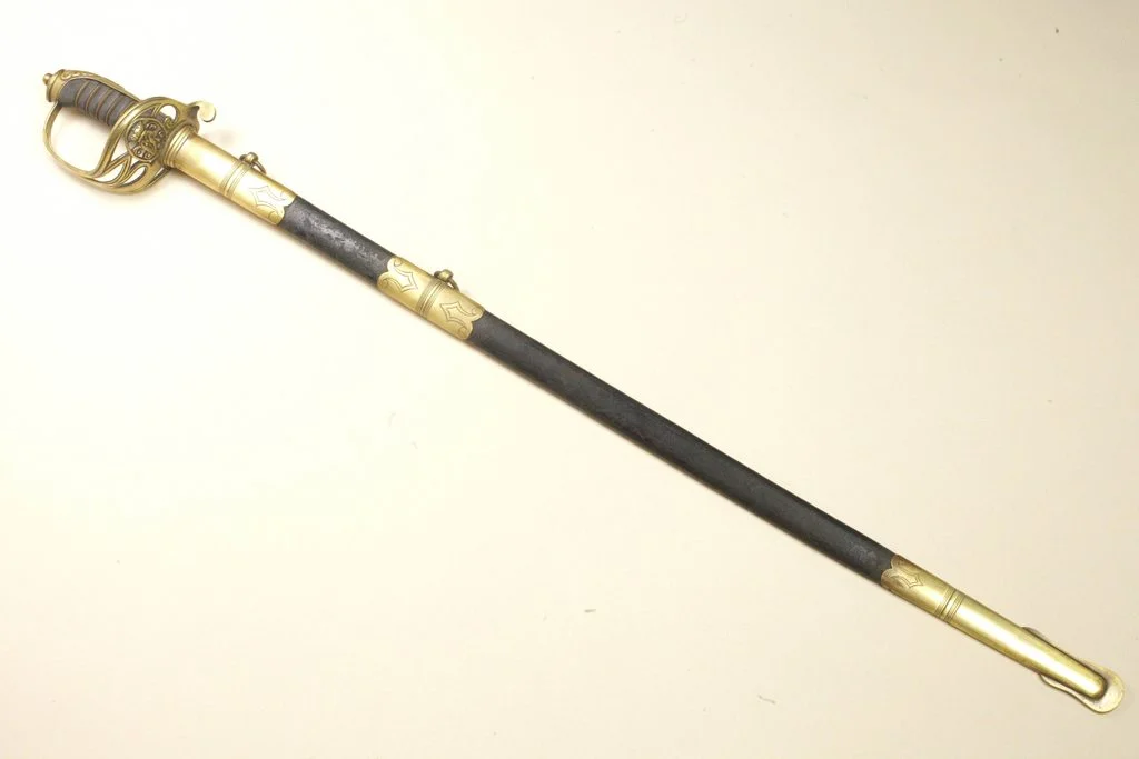

I suppose the other option is to stop putting the swords at an angle and instead put them directly perpendicular to the camera like this one I did (unedited), then I can still use a smaller F-stop:

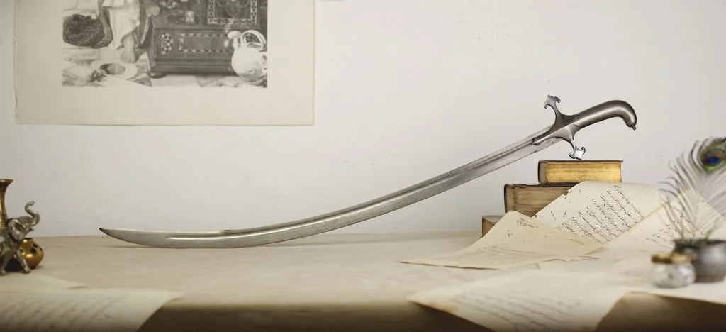

The above covers the points well. The only thing I'll add is thinking about the composure of your shots. Take for example the 1st picture. If all that sword was in focus, it'd be a ruddy boring image. The depth of field you have in that 1st shot actually works really well in drawing the eye to detail of the hilt and handle. You just wouldn't get that when its all in focus.
The shots where the sword is side on rest on the book is great having the whole sword in focus and its in a nice setting, but as an overall image, it feels a little flat and too similarly lit. You need to draw the eye into the object, make it stand out against whats around it. There is a shed load of youtube videos on still life / product photography which might help you out.
