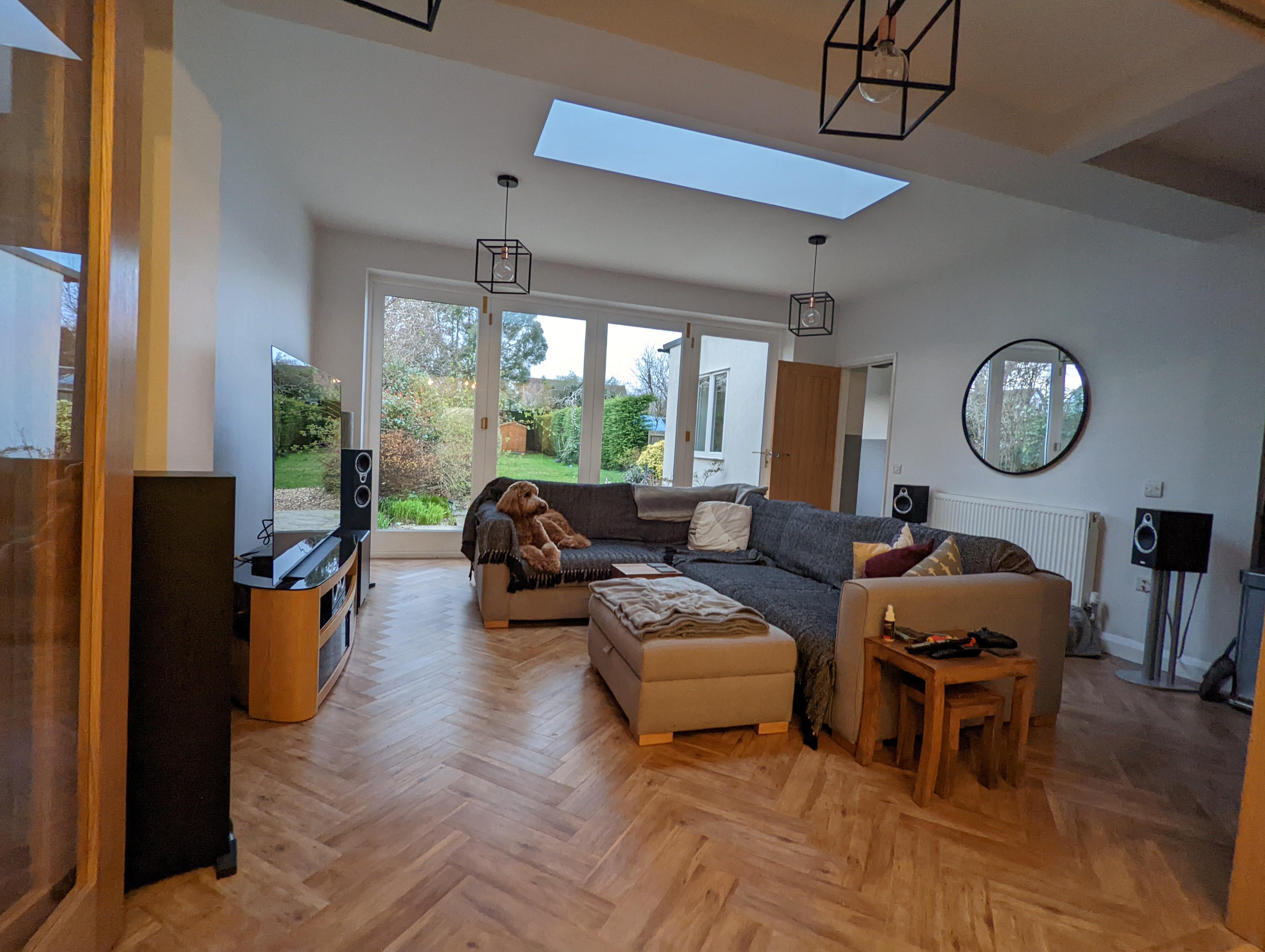

I use DCSK (German made, maybe even same factory as KabelDirekt) 4mm² pure copper on my main speakers, was an improvement over 2.5mm² pure copper I used previous. Thicker speaker cable has less resistance.
BTW your front speakers probably need moving away from the wall more, but otherwise very nice setup.
