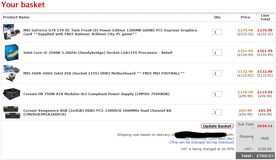

Hey,
The other day I posted a thread asking for suggestions on upgrades to my current system, it turns out I'd need to spend quite a bit more than I wanted to really notice a difference so I've upped my budget - I'll have to sell a few gadgets but hey-ho. Can you lot please check my proposed spec and, if required, suggest changes please?
I'll be using some of my existing kit, namely:
Cooler: Corsair H50-1 w/ 2x 120mm Akasa Vipers (if it already has the correct CPU mount, anyone know where I can get a Socket 1155 if not?)
SSD: Intel 120GB X25-M
HDD: 500GB Seagate Constellation 2.5"
Sound Card: Creative X-Fi Xtreme Music (PCI)

I don't plan on adding another GPU any time soon, I've got a Corsair HX520 at the moment - are the Antec New Modular PSU's any good? Specifically the 750W version!

i would agree with stulid and Surveyor about the Gen£ board and Ram.
also, you could hold off on a new PSU, as the one you currently have should be enough for a GTX570.

I was going to suggest that but general recommendations for a GTX 570 seem to be more in the 600W area.
Also the HX 520 could be a few years old now so may not be able to output the same power as when it was new.
The OP could give it a go and then buy another PSU if it doesn't work out.
Thanks for the great suggestions guys, how does this new spec look? Ideally I want to replace the PSU for future proofing, it's under £100 anyway so it's not a great issue :)
As always, suggestions and comments welcome!

Thanks for all the help guys, I've placed the order - should be here Tuesday and I hope to have it built before the weekend :)
