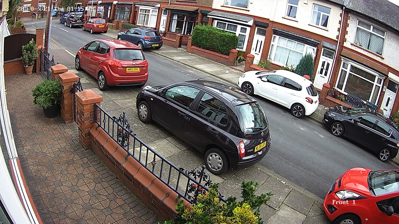

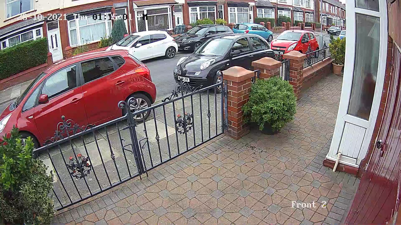

I appreciate that it only one factor with the cameras ability to capture images, some of the cars or people passing by being transverse to the camera, which does not help.
My two front cameras would view....
so Urban setting and general application of use. Some street lighting being available.

ColourVu would work well in that setting. I would suggest that probably a mix of 4mm 4mp ColorVu and 2.8mm 4mp ColorVu would would be best in that application as you are capturing a lot of street scene (which technically you shouldnt).
