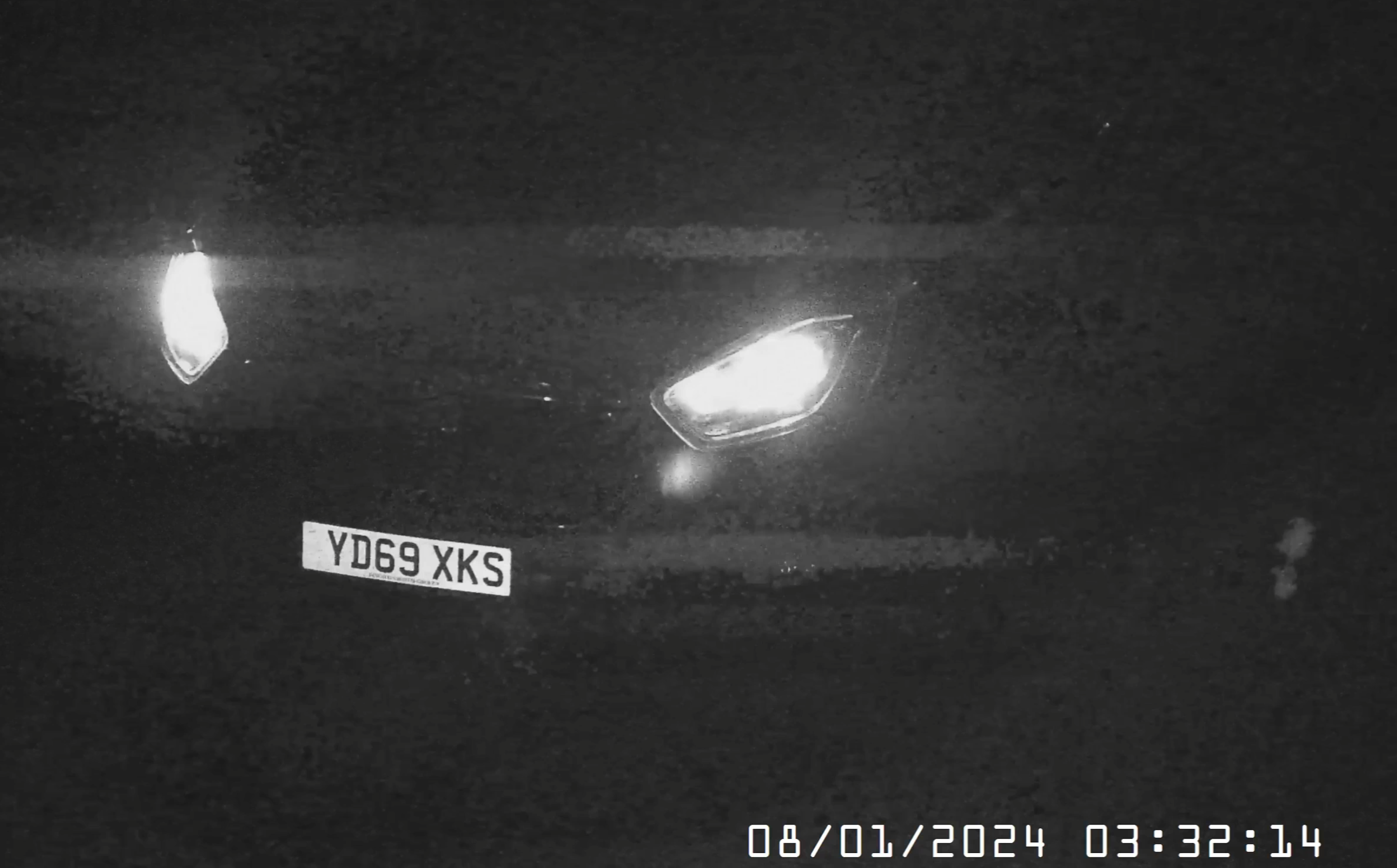

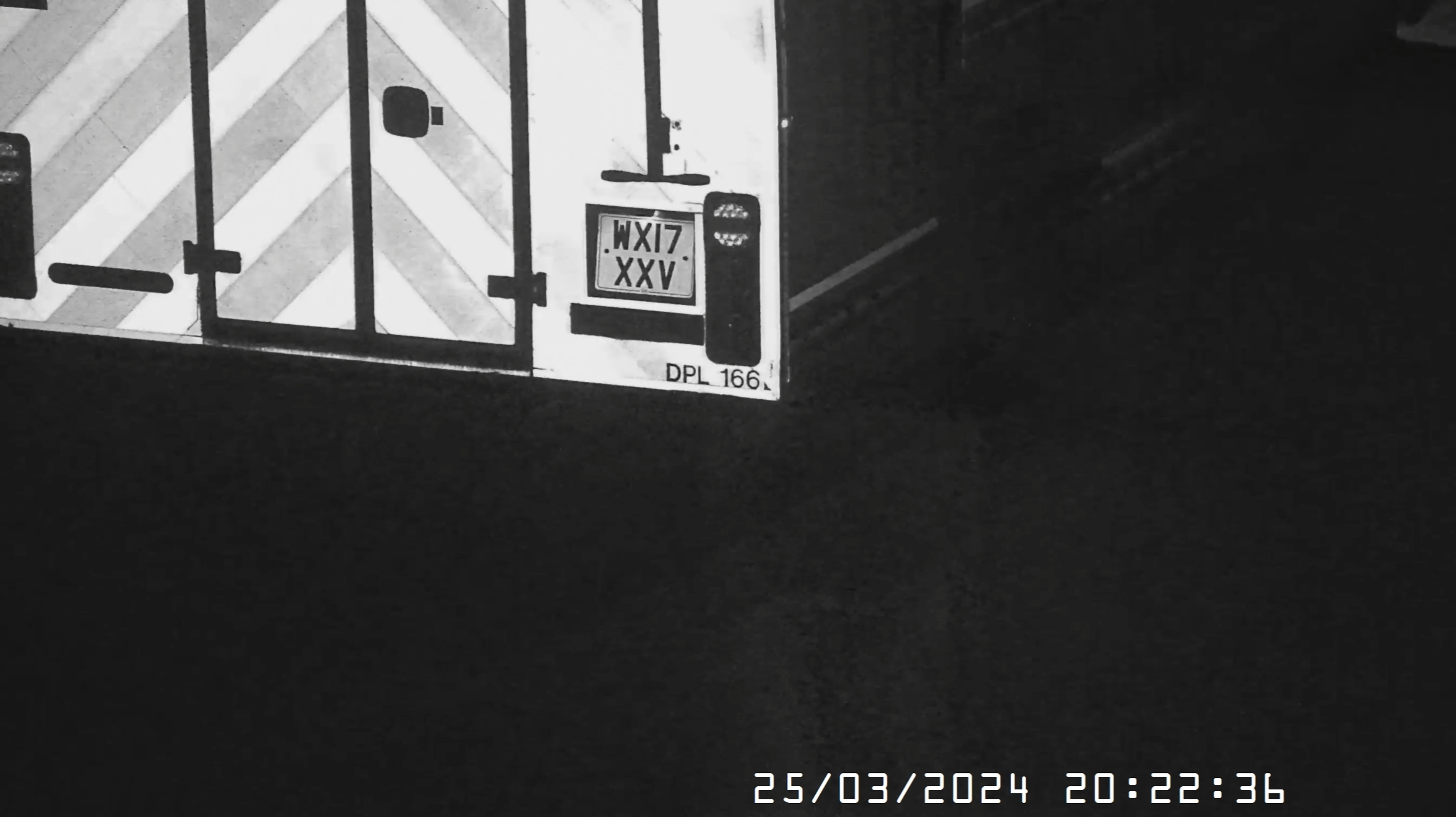

I got one of those as a dedicated licence plate cam. Set the exposure to very fast and the IR will light up the plate making it very clear.

I can't remember the exact model, saw it on same forums that the vendor you mention is popular.
That image is excellent, does it capture this as good when car is going at speed?
Yeah, it's only a 30mph street, but capture is still great.
Shutter speed is set to 1/10,000 (hence why the car itself is so dark), but haven't had a shot yet of a plate that isn't clear.
That speed works great in daylight, and great on the plates at night with IR near light set to 40/100 and far light disabled.

Not massively fast tbh, it's a residential street with a 30mph speed limit. At a frame rate of 25fps though, I think a vehicle would have to be travelling over 200mph to miss 1/25 second frame. over a distance of about 12ft in the picture (it is at full zoom). Even at 100mph I recon at 1/10,000s shutter speed a decent frame would still be captured.
