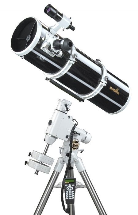

SkyWatcher Explorer-200P/1000 EQ5 Telescope

The 200p is supposedly a fantastic telescope. If you enjoy it, you can add any computer type gadgets later.
End up with something like this, which is top notch

I would direct you very far away from telescopes on EQ mounts, as imo they should only be used for imaging, far too much hassle for visual observing :)
For taking photos, you will need to be spending nearer £1000+
They don't look the easiest to travel with though. More of a garden scope.
Dobsonians are best for traveling, better than mounted scopes imo, because of the ease of their construction. The only problem may be the base is quite chunky, but all you do is take 2 bits out the car, plonk them on each other and you're done :)
If you go for an EQ mount I guess they're smaller overall, but with all the bits an bobs far more difficult
