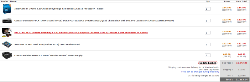

Not very good at these but here goes;
Money left over to pick your own case or even more memory if you need it.
No GPU included in the build - Because you would be better with Nvidias Quadro range or AMDs Fire Pro range if youre not gaming.
6 screens seems excessive though, you may even be better off with the likes of matrox and utilise their multi head kit to support your monitors if you NEED 6.
I cant see why you would ever need more than 3, I manage fine with 2 ;)

I'm pretty sure nVidia cards will only support up to 2 monitors each. In Sli you can have three plus a an accessory monitor. Or run 2 from each not in Sli. If you're going to use the CPU from my spec you will need to use the motherboard as well (or another 2011 board) as the other build uses the 1155 chipset.
What he said.
The only reason I specced an Ivy Bridge is that you're not really going to notice a real difference in performance between SBE and IB.
The CPU I specced is certainly no slouch, rendering tasks will be whipped through, especially if a simple OC is applied.
I just want to stress the importance of using a GPU that is built with workstation use in mind - Particularly Nvidia's CUDA cores, as they actively assist the CPU in render tasks. AFAIK, AMD dont do this yet.
