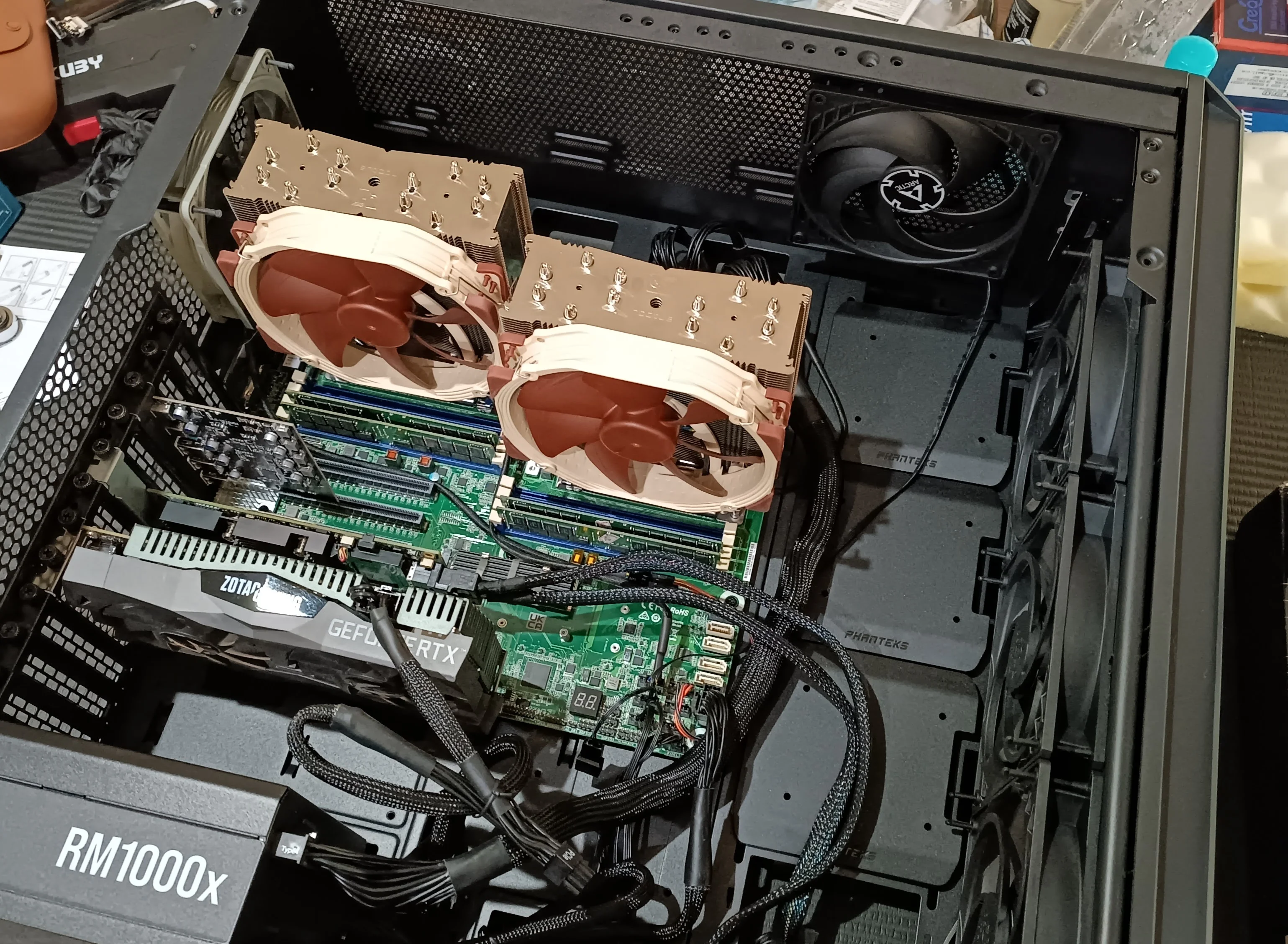

So "stage 1" report. When I decided to install the new board, I realized.. it was way too big for my current Fractal case. "E-ATX" means everything bigger than ATX really, and my "E-ATX" x99-ws ASUS is a 'baby' E-ATX, while the H11DSI board is the full 10x13" one.
Anyway, bought new case (from Overclocker's Amazon shop it seems, less than ONE day delivery time, amazing) Phanteks Full Tower (Server) and also a new PSU (Corsair 1000x) -- told myself since I'm not reusing the case, might as well build a new PC from scratch really...
So new board, new PC. Got 2 7282's EPYC CPUs in there and 128GB 2666 ECC ram. All working, but TBH I very much dislike that supermicro board; it's "primitive" and not very well thought out. So I've already ordered another board from ASRock; pretty much same thing but pcie 4.0 and compatible with Zen 3 EPYC so I have an upgrade path... Will report when this is up..
An update on this; I eventually flipped the supermicro board, and went for the fancier ASRock Rack ROME2D16 board. Also upgraded the EPYC 16 cores from 7282s' (these are pretty much 'entry level') to fancier Zen3 7343 -- 256GB DDR4 3200. Still have 8 spare ram slots to get to 512 later.
I also run a fancier Gen4 NVME for system disk, but I kept my SAS backplane Icydock (8*1.8TB 2.5" 12Gb/s disks as a raid6 array) + RAID card for my compilation farm work...
I kept the RTX2600 GPU, didn't make sense to crossgrade anything there.
Only 2 problems with this system:
+ USB is iffy. Some USB2 peripherals I used for years tend to part-crash the whole bus. I suspect the BMC
+ No support for suspend/hibernate. This is the most irritating problem, as the Asus board worked perfectly well and I had uptimes of many weeks!
But still, pretty screaming system with good room for growth so that should do me for 2 or 3 years before Upgradisis strikes again :-)
Having seen that some of the GPU have come down in price (quite a bit!) I've upgraded the 6GB RTX 2600 to a RTX 3060 (12GB) -- doesn't seem a lot of an upgrade, but it's Pcie Gen4, and twice the VRAM for doing LLM stuff; so for around ~200 (ex vat) that is definitely a good upgrade...
Also, after the thermal paste has settled, and some more heavy testing, the CPU never go over ~55C even at full blast with both CPU compiling stuff. That's pretty amazing really, and it opens up upgrade possibilities when the 240W EPYC come down in price... Currently way too expensive tho.
I'm eyeing second hand prices on 32GB sticks of ECC 3200 too... These 8 empty slots needs pluggin' :-)
So not much of an update, but I've finally found 32GB sticks at around the 40 quid mark (from china) so filled up the board now, 512GB. Also added a pcie audio card! Just to get an easy optical out to my DAC.
I got Hibernate working which is already something, I don't think suspend will ever work...
So here goes, that workstation will probably be upgrade to the 240W Zen 3 parts when they come down in price, but other than that, I don't see what I can upgrade at this point lol!
